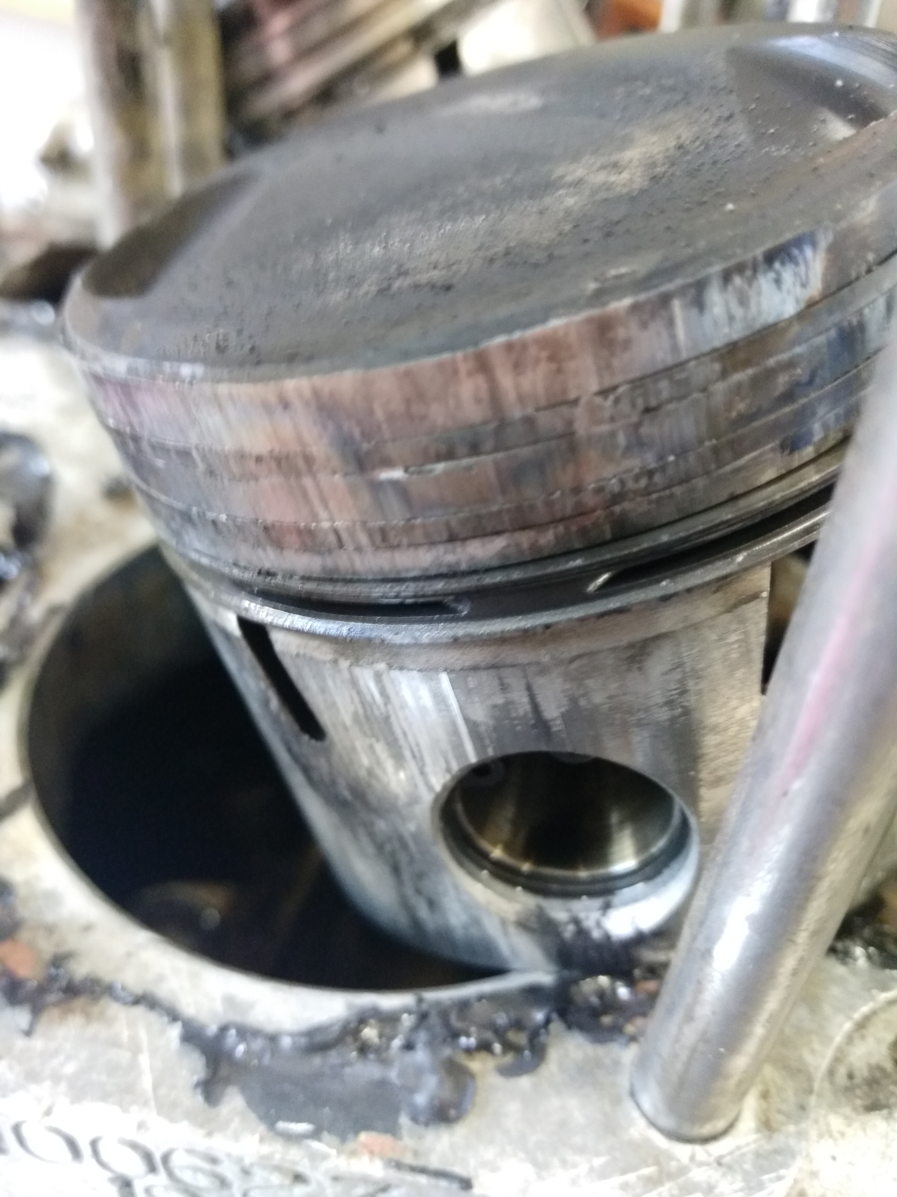

Bad News: Another seized piston! This time the left one. I was doing 60mph when the engine sounded stressed and I pulled the clutch.
damaged piston
There is a cylinder liner in the barrel but on the right side. No damage on this side. I had the barrels rehoned after the engine seized the first time. so there should have benn a bit more clearance.The piston size is now 63mm+ 0,10. There are no other oversized pistons available as far as I know. Except one +0.20 piston on Ebay.
Will find out what to do after I spoke the the man in the engine shop.

I was at the engine shop today and showed the damage to the owner.
He suggested more piston clearance.
We are now at about +.20 because of the rehoned cylinders after the first seizure.

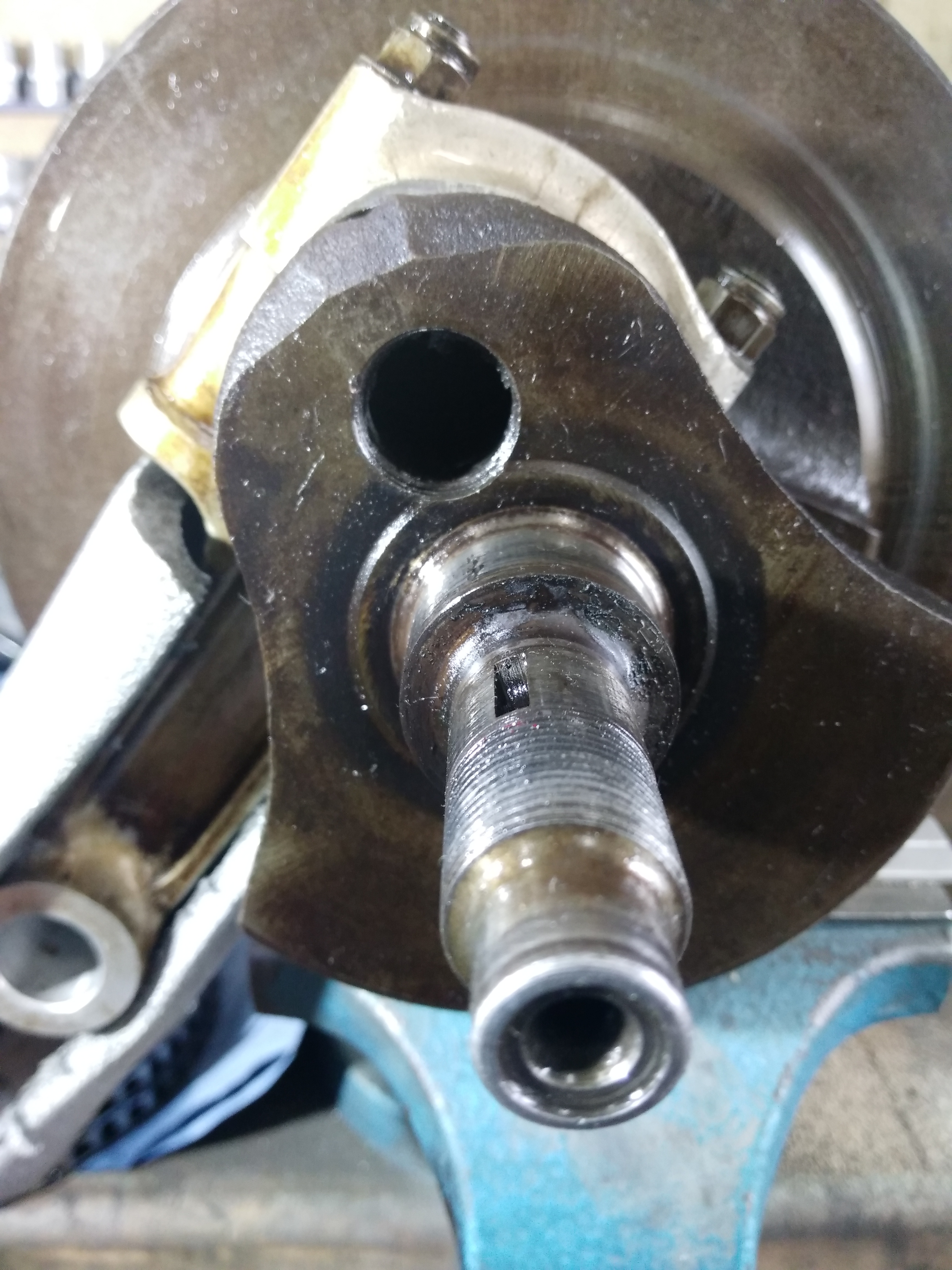

It is fairly common, after high mileage, for the sludge trap in the crankshaft to become so full of sludge that the left hand big end journal oil feeds get blocked. No oil is thrown onto the cylinder liner and the piston will seize.
If the piston that seized was on the left side, and you did not clean the sludge trap in your rebuild, this MAY be the answer.

Hello Ulrich, when you come to do this, I was amazed at how much hard sludge there was in the trap. I used a wire to chip it out, then pipe cleaners and parafin until there was no evidence of any sludge, I did have to take the crank out to do this though as I cleaned from the journals in. You may find your big end bearings are scored as well. Hope it wporks out for you.
Hi Ulrich,
I've done at least three different lightweight cranks. In all cases the aluminium cover screw on the end of the sludge trap refused to move with a broad screwdriver to the shallow slot. The slot is only of use to insert a new plug.
Grip the crankshaft in a large vice on the flywheel.
I drilled a 3mm hole through the centre of the plug. Then two more 3mm holes along the slot. The slot helps locate the drill. Then use a needle file to remove the bridge between the holes and insert a strong large flat bladed screwdriver. If is has a square shaft or a driving hole in the handle all the better. You may need a Mole-grip on the screwdriver shaft.
If that doesn't work, lengthen the slot until it is at the top of the threads, don't damage the threads of the crankshaft, and try again. Hopefully the cover screw will collapse inward a bit and lose it's grip on the crankshaft.
On a Jubilee, which has a smaller diameter screw cover to Nav/Electra, I had to resort to another pair of 3mm holes, like a number 5 on a dice, and make two slots, elongated to the threads. I was able to punch the four quarters of the mutilated screw inwards and to freedom.
Then I used the strong long screwdriver to chisel and remove the sludge. As Andrew says this will be compacted. Be brutal and ensure there are no pieces left inside. The sludge always collects more at the far end, the left end, where the oil flow is lowest.
If you have a parts washer, use it to thoroughly clean the oil passage from the timing side oil feed (end of crankshaft) to the sludge trap. Or an airline can be used. Bits of aluminium may have fallen in here from all the drilling and filing. A trick is to use a grease gun on the oil feed to fill the oil passage with grease before you start drilling the aluminium. Then, at the end, push in more grease to drive any swarf into the sludge trap where you can remove it. Then clean out the grease with paraffin and pipe cleaner. (or parts washer)
Clean, clean, clean.
Check your new cover screw fits. Apply a thread sealant and screw it fully home.
Norton secured the screw cover by deforming the thread after insertion.

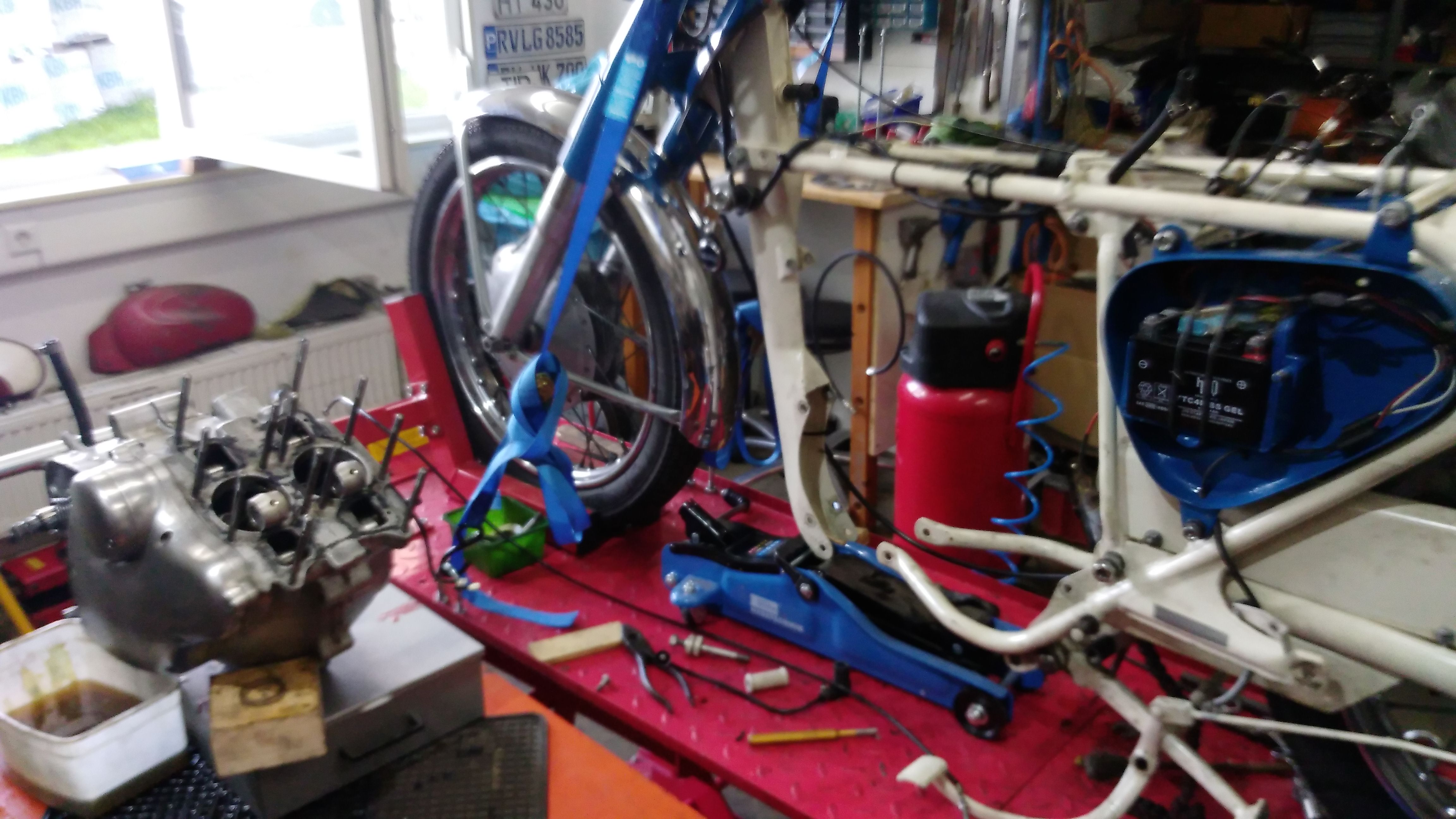

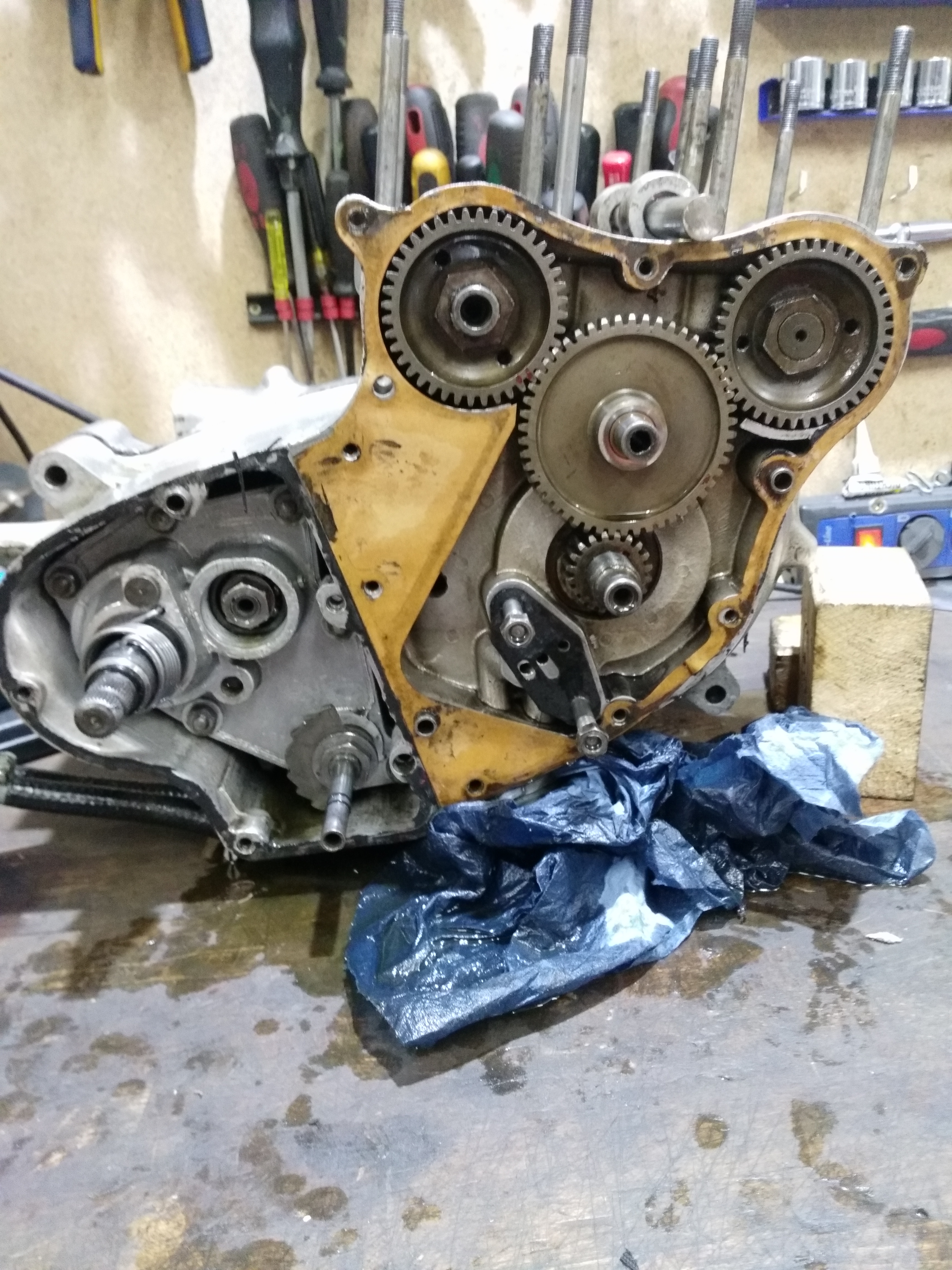

Today I started to pull the engine form my Navigator.
Navi sans engine

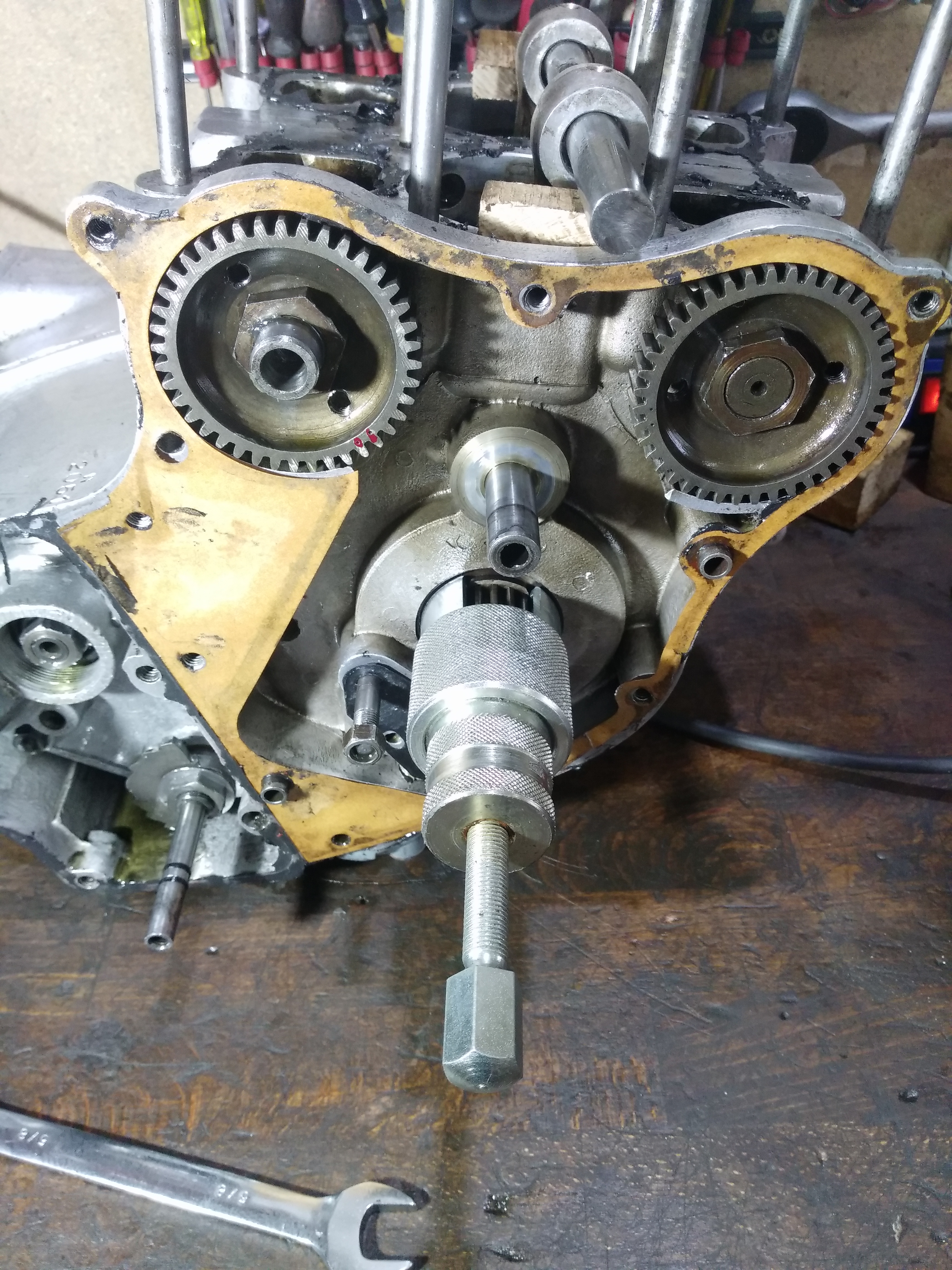

I came up to this stage. Are the nuts on the camshafts right- or left hand  thread?
Timing side
Ulrich,
The camshaft nuts are right hand thread. If you are going to clean the sludge trap.
Remove the intermediate pinion. Slides off.
Do not remove the camshaft nuts. Not required.
Remove crankshaft pinion on timing side. Special puller is good to get into space by 3-sided washer.
Remove primary drive cases and contents.
Remove all fastenings between the crankcase halves.
Separate the crankcases and the camshafts stay captive.
Probably more controlled if you drop the gearbox internals out before splitting the crankcases.
The crankshaft can now be removed. Sometimes the timing side bearing is tight on the crankshaft. Don't damage the timing side end detail on the crankshaft by hammering. This is important for a good oil feed seal. Use a tube to push on the shoulder at the top of the left hand thread if necessary.

Today I borrowed the three jar puller for the crankshaft half time pinion and took the engine apart. I left the camshafts in but noticed excessive play in the timing side bushes so the had to come out also.The nuts were very tight but in the end they loosened up and I could pull the pinions.

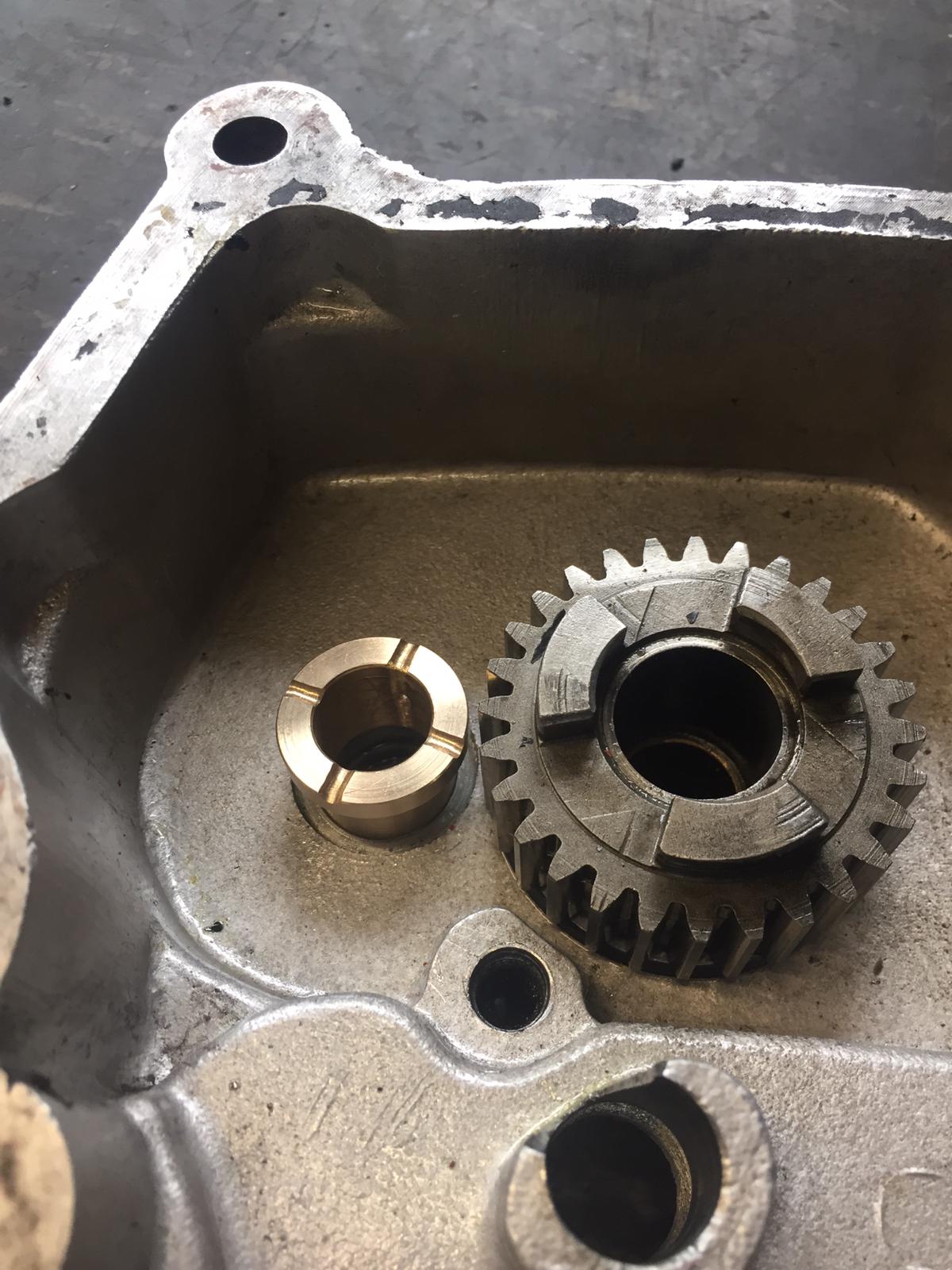

The gearbox was taken out as a cluster. I noticed a loose clutch operator lockring and also a loose bolt for the gearbox plunger. Also the layshaft bush fell out and it also has excessive play.

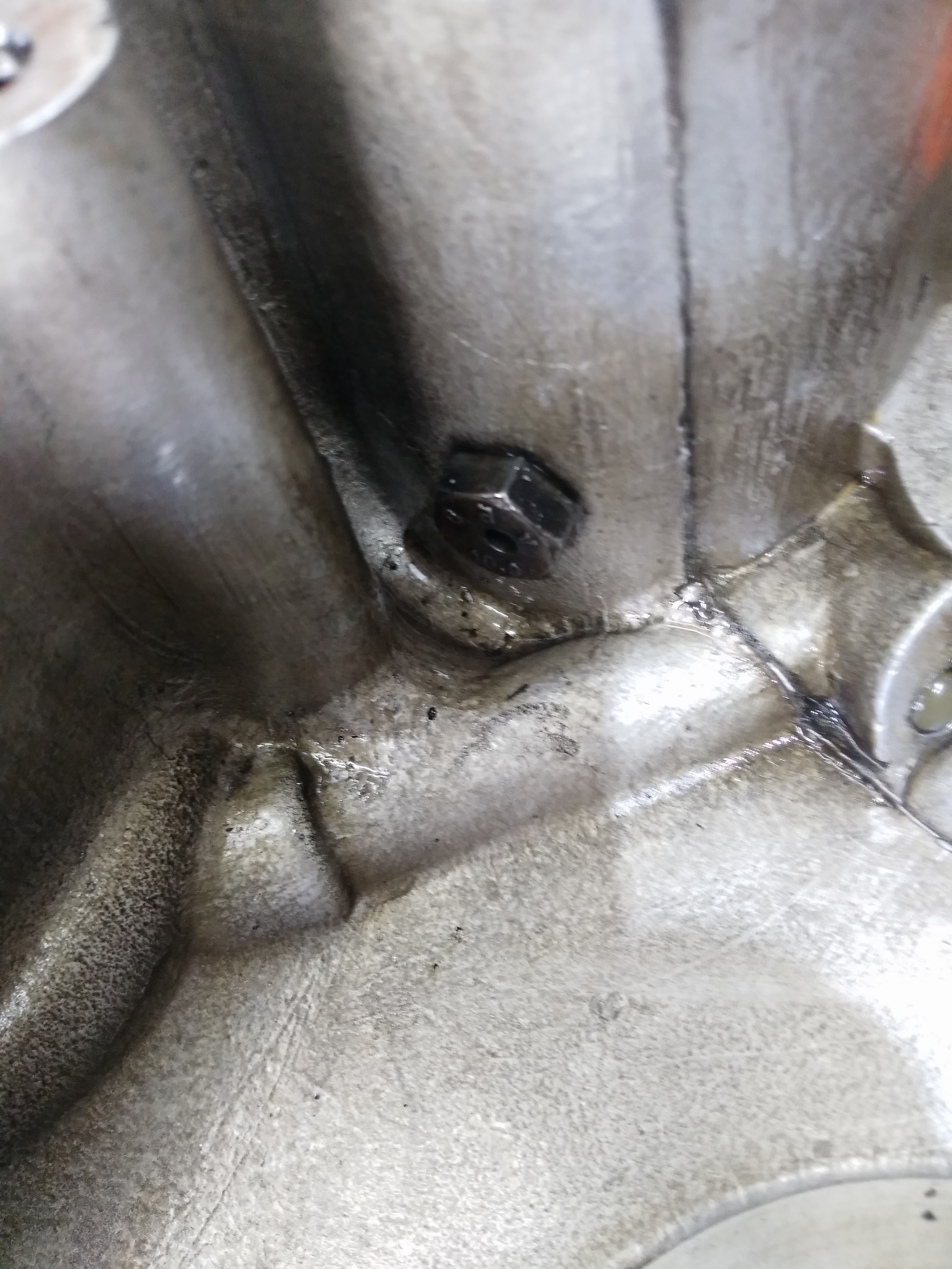

In the left side engine housing I found a bolt with a small hole acting as the crankcase breather. The part NO.23367 in the NOC shop crankcase breather surely looks different !
breather alias
The big ends also have too much play. The crank journals need a regrind and oversize shells. The sludge trap plug came out easily. Not much inside. I flushed it with my parts washer.
sludge trap
big end shells
Are the bushes for the camshafts available somewhere? Also the layshaft bush? Can´t find these in the NOC shop.
So in retrospective it was good to open the engine once more find all those faults
I guess it will take longer to get the Navigator back on the road!
Hi Ulrich - for the closed type (top hat shape) layshaft bush I could only find a stock at Norvil, don’t know about the other bush though, sorry. You could try Russell Motors as well, they’ve been closed for the last 3 months but had a courtesy phone call from them (after my parts request letter sent in April) last week saying they’re due to re-open next week (I think).

The engine is totally apart right now. A friend of mine made a new oversize bush for the layshaft. The old one turned in its seating and was totally worn out.
Not pressed home on the pic!
layshaft bush
Also a new crankcase vent tube with a bigger diameter was installed. Some PO drilled in a bolt with a 3mm hole in it. I will fit a small breather valve so that air  can get out of the crankcase but not in!
The old vent hole towards the sprocket was already blocked.

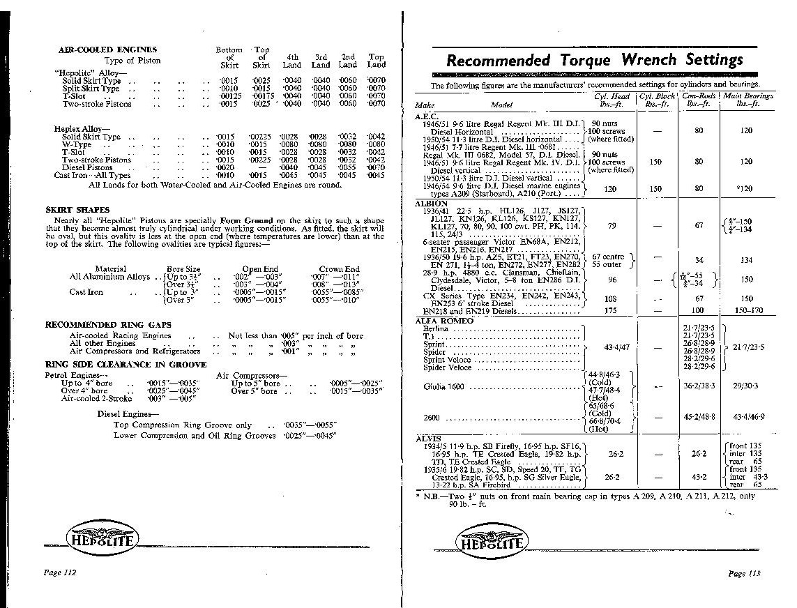

He wanted to know what is the correct torque for the big end nuts? Does anybody know?
In reply to by ulrich_hoffmann
My Original Electra Maintenance Manual specifies 15 foot pounds as the tightening torque for the big end nuts.  I wouldn't think the Navigator will be any different.

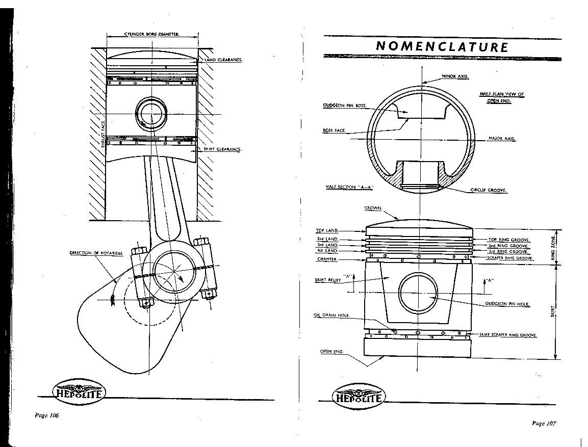

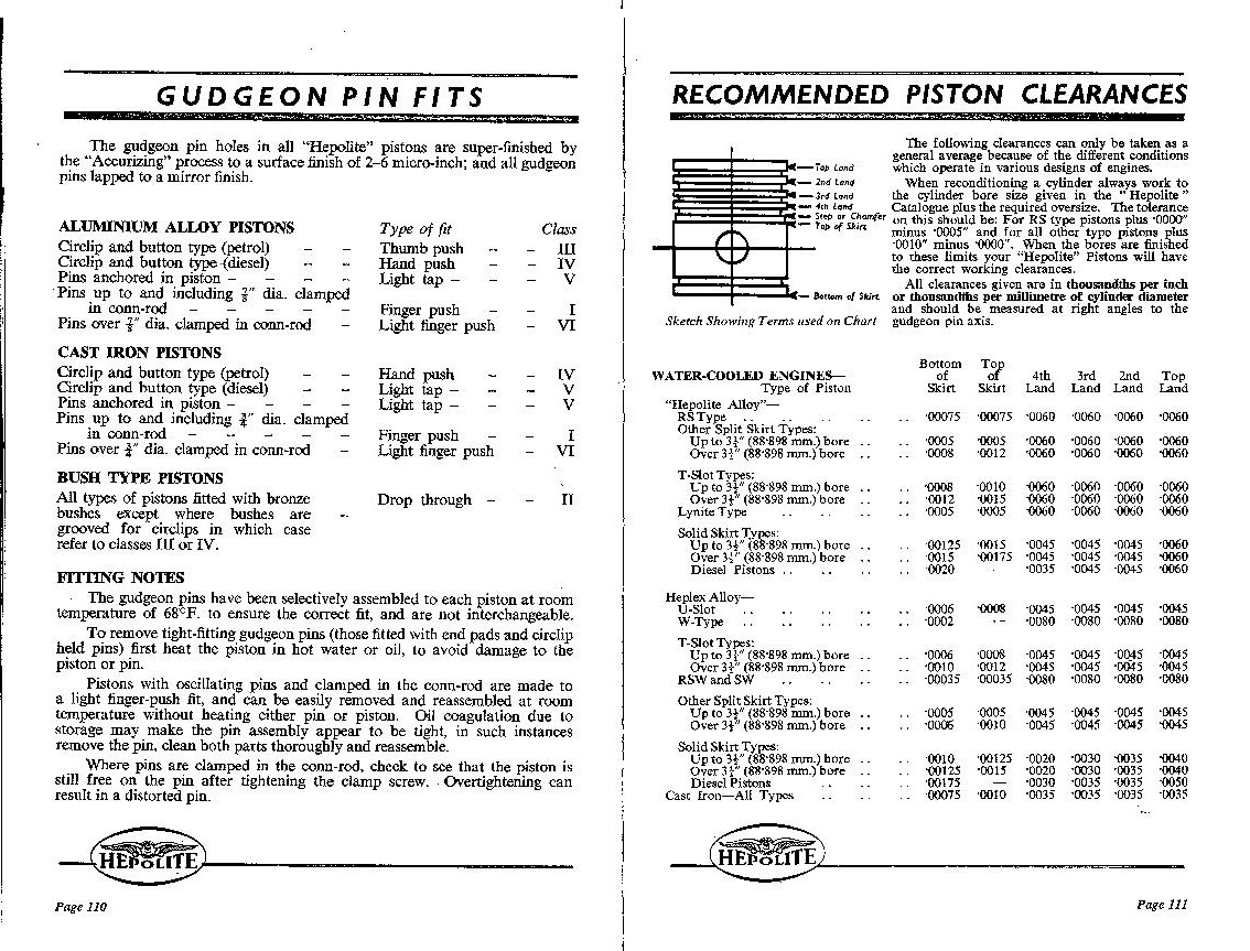

Hi Ulrich, 10,20 and 30 thou are the oversize of the pistons. What we are interested in is the final clearance between the piston skirts and the finished bore.  This varies with the manufacturer of the pistons and the material the pistons are made of. Air cooled engines usually need more clearance than watercooled  and some engines need a bit more clearance than expected due to poor lubrication or heat distorsion. or poor engine orriginal machining. There will be members here who have lots of experience with these engines and may be able to advise on what they have found to work. Its also very possible  that  your problem is down to overheating  on that cylinder and your clearances may be ok,but it would help to know as much as possible .
Hepolite service manual 1961 gives lots of information about pistons and clearances and where to measure and how. Fascinating that pistons at room temperature are oval  becoming round at running temperature. Skirt dimensions vary from bottom of skirt to top of skirt . All information is general and needs careful reading to help decide whats best.
GRAHAM
I have no data or insight into Navigators, but as no one is posting to advise Ulrich I would suggest that the clearance on the thrust face just below the bottom rings should be not less than three and a half thou.  Any better offers?
Looks about right to me according to the data posted by Graham. If that's what it was, maybe add another 0.01"? Or two? The catalogue confirms that the piston should fit correctly if the over bore is correct, so the correction ought to be made in the piston. I don't suppose the machinist added 0.02mm instead of 0.02 inches (0.58mm)?? Then run in very gently to begin with. In olden days they might take the block off after the first hundred miles or so and file away any signs of hard polished marks! Allegedly.

Today I measured the piston clearance with a feeler gauge:
Piston clearance in barrel without rings is between 0.2mm to 0.25mm.
