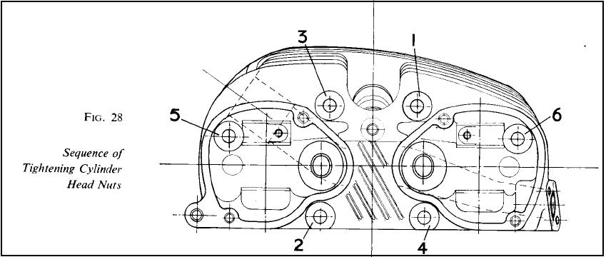

Thanks Stan. I've got the tightening sequence in a manual so I'm alright with that.

I did initially tighten the head -I went round the bolts in the order stated in the manual and tightened them until I felt resistence, as not to over-tighten them. But as there was still oil leaking I thought I better find out the correct torque setting and tighten them up to it.

Head Tightening sequence attached as a file (I hope).
