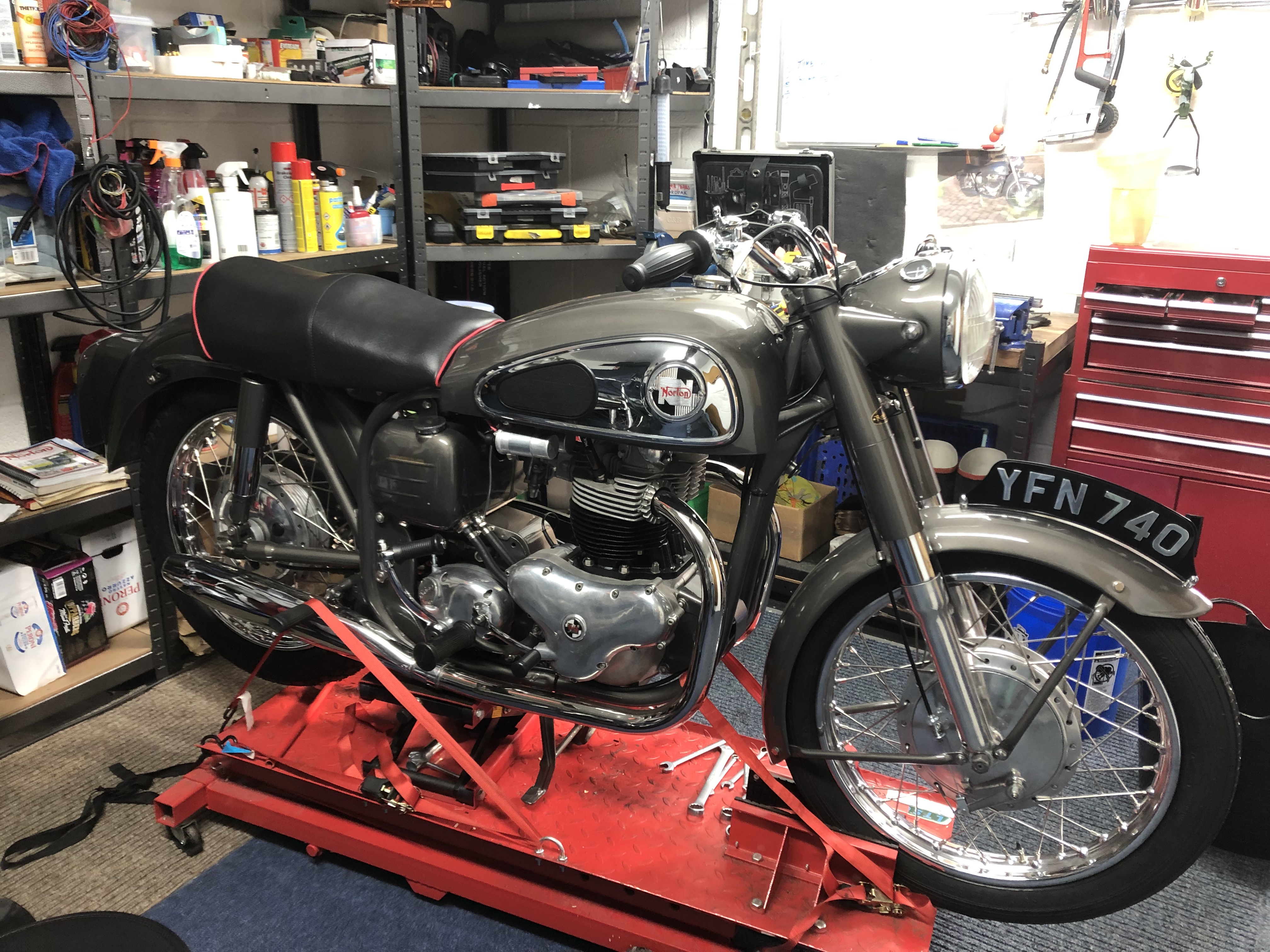

Timing up ‘58 Dommie
No previous experience of timing up anything - but every day is a school day…
Has anybody got the patience to put an idiots guide on here for me? I just want a step by step guide to timing a new build engine/bike up before I have to find somebody to do it for me.
I’ve done everything else myself so I would like to be responsible for starting him! NOBBY Norton)
Dale built the engine… now RM21/12v/Boyer/Al’s reg rect and mc2. PRS8 works and spark at plugs… lube in and oil pressure…what do I do next?
Steve
From your picture Steve, it looks like you have electronic ignition (Boyer)?
So, you just rotate the distributor (after loosening the clamp) until one of the screws on the rotor is showing through the hole in the backplate with your engine at top dead centre. This will be close enough for you to start the engine and should it spark just a few degrees before tdc at idle speed.  If the engine kicks back when trying to start, then retard the timing a little and try again.  You may find your distributor is in an inconvenient position after rotating it and finding the screw and then you will have to alter the chain and sprocket inside the timing cover by a few links to get it right.  There should be a direction arrow on the 'top' of the distributor denoting which way it is rotating.  Once the engine is running you can rotate the distributor in the same direction as the arrow to retard the ignition and visa versa to advance it.
I like to set up my ignition timing on the road and never go by what the manual states as it depends on many different factors - compression ratios and petrol quality.  Firstly, experiment with the rotation of the distributor until you can achieve reasonable starting without it kicking back.  Then, out on the road with the engine fully warmed and in top gear at about 35 - 40mph, open up the throttle and listen for 'pinking'.  If you don't hear picking then your ignition is probably too retarded and needs to be advanced.  If on the other hand, you hear loud pinking, then you are too advanced and the ignition needs to be retarded.  Once you get to the point of very light pinking on opening the throttle at the speeds mentioned above, retard the ignition very slightly and the timing is then set for life and you're good to go :) - unless you then use some crappy fuel that is!

Bob mentions 'a hole' in the Boyer plate, but there is two holes! You need the one that shows the screw 'BEFORE' it passes the coil.
