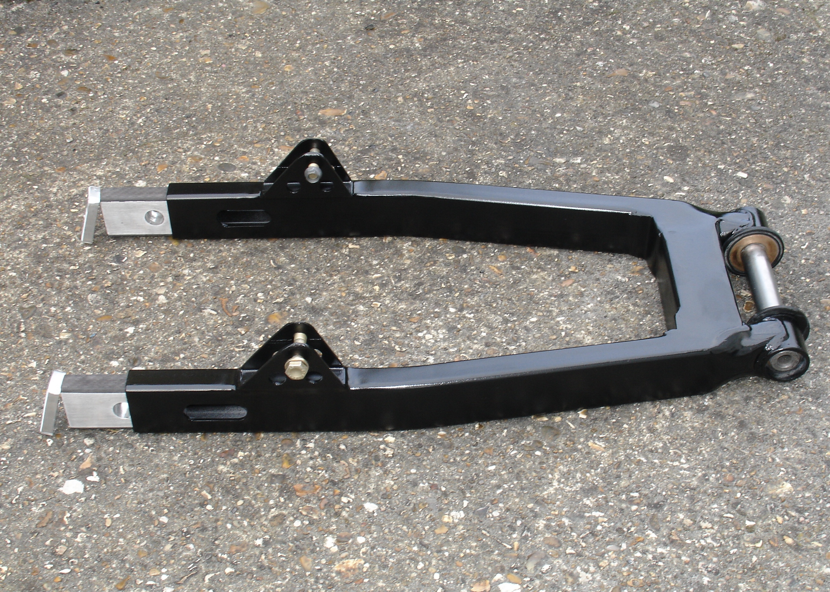

I drew up sketches and dimensions in 2007 for a frame mounted custom swingarm with Silentbloc bushes. Decided not to use it after reading Commando engineers concerns about chain tension with the ISOs on a frame mounted unit.
I made up and welded a DIY custom steel swingarm to the front section and gusset from my Mk3 with its original spindle, bronze bushes and seals in the standard arrangement. See photo below
Stainless M6 stubs were fitted above each bush, connected by 3mm silicone tube to small syringes tie wrapped to the frame with Castrol EP140 as per original spec.
Total loss with the old seals, top up 5ml every 1-2000mls, wipe off excess dribbles as required.
No side play whatsoever at the rear tyre so the stock Mk3 system works perfectly with no wobbles or weaves at any speed.
Simple but effective with at least 45k miles from me plus 40k miles more if they're the original parts. No mention in previous owners service notes of any replacements.

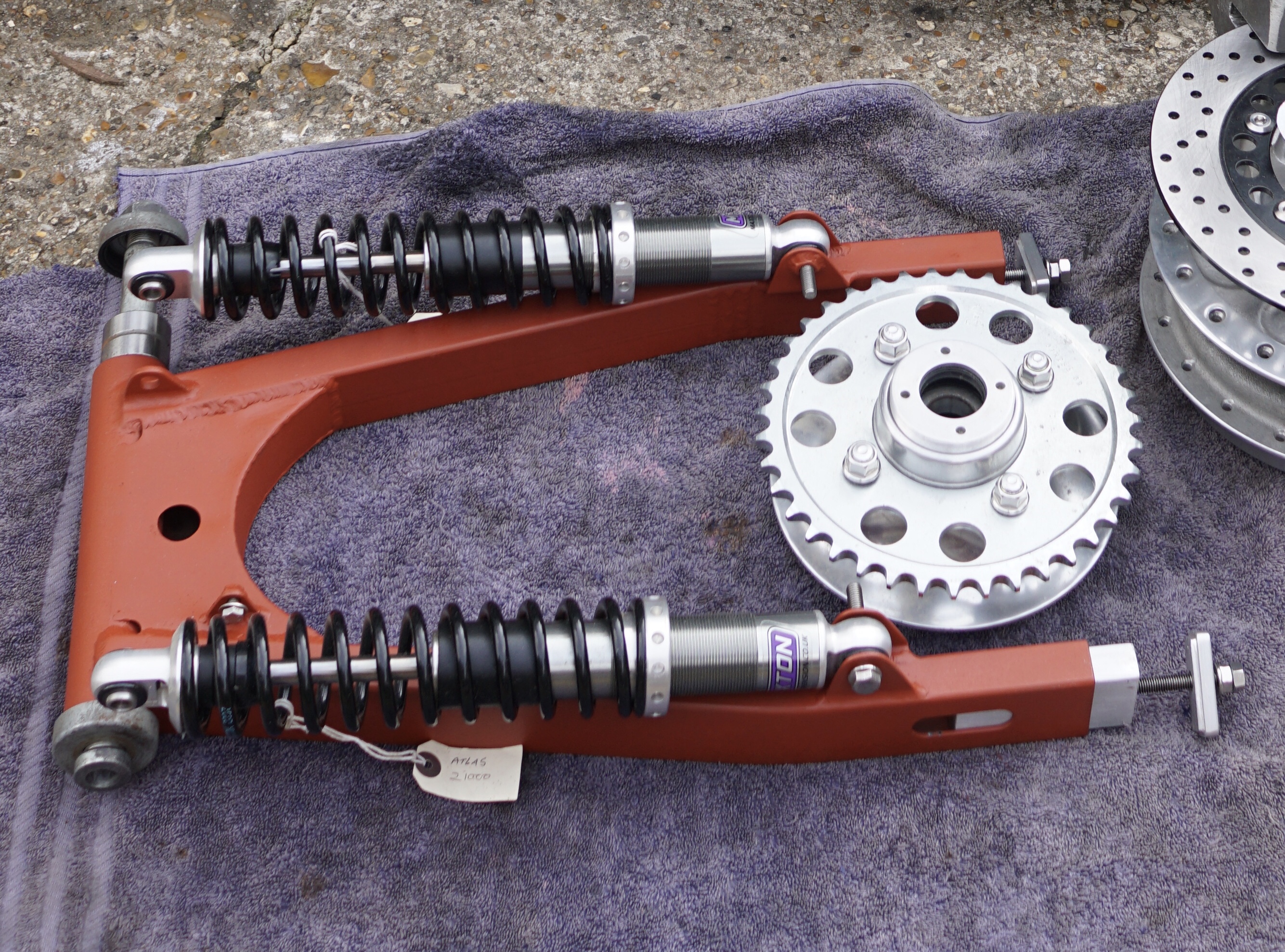

I made up a similar setup for my modified Atlas DIY swingarm. Machined caged (not drawn cup) needle rollers with hardened inner races over a 20mm hollow Honda spindle and Yamaha seal caps. You can see these parts in the pic below. Shimmed to the frame for minimum side play at the rear wheel. Swingarm as on the Commando had to be wider to fit 18" radial tyres on 4.25" alloy rims.

Once again Neil, tremendous work and skills used on your Atlas modification.
Lovely Shocks
Hi, Neill.
Might I ask the make of the shocks & springs shown on your Atlas swingarm? It looks to be a lovely bit of kit.
Thanks!
-Robert

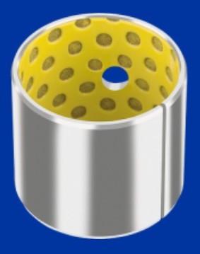

I've used , on another make of bike, Glacier DX bushes. Steel backed plastic bushes. I was sceptical about using these, but they have proven to work very well. They need to be set up rather tight, that is to say, very little clearance, as near to zero clearance without jamming "solid", as any plain bearing in this application to avoid premature wear.

You could probably replicate either swingarm, very basic tools used. Levels, squares, straight edges, hacksaw, files, hammer, arc welder, Bosch drill and disc grinder. Plus plenty of elbow grease.
Atlas pivot tube was machined for my needle rollers years ago by local engineer Eric Cheney RIP, famous for his frame designs. I showed him my swingarm sketch and he said said it would work well.
I always listen to sound advice from people who've done it, rather than negative over thinkers telling you why something won't work, without having built and tested it themselves.
The T6 alloy end blocks and carbon fibre facings were from my aerospace/motorsport collection. Drilled holes happened to be the correct size so just hacksaw and file to fit.
T6 alloy plate used to clamp everything flat for alignment and welding also from my collection. Can't recall how we smuggled that out of the building but it has South African Airways stamped on it.
