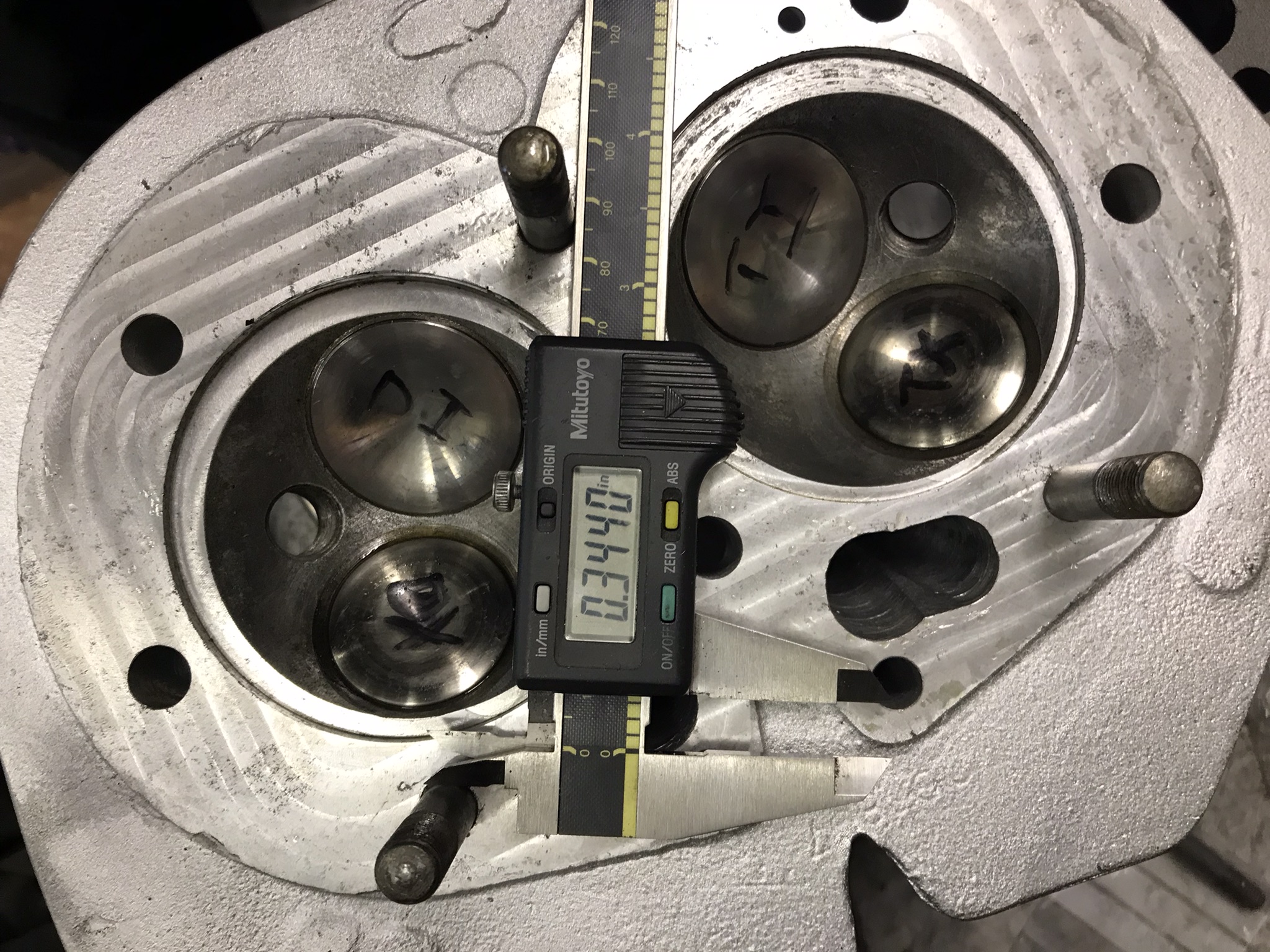

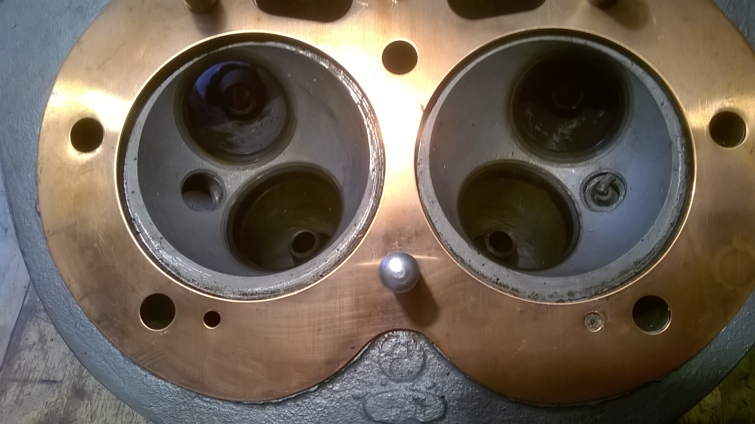

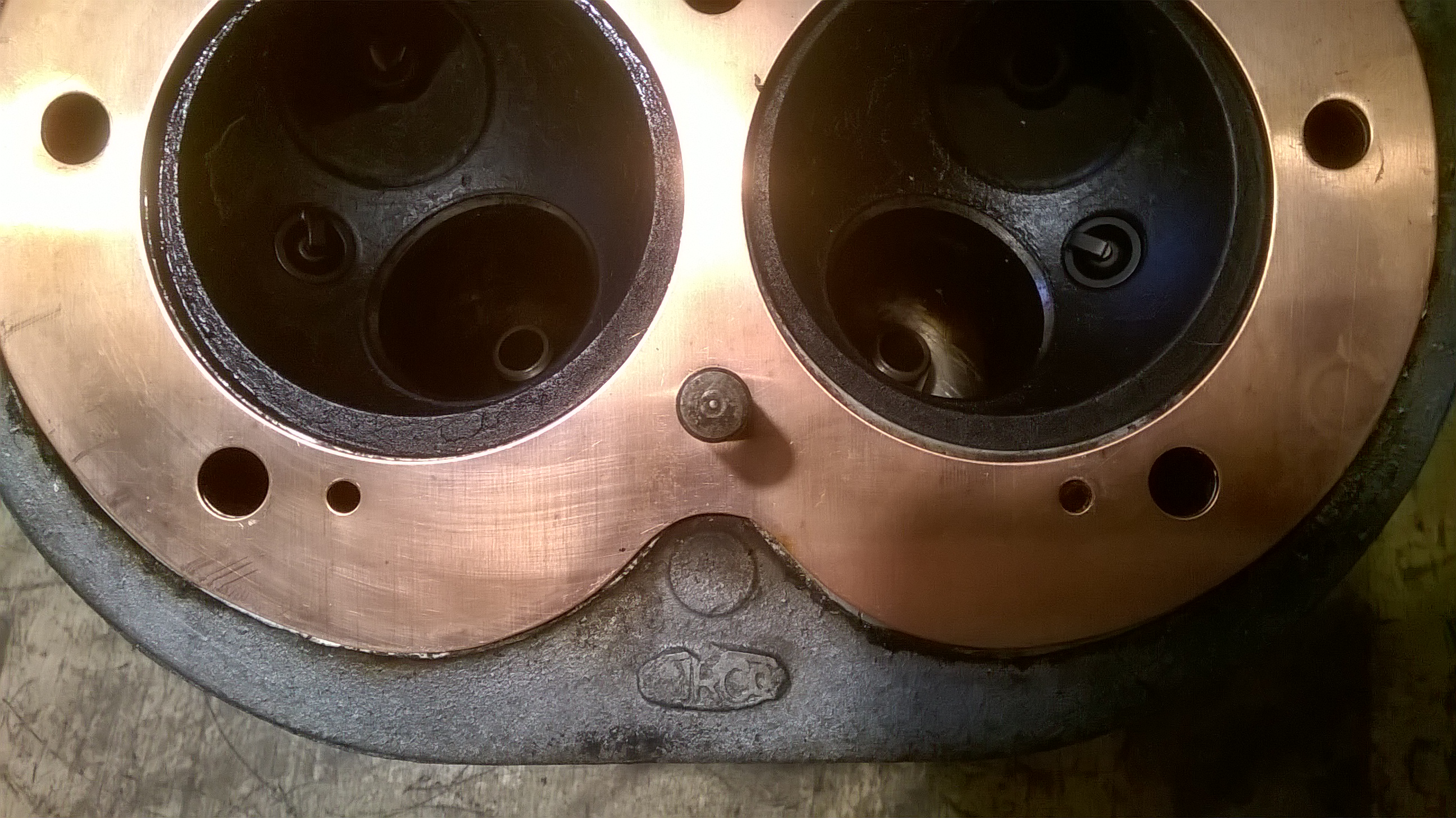

This is the second time i have come across a cylinder head that has one of its combustion chambers machined in the wrong place. The photos show the cylinderhead in question and another head that has them in the correct place. I have used a new copper gasket to high light the error. Reversing the gasket shows the same error. Lefthand side approx 2mm out of line

The measurements is from the stud to the bore edge of the other combination chamber so the difference is clearly visible.
