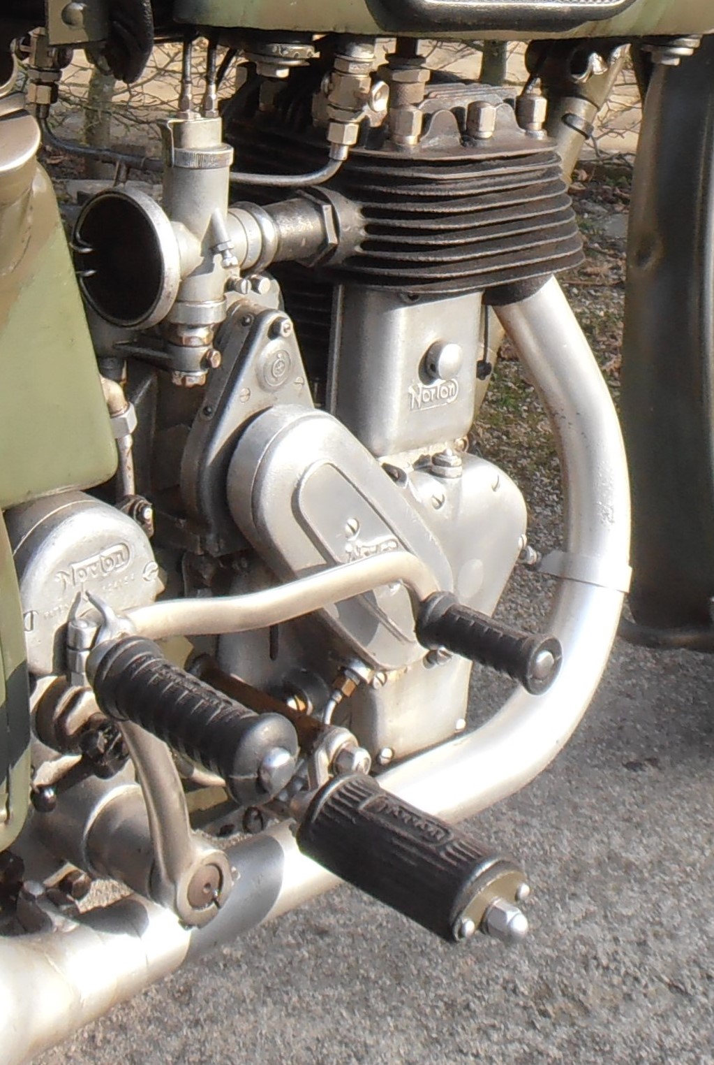

Perhaps I've been lucky or maybe its simply that side-valves are self-limiting when it comes to revs, but my 16H tell-tale is as dry as a bone...it had just seen the by-pass off at 60 mph in this photo last weekend.
tell tale

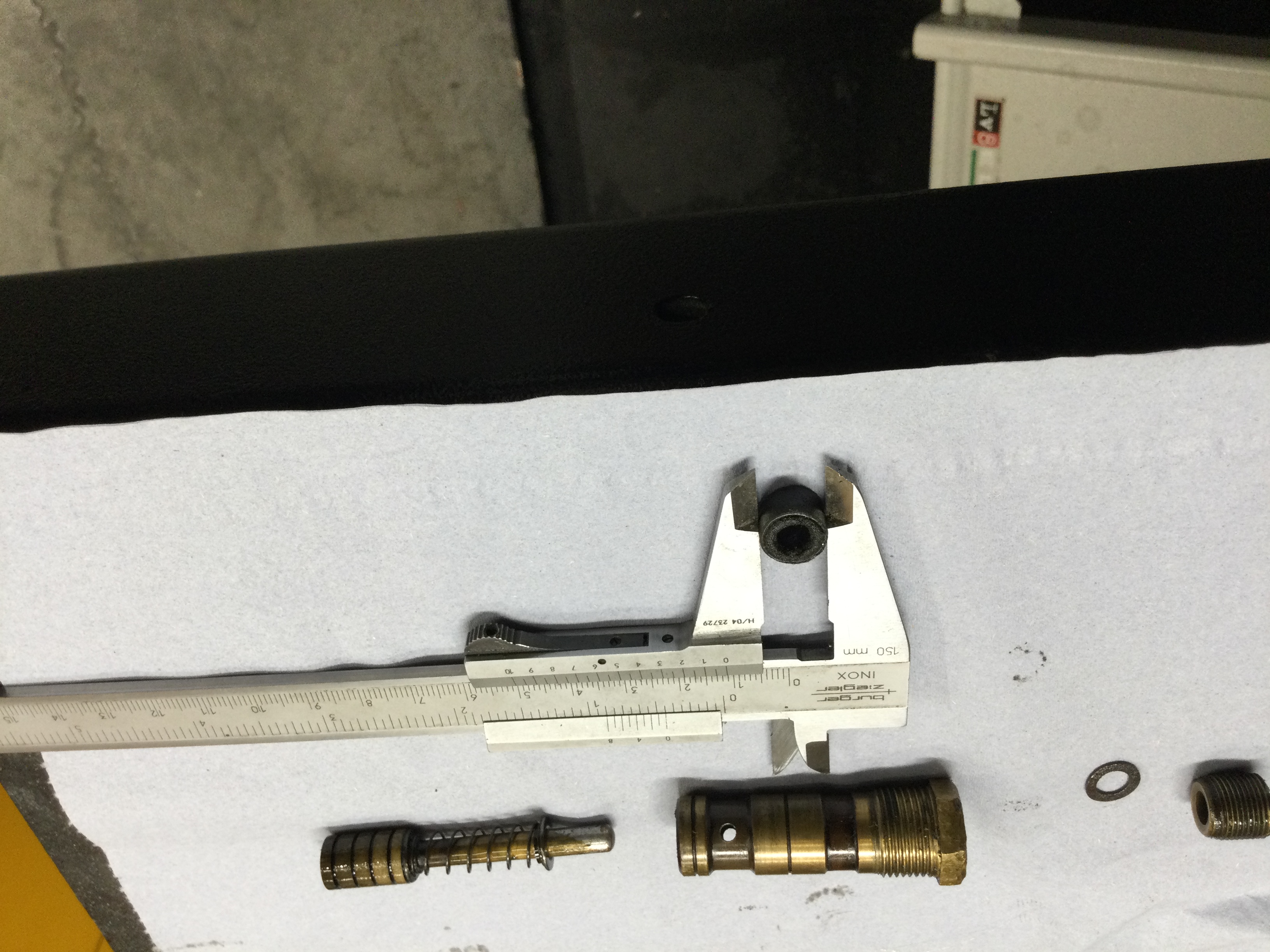

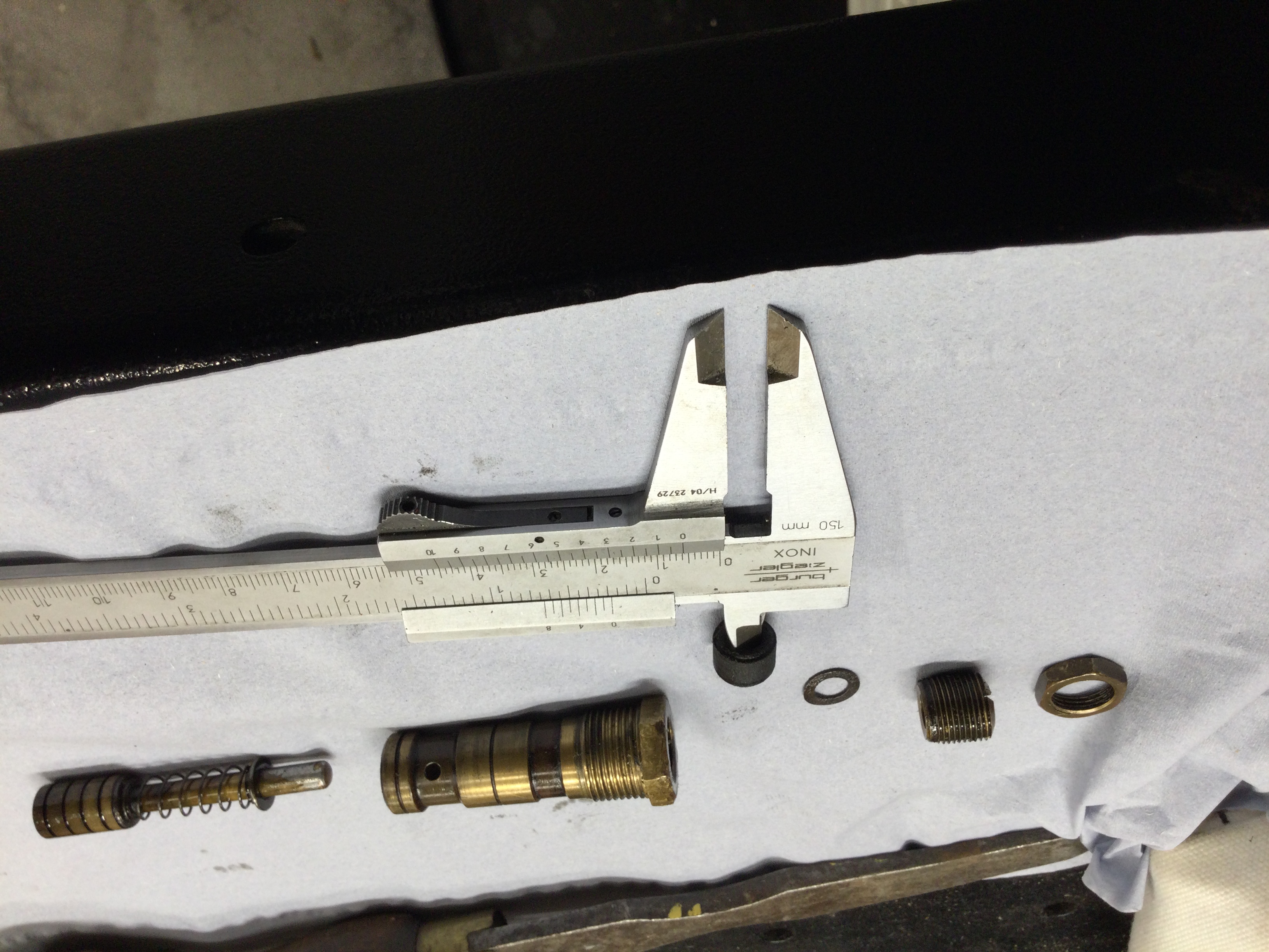

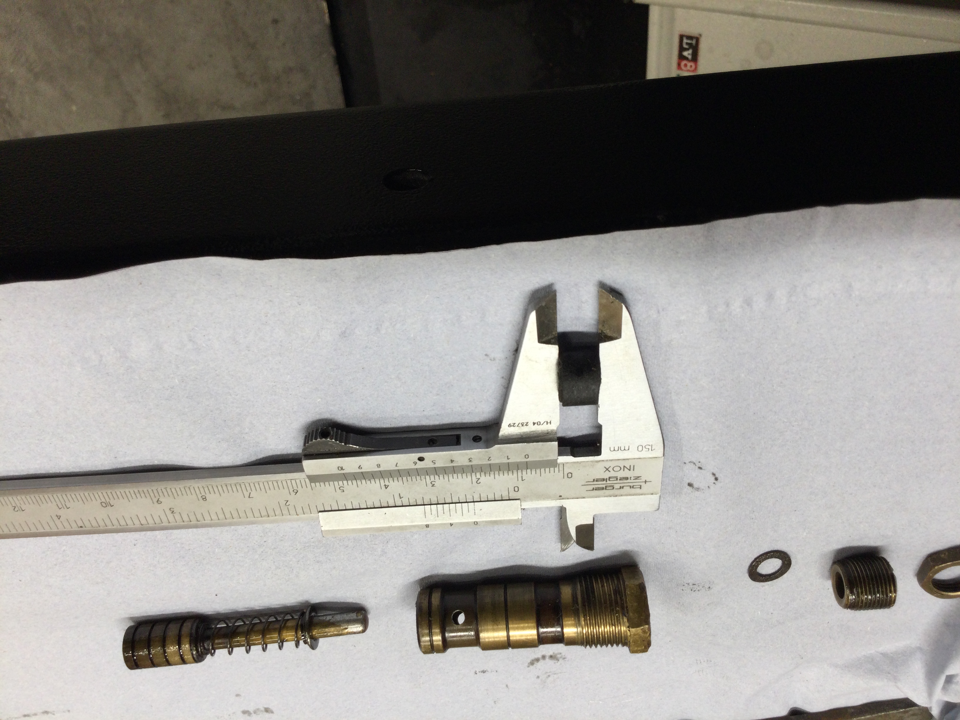

What is the height of that packing?

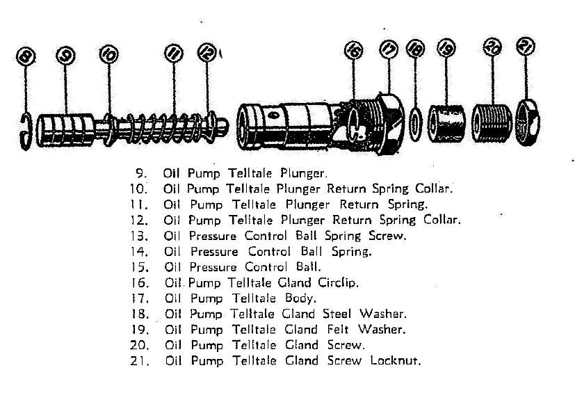

I have not seen a factory exploded view of the Tell Tale to determine what was fitted from the factory.  nor have i tried to remove the packing to see if there is a fiber sort of washer/cup.  I do see packing...
