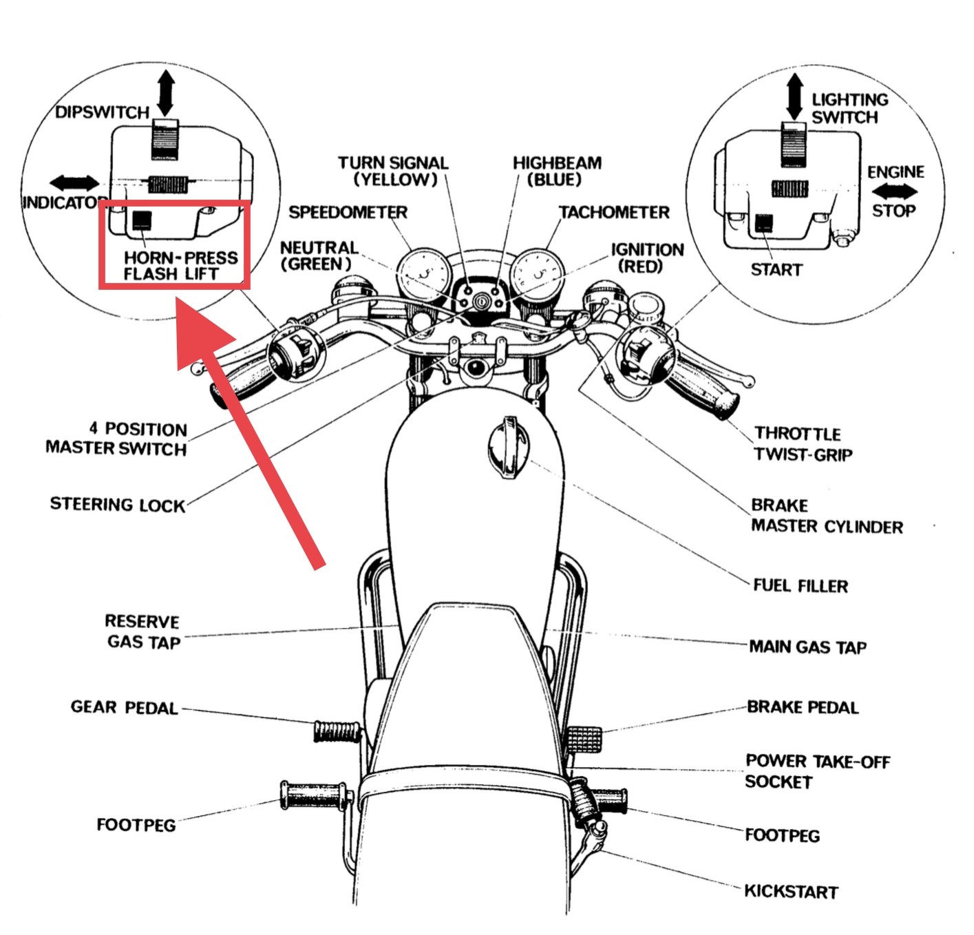

Another thing to think about along with the great advice you’ve already received…
The flasher button (push up the horn) is wired independently to the rest of the lighting circuit, and will operate in the ‘ignition only’ and ‘ignition and lights’ key positions.
It is fed by the same ‘hot’ white cable that feeds the horn.
If the rest of your lighting circuit is behaving as it should do, this is where I would start looking.
The spring could have become weak, or there could be some of the dreaded verdi-gris on the contacts.
In the ‘ignition and lights’ key position (key switch fully clockwise) the pilot/tail light/instrument lights should be on.
In addition, the right handlebar switch should turn on and off the headlamp.
With the headlamp on, the left handlebar switch should toggle between dipped beam and main beam.
In the ‘parking with lights’ key position (key switch full anti-clockwise) the pilot/tail light/instrument lights should be on.
The headlamp should not be on and the right handlebar switch should do nothing.

Yes Stan - you win first prize.
It was the headlamp flasher/horn button, sticking ever so slightly.
All sorted!
My guess would be the headlamp flasher in the LH switch.
