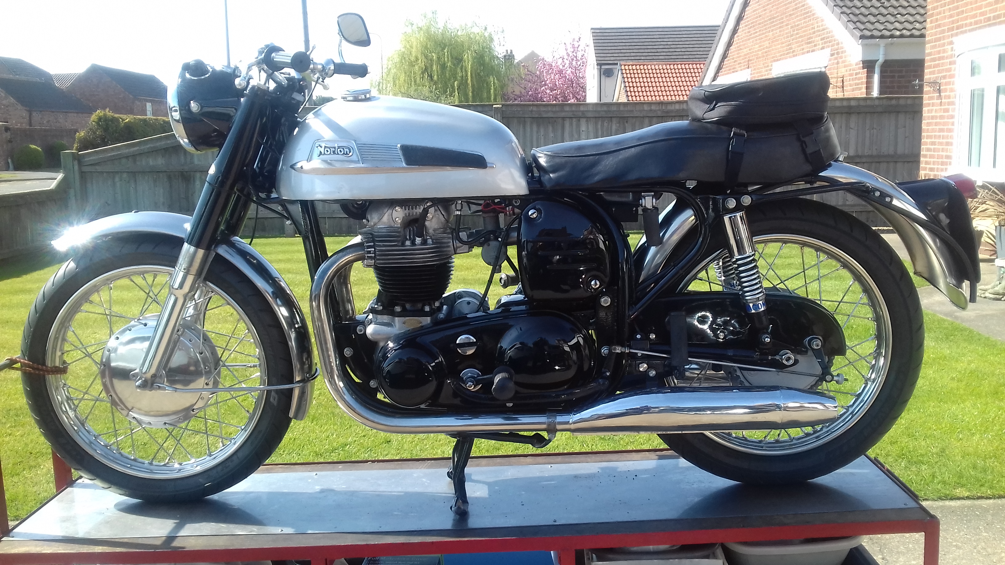

I am a new convert to classic biking and have a 1960 Dominator 99. All appeared great until, on a ride out, I found it necessary to brake hard (my bike has a TLS front brake) when the steering tightened up to the point where I found it very hard to balance let alone steer to avoid an object in the road.  Any ideas where to start looking?

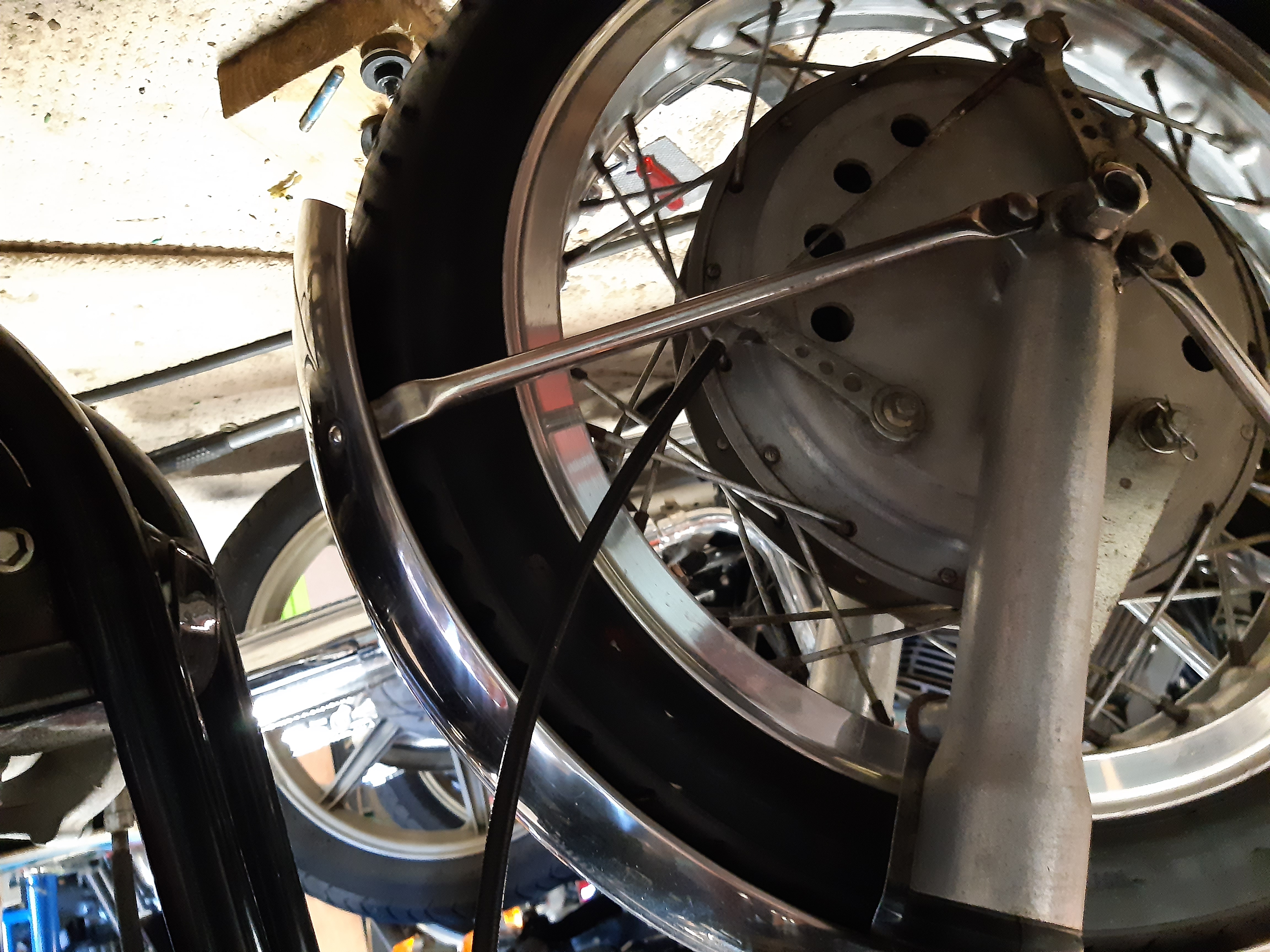

Many thanks for all your helpful suggestions.  I thought I would start with the easiest to determine and the one that best fitted the symptoms - the mudguard/frame interface!.  There it was on the front of the frame clear evidence that it had been in contact with the mudguard.  The original mudguards had been replaced with stainless steel items, the front one attached to the bottoms of the forks by a stout round stainless bar bracket which passes round the outside of the guard, this also bore evidence of contact with the frame.  Problem solved once a replacement mudguard can be found which sits closer to the tyre.

I suspect  that  the main issue you have is the stay is too long. Wanting a slim mudguard (mine is for an 18"wheel), I shortened the stays to keep the mudguard close to the tyre - with a new tyre, the moulding spikes very gently brush the bridge in the forks.
