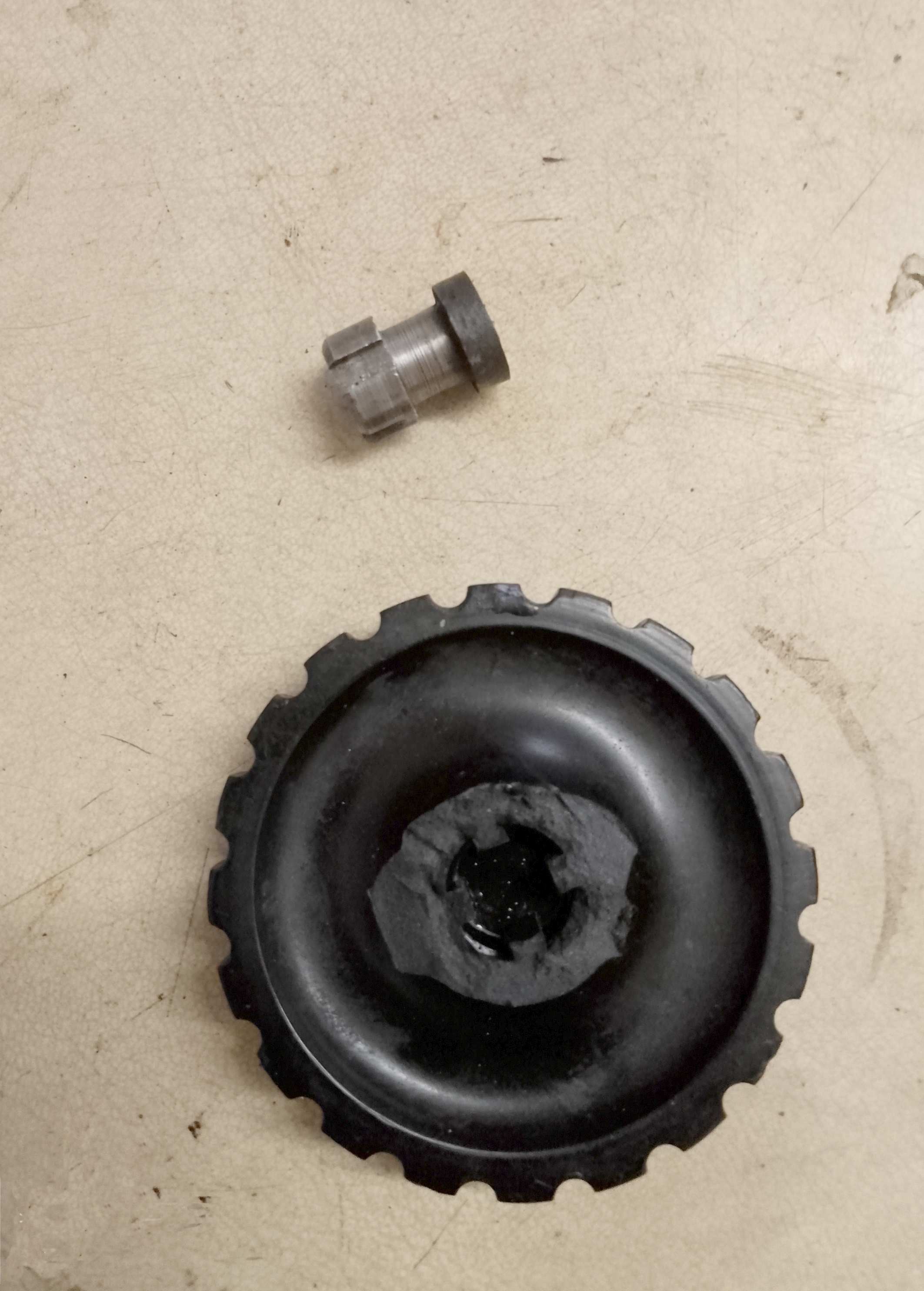

hello, update on the damper knob . tried to undo it by locking the two nuts together on the shaft, it didnt turn. put a bit more force on it, the shaft snapped just level with the knob and cracked the knob, all fell bits. they are ultra tight no chance of undoing them. i should have just cut it off and drilled it out. i think i will see if i can rescue it with some JB weld.  if all else fails i might get a chain for it and wear round me neck .  Barry
