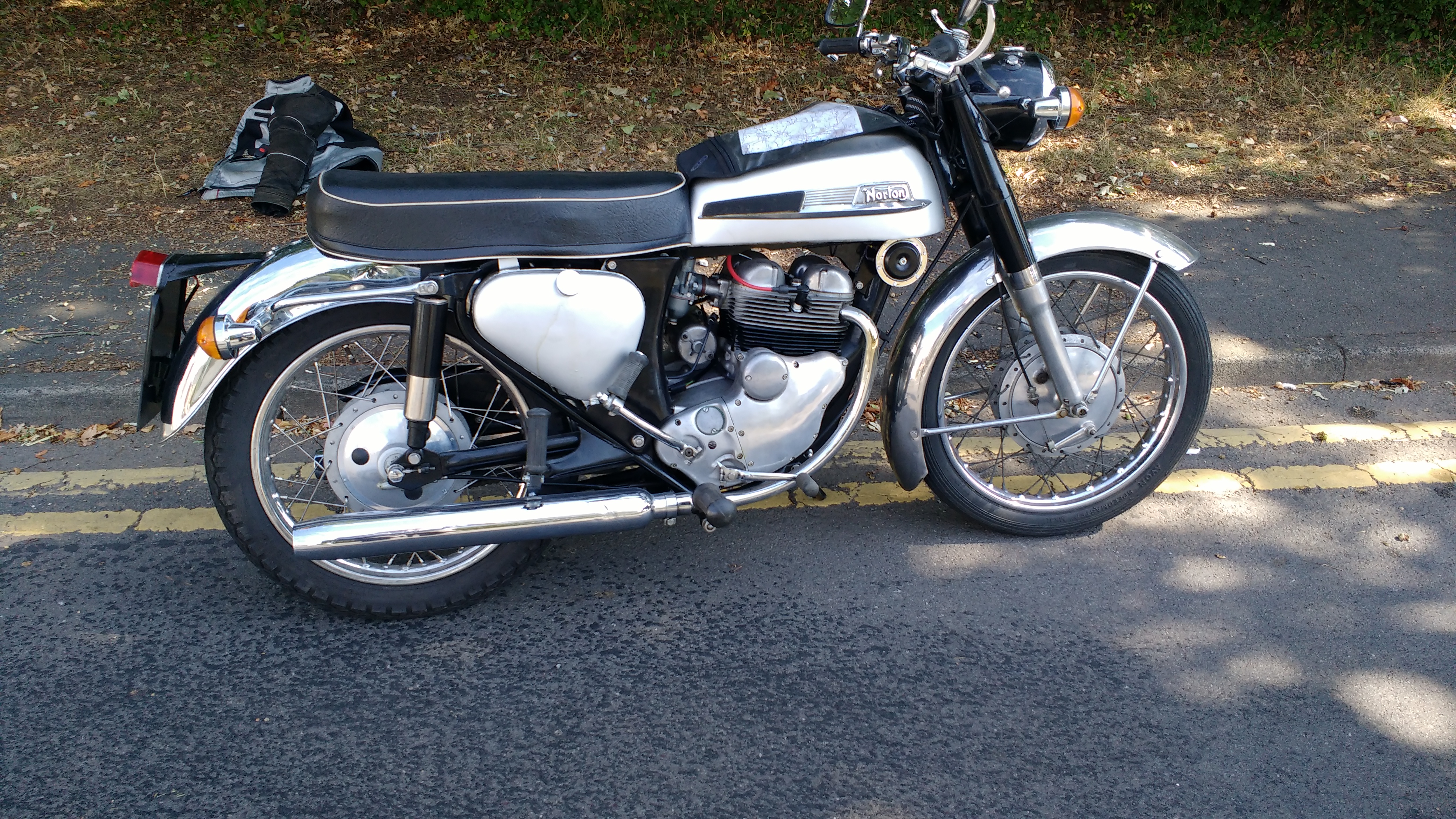

Not quite original looking but I've used this type before with some success. Here is the Electra in repose. Waiting for the man.....
A man on a Norton broken…
A man on a Norton broken down in Redditch meets a kind man on an Enfield! Ironic.
