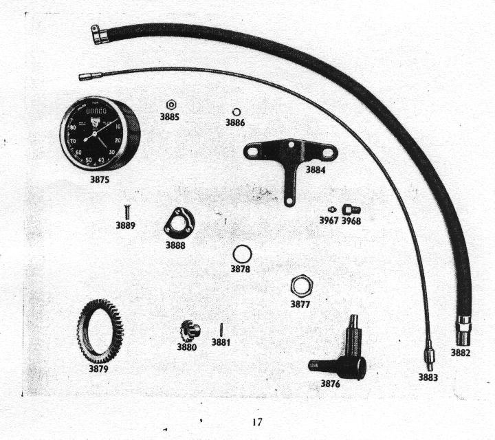

Does anyone know of a good supplier who could provide a decent speedo cable for a 16H? I need the type that fits Girders with a front wheel speedo drive. Internet searches produce no end of results, but all supply the post war, rear wheel drive type only.

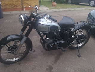

The bike has a WD engine and frame number, but when I I acquired it, it had been converted to roadholders and a rear wheel speedo drive. I have managed to obtain a set of what I believe are earlier Girders, as they have bushed spindles (I understand the WD forks did not) and the mounting for the speedo is not as per the WD diagrams I have, as the grease nipples are in the wrong places. However, they are definitely Norton Webb forks, they have rebound springs and the Norton front wheel, complete with it's drive, is a perfect fit, and 100% correct.
The bike has been fairlyuniversally"civilianised" since the war. It now has a standard 80mph chronometric Smiths gauge, so I am not sure the Jaeger style cable will be correct. It is the only reference photo I have though.
I am sure JJ cables will be able to supply my needs either way, thanks again for you help.

Previously wrote: JJ Cable…
Previously wrote:
JJ Cables (they're in the services guide) can make a speedo cable to your requirements. As far as I'm aware, they are the only source of the thick Jaeger-type clip fixing cables as per your illustration (these were used pre and early WW2). The construction is not identical to the originals which had a spring outer, the new ones have a more conventional system but they look OK and they work.
Length will depend on whether your speedo is mounted centrally or with the off-set bracket used on later WD16Hs.
I calculated the length for my central unit at 25" and it fits well. The alternative bracket would be a little shorter, I'd think.
