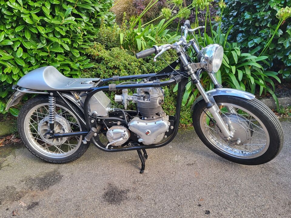

Just planning to do some rebuilding of my recently purchased Norton Dominator 88 1959 and wonderd what `special` tools I would require to strip and rebuild the motor ? Thanks .
