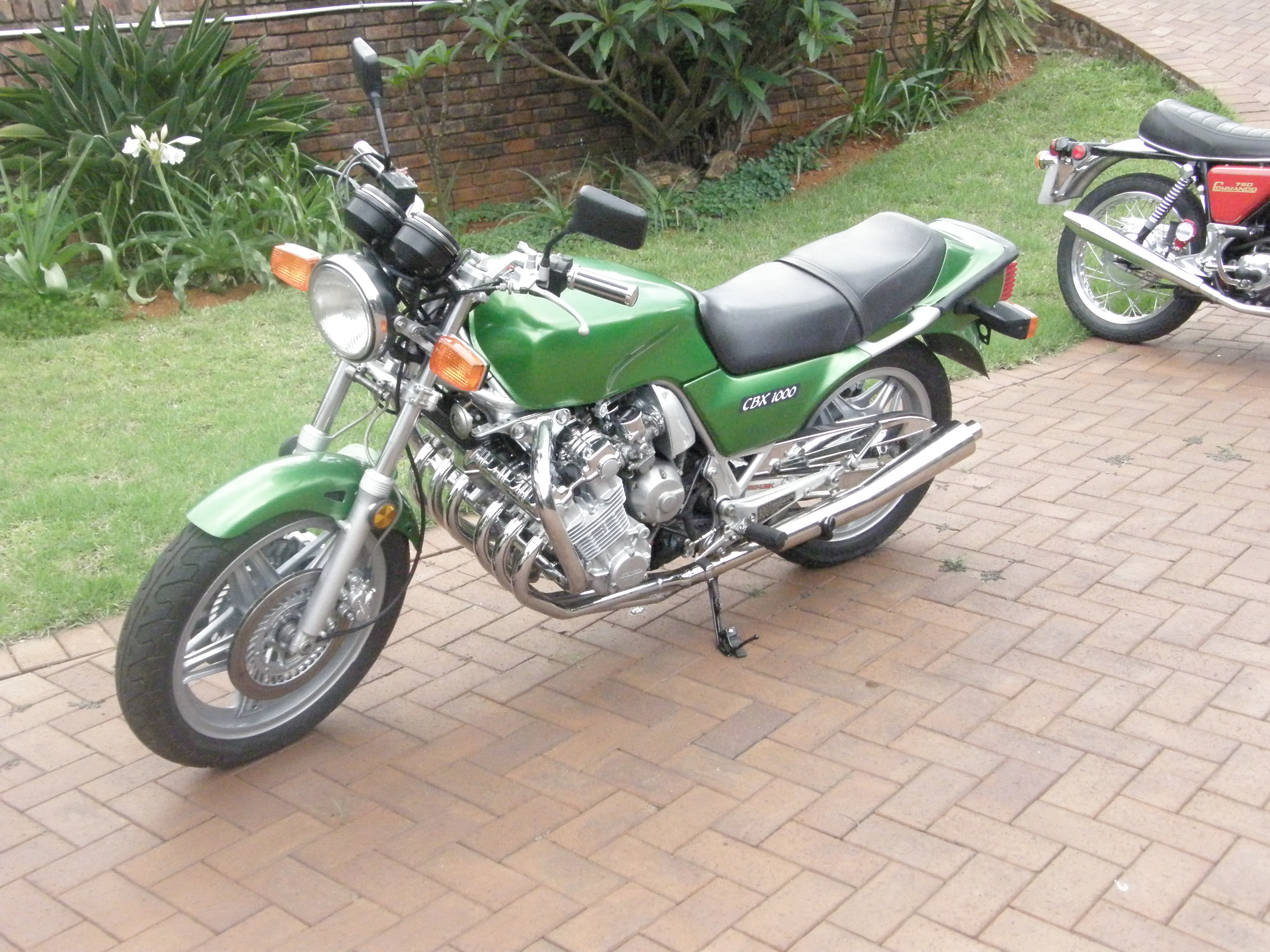

In the meantime I acquired a 6 cylinder Honda CBX which had been lying in the back of a garage for 10 years and was asking to be rebuilt. So I obliged and work on the 88/99 came to a halt.

CBX equals 3 X the bushing problem than that of  the 99!
