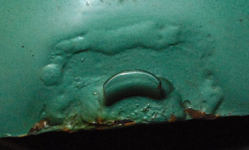

Hi. I have two slimline frame petrol tanks, both still in the original grey/silver paint. The only difference between the two is that on one of them the rear mounting ‘hook’ (for the rubber band) is flush with the rear of the tank - you can’t see any evidence of a join between the two surfaces. However, on the other tank, the hook is mounted onto a square plate which is itself tack welded in four places to the back of the tank. At first I thought that someone had cut off the hook for some reason and then re-attached it at a later date, but on looking through a Norton book (one of Roy Bacon’s) I found a photo of a tank that had the welded plate/hook on it. I thought it might be my tank, but it can’t be because the welds are in different places. So does anybody know the story behind the difference in tank mounting methods? I’m assuming that one is later than the other but I’m only guessing.

I’ve attached photos showing the filler caps and the different hooks.

Thanks for taking the time to get involved with this. It’s strange that Mike’s tank and Colin’s tank have the welded on hook plate but the filler neck is on the left. My tank with the welded on hook has the filler on the right - another weird situation.

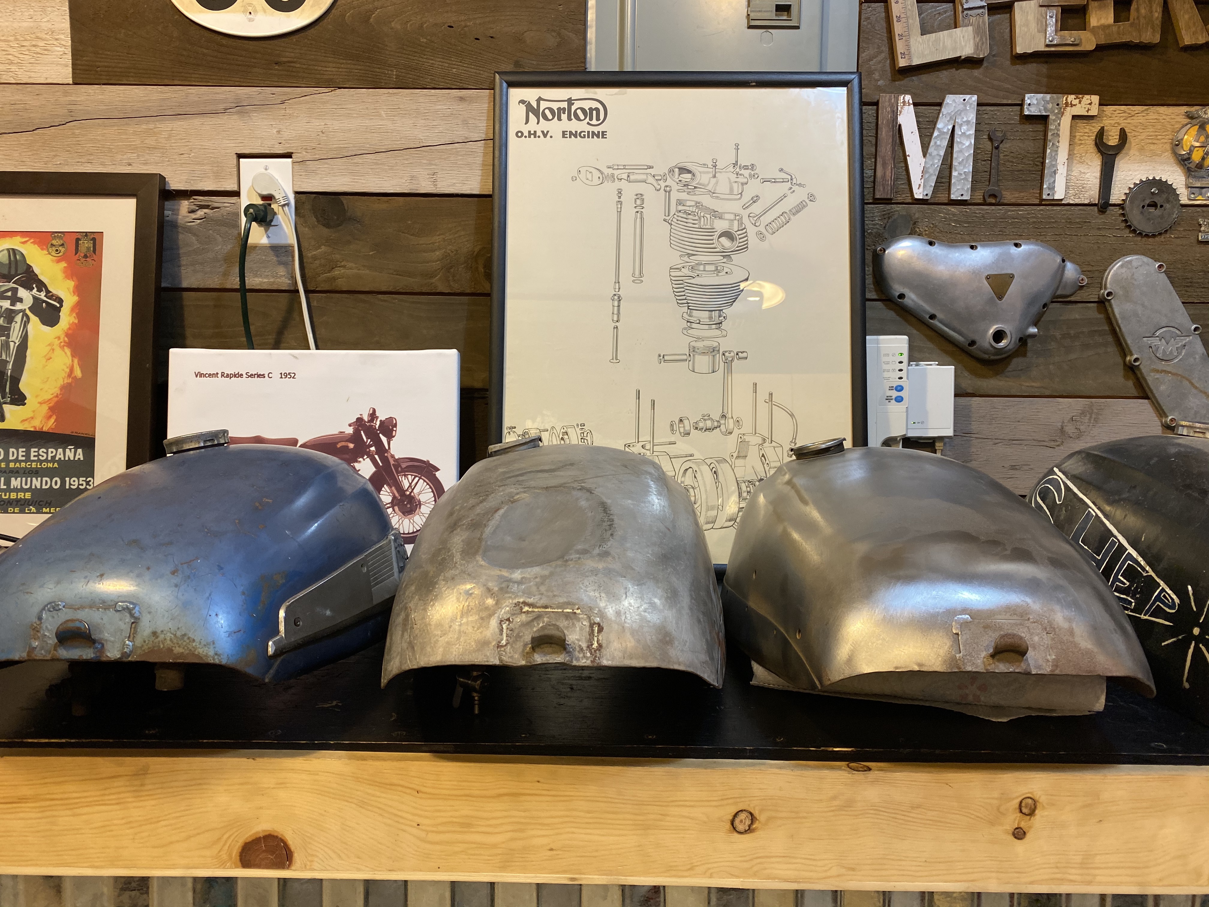

Hi again Tony, Robert and guys
Thought you might like to see a few pics of 3, yes 3 Manxman (should that be Manxmen?) tanks side-by-side and showing the rear mounting hooks.  Two of the tanks belong to friends.  The fourth tank belongs to the long-awaited "Shep" Atlas project for another time.  I'll be doing a video of the tanks soon to compare the polychromatic blue color/colour on these tanks and some other parts. The goal will be to compare the blue on various parts with paint codes from Anna to try and find the best overall match.
Best wishes
3 Manxmen
3 Manxman Tanks
Rear Tabs
Rear Tabs
From the top
From the top!
