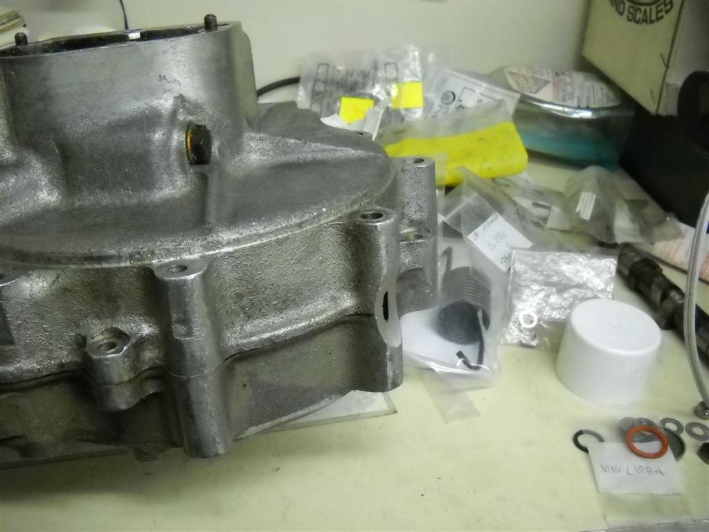

I have attached a photo that shows the remnants of a "silver" paint on the cases of the International I am restoring.
As earlier conversations seem to indicate the possibility that at least some alloy cases were painted I am considering painting mine.
Another input from a source in Winnipeg,Canada claimed that some poor quality cases may have been painted.
I will attach another photo in a sequential email showing a repair that I believe is factory made on these cases.
This "silver" paint seems to have a green or golden cast to it. Not sure how well it will come through on the photo.
Anyone else seen this color or have suggestions as to this is a proper thing to consider for doing a proper restoration?

The greeny-gold colour closely resembles the residue left by Castrol R which finds its way on to the outside of exposed valve-gear engines. I have the same on my wife's 1931 Rudge TT Replica. Gordon.
