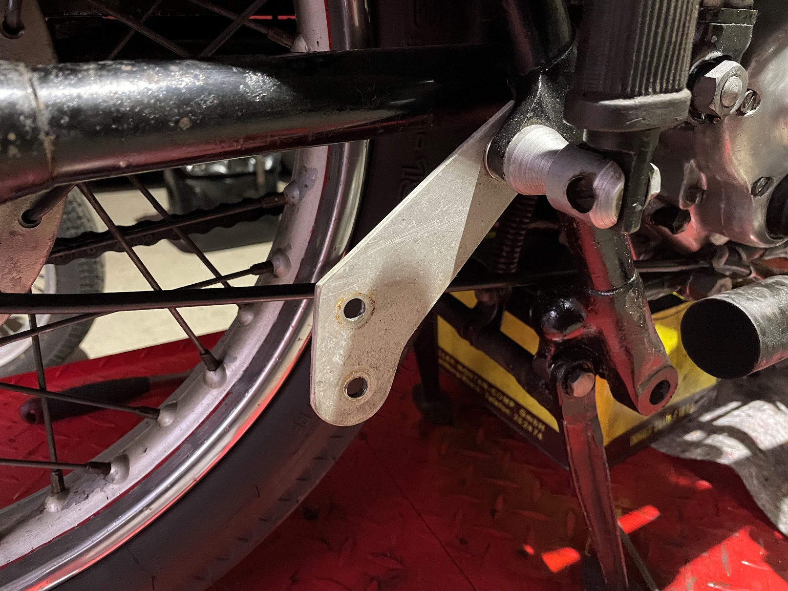

Is this silencer fixing plate the right version or was something else adjusted there? Many thanks for your help. Greetings Heiko

The orriginal silencer bracket is likely to be the same as used on the dominators , just a dog leg flat strip with 2 holes to fix to the silencer and one larger for footrest , it’s heavy gauge about 1/8” thick . Bends to keep silencer as high as possible and clear of kickstart , often silencer shape not correct and fouls the frame tube etc and requires a dent! To clear or special bracket to be made .
Hi Heiko, that plate looks homemade to allow the use of a non standard silencer perhaps a Dunstall or Goldstar , this was very common practice. The orriginal bracket would have been a much more solid item , slightly more flimsy ones are available from our suppliers but I would wait till you have the silencer as the replacements often are not correct in the mountings positions and you may want to get your local blacksmith to make a bespoke one .You will be pleased to know that you have an orriginal and now rare pillion footrest complete with correct rubber that I have been looking for!!
