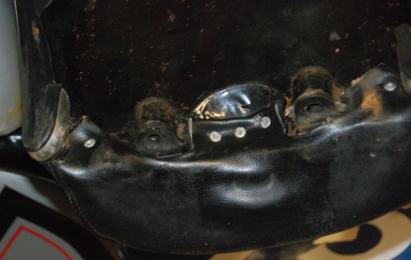

Thanks Mikael - hope these pics of my pins help you.
David - regarding the fixings, I have gleaned from the Norvil site (difficult with no photos) that:
Front bushes are possibly 067790 'Rubber - D - Slimline at Front' - 2 required at £3.85+VAT each

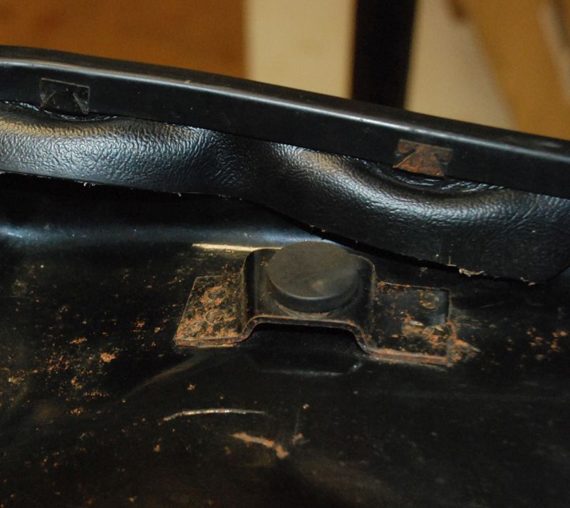

The mid holes do rest on the frame and so I think take the rubber 'buttons' which I have seen on other sites.

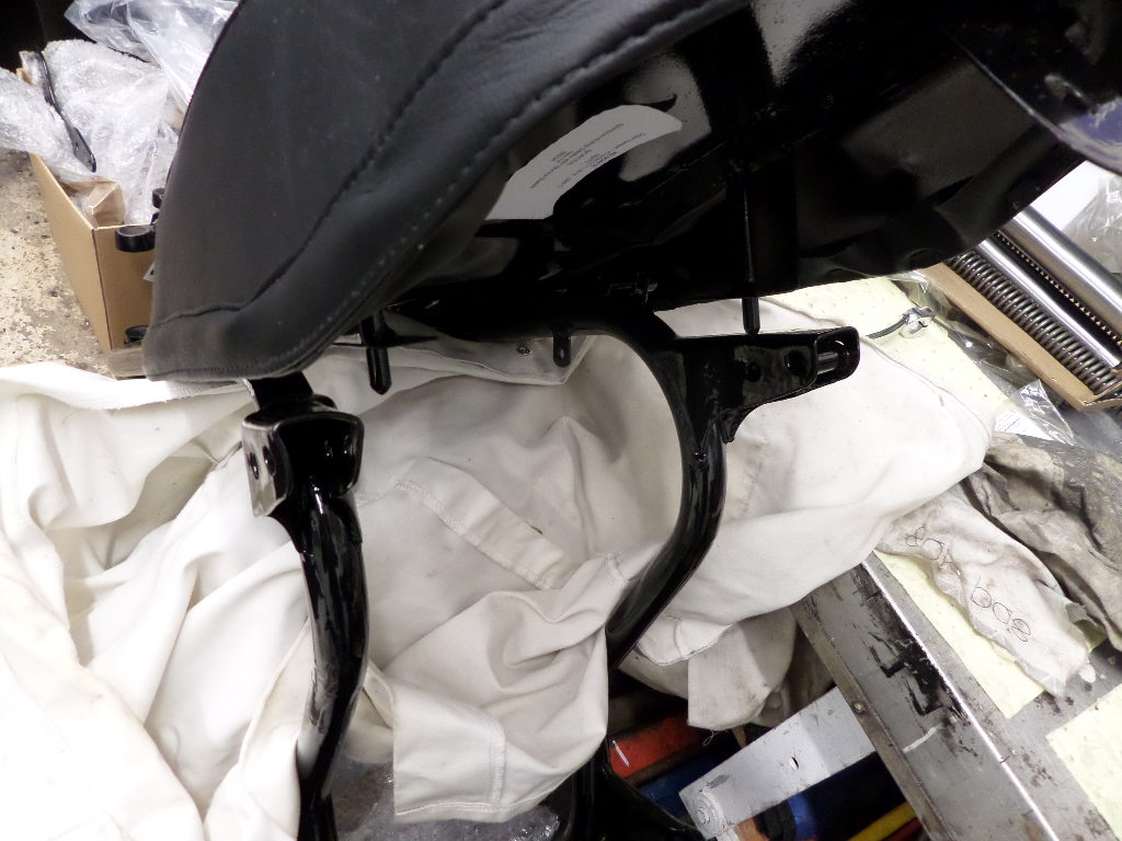

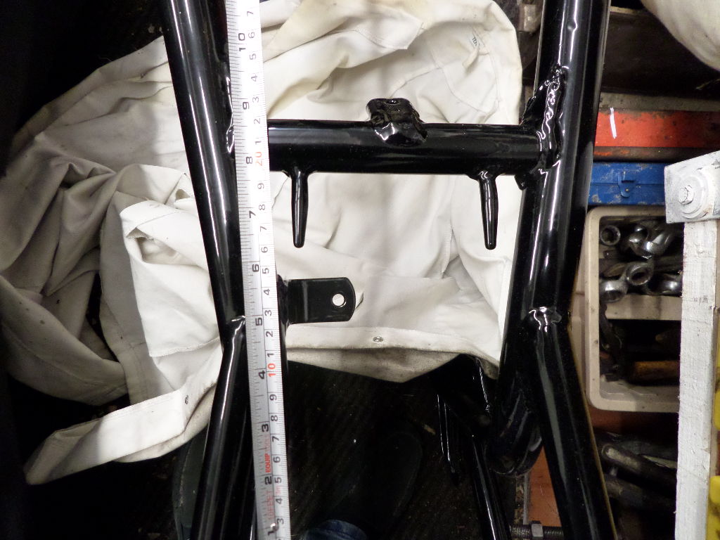

The rear seat pins seem to 'hang in the air' on mine, inboard of the suspension unit mounts, without an obvious hole - unless there is some mating bracket which will materialise when I build it back up? (see photo)

Just checked some old pictures - this was taken some years ago and shows the arrangement from the rear.

The seat pins rest on the brackets above the rear mudguard bolts facing inwards visible here. (The rack is obviously home made - and badly painted at the time this was taken! I retained it with the seat pins, adding rubber bushes under the arms from the bracket to take the lower ends of the seat pins and stop the rack from bouncing around)
The seat was then new and I don't seem to have fitted the Dzus fastener. I think that a secure seat fastening is/was required by MOT test? It does discourage tampering to gain entry to the tool tray.

Thanks for the photo David - I'm pretty sure there were no such brackets fitted when I took the other seat off (it was a Dunstall type, fibreglass 'racing' seat). Better get my metalworking gear out!! I remember, back in the day, a bungee round the seat to hold it down was common! Cheers.

Now that I know what I'm looking for, I can see the rear brackets on the attached exploded frame drawing - right next to nut number 58.

Just been to the shed to check and my seat looks exactly like Mikael's. I bought mine direct from Leighton and it came with the rubber bushes and rubber buttons. Maybe Norvil have short changed you if they not include them?
The angle supporting the pins is actually welded to the frame, and not a separate item.

My (new) brackets will be bolted as I've just powder coated the frame and don't really want to grind/weld it.

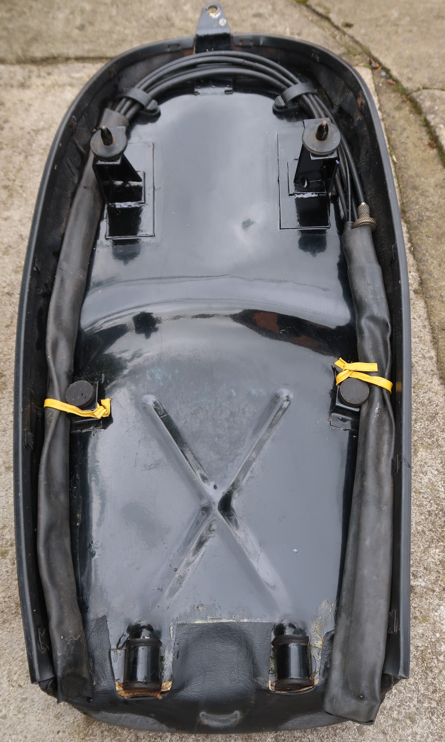

I know that my 1968 Mercury is a bit later than your bike but it appears to have the same fixing details with "D" shaped rubbers at the front, rubber buttons in the middle for support on the frame and two pillars at the back with prongs to push into the holes in the right angled bracket by the top of the suspension unit. I think I added rubber washers (tank mounting rubbers) to the rear metal prongs to help support the seat and stop damaging the paint on the brackets.
Whilst fitting the new seat I realised that all my spare control cables would fit neatly under the seat pan by using a couple of cable tidy clips, see photo. An old bicycle tube is useful to protect them and keep them tidy and stop them rubbing the frame. They are then easily available to make repairs or help out a mate!

Top tip indeed!
