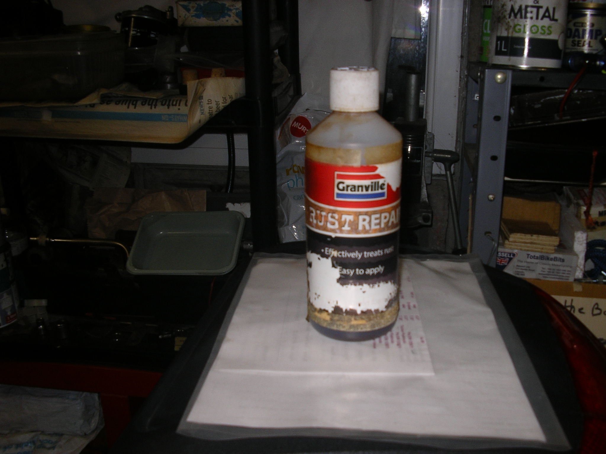

This Works for Me
I put various small size odd metal shapes inside the tank and then shake these around for 5 minutes. The inside is then flushed out with petrol and the above repeated twice more.
I then allow the tank to dry either outside or in my disused greenhouse. Finally I pour in around 250ml of Granville Rust Remover. This gets sloshed around for 5 minutes, then the excess drained and the tank left to dry for 24 hours. This goo is similar to but far better than Kurust or similar anti-rust treatments.
