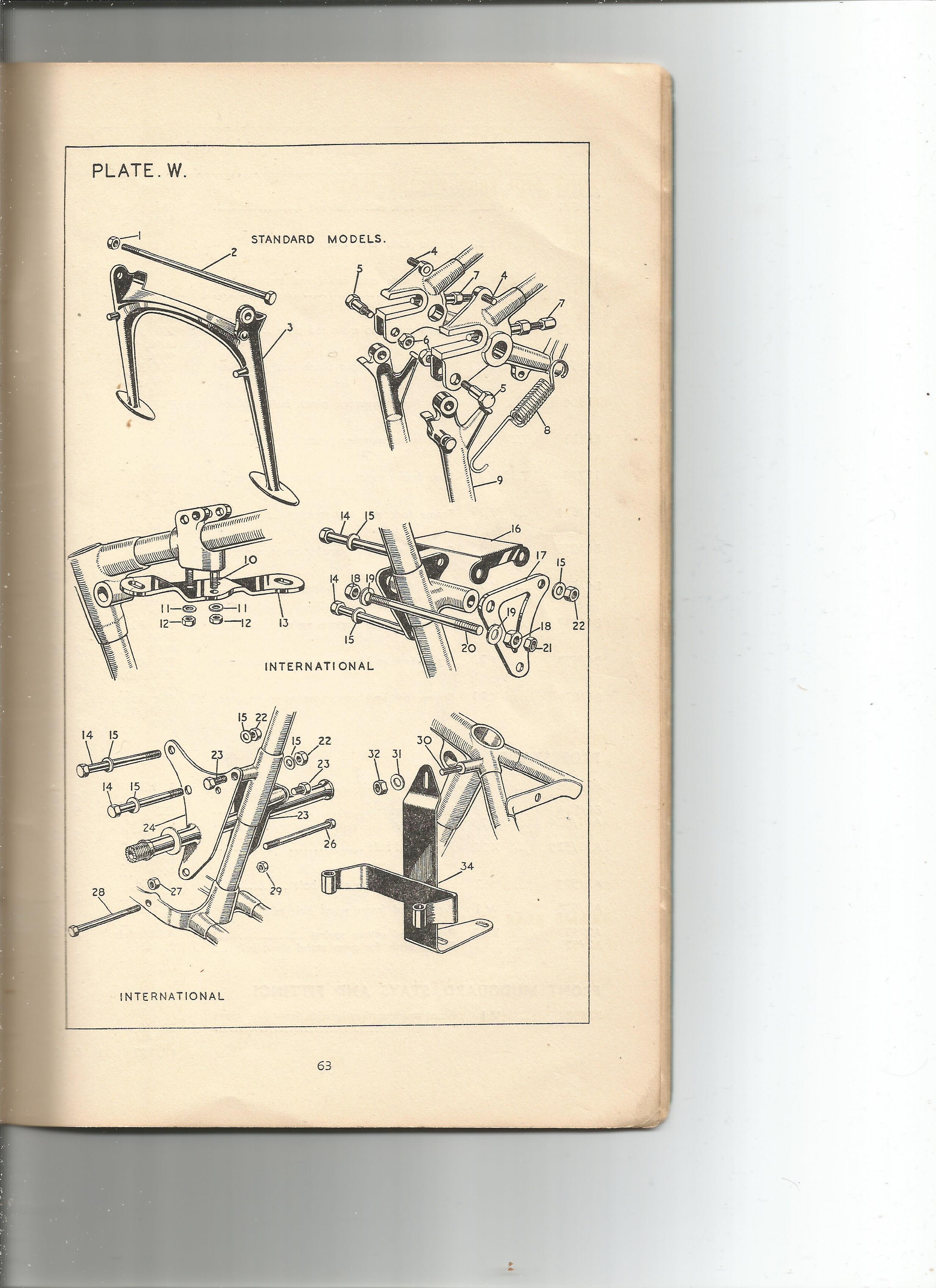

   I am attaching a couple scans from the 1949 parts book which lists the bare frames at £30 each.

thanks a lot for the scans from the parts book, it is quite interesting to see that frames were offered as regular spare parts, and also that the frames for Internationals and ES2 have different codes, so apparently they are not identical. I read somewhere that the OHC engine is a bit taller than the OHV engine, and that the international engine for that reason does not fit into the ES2 frame (I have not checked this myself).

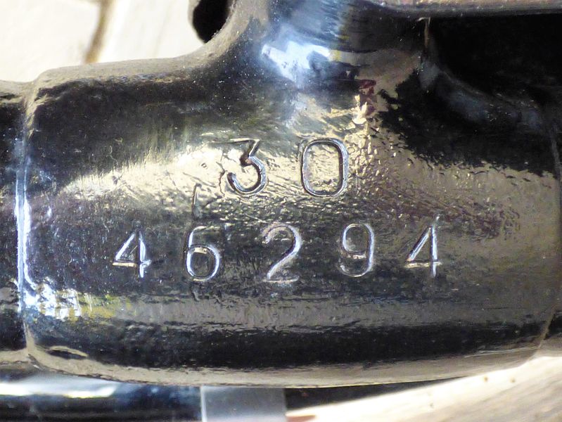

The frame number of my Inter has a "30"- prefix (see attached picture) which would indicate a 500 International. Not sure if I should strip down the paint... at least it does not look like a bodge (or worse)...

The picture you a referring to has nothing to do with my 1932 Inter, I only posted it in the course of the discussion about frame number locations. It shows a post-war matching numbers Inter, obviously.

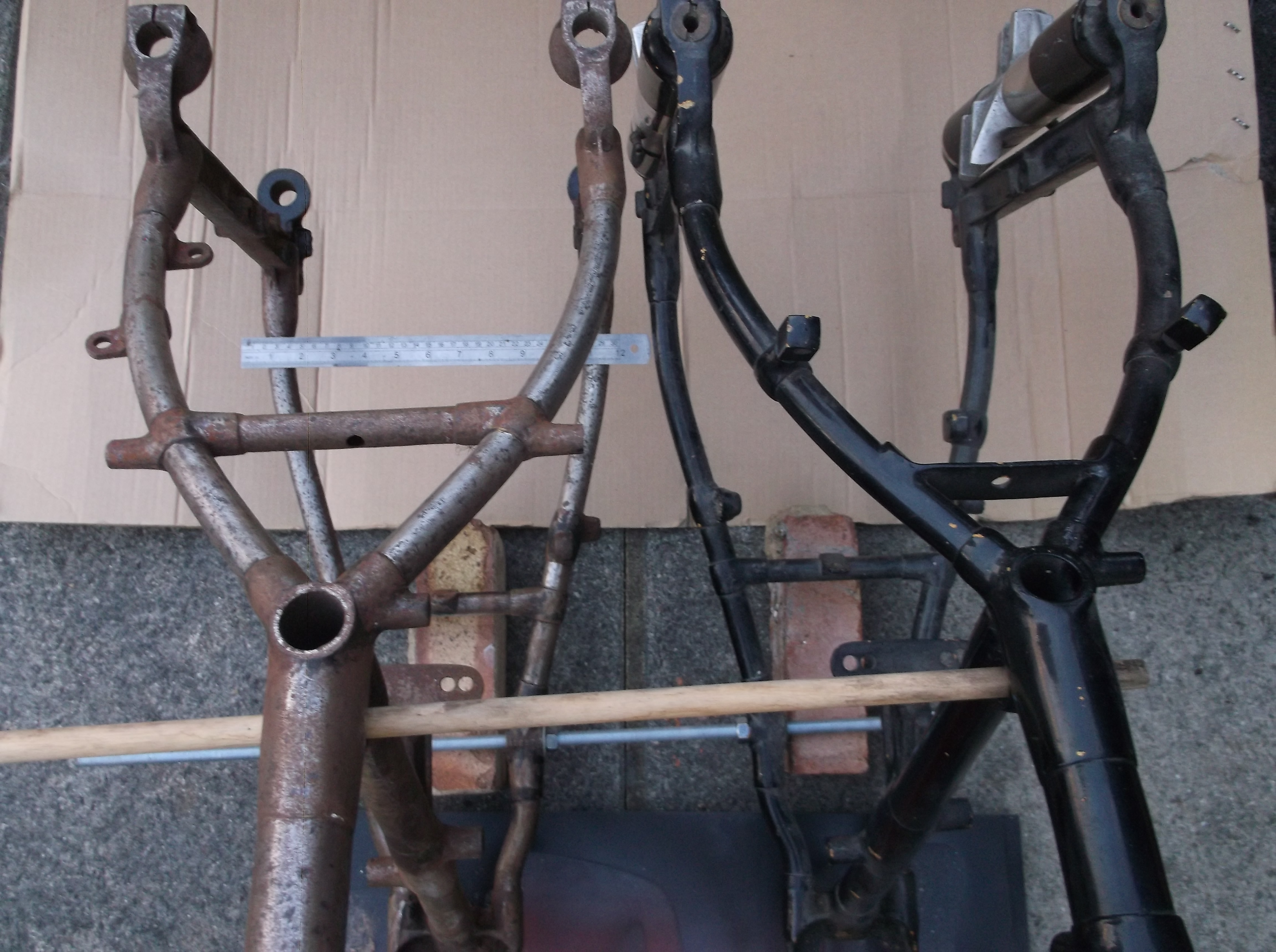

   Yes the Inter and ES2 frames are different as Michael's picture shows, but the 500cc engine will fit either and the pre-war CS1 frame was almost the same as the ES2 from 1932 to 1939. The 2 main problems with fitting an Inter engine in an ES2 frame is the downdraught carb and the clearance issues with an original petrol tank. Your frame number looks to be stamped on the front engine lug, but it should be on the front petrol tank lug, so it may have been stamped in recent years. I am attaching 2 photos of my 1939 ES2 frame and a friends 1939 Inter frame for comparison, the ES2 is front and left in the photos.

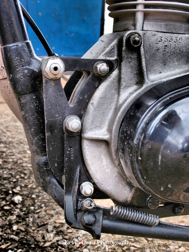

Regarding the frame number location, could you send me a picture of its location on your friends Inter frame? I found examples of Inters on the internet, where the number is stamped at the same location as on my bike, on the engine lug (see picture attached) - at least on post-war Inters like the one in the picture  (matching numbers, not the case pre-war). Maybe the location was changed fom tank lug (pre-war) to engine lug (post war)? It is of course possible that on my bike the frame had been replaced post-war, so this would have been the location were they placed the original number on a new frame ... ?

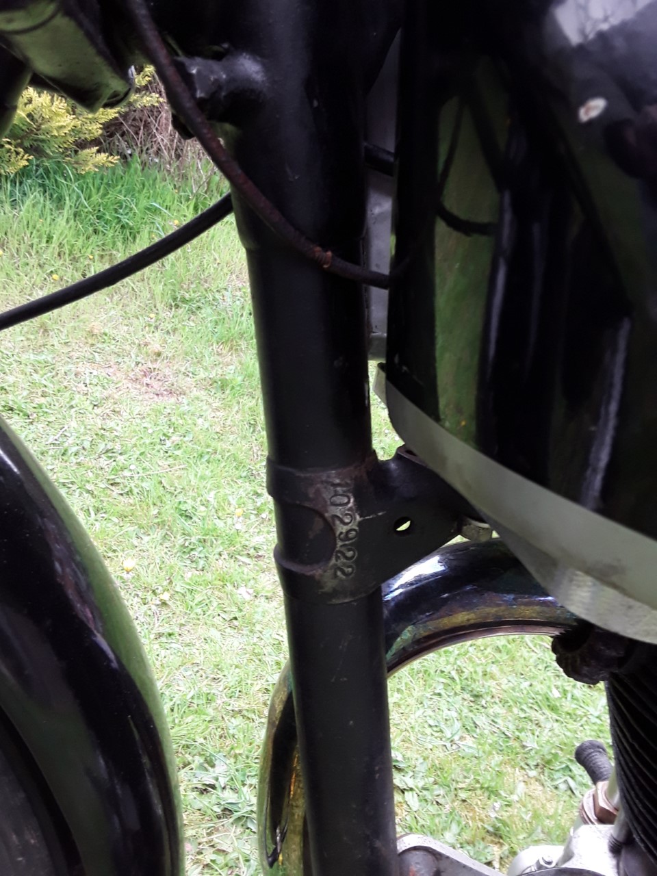

   I am attaching a picture of my 1939 Inter frame number. Over the last 45 years I have owned more than 20 Norton single cylinder type frames, both pre and post-war, and they have all had the number in the same place. I have seen numbers stamped in the same location as yours and I think they have all been racing models. It is possible this was done to indicate a replacement frame, but I have no proper evidence of this. For anyone trying to get a machine registered nowadays it is more difficult as the onus falls on the club official (Chris Streather) to verify the bike is authentic and that official could be held legally responsible for any inaccurate information. This has come about because of fraudulent registration in the past when you could find out this information and produce a Works racing machine or a sought after registration plate too easily.
