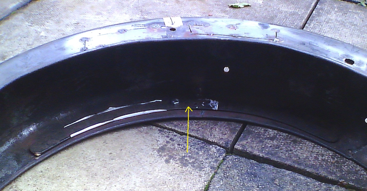

just filling in some holes that have rotted through from the support brackets that were brazed on from behind of the mudguard . does anyone know if these were fitted to all mudguards of the time or just the select few.
photo attatched
barry

i have been trying to straighten up the mudguard for a while now. just wondered if there was any reason for the strengthening brackets. i think i will just weld them back in place.
barry

There is a thread in this section headed "Norton ES2 1955 Rear Mudguard". Barry which shows the i/s having the strengtheners you show so I stand corrected.
It looks like they helped support the lifting handles each side of the mudguard - at least they did on an ES2.

i had a look at the thread .i get what you are saying, strength support for the lifting handles. its a case of my mudguard has been off the bike lying around for a while now, i am forgetting what attatches to it.
thanks,
barry

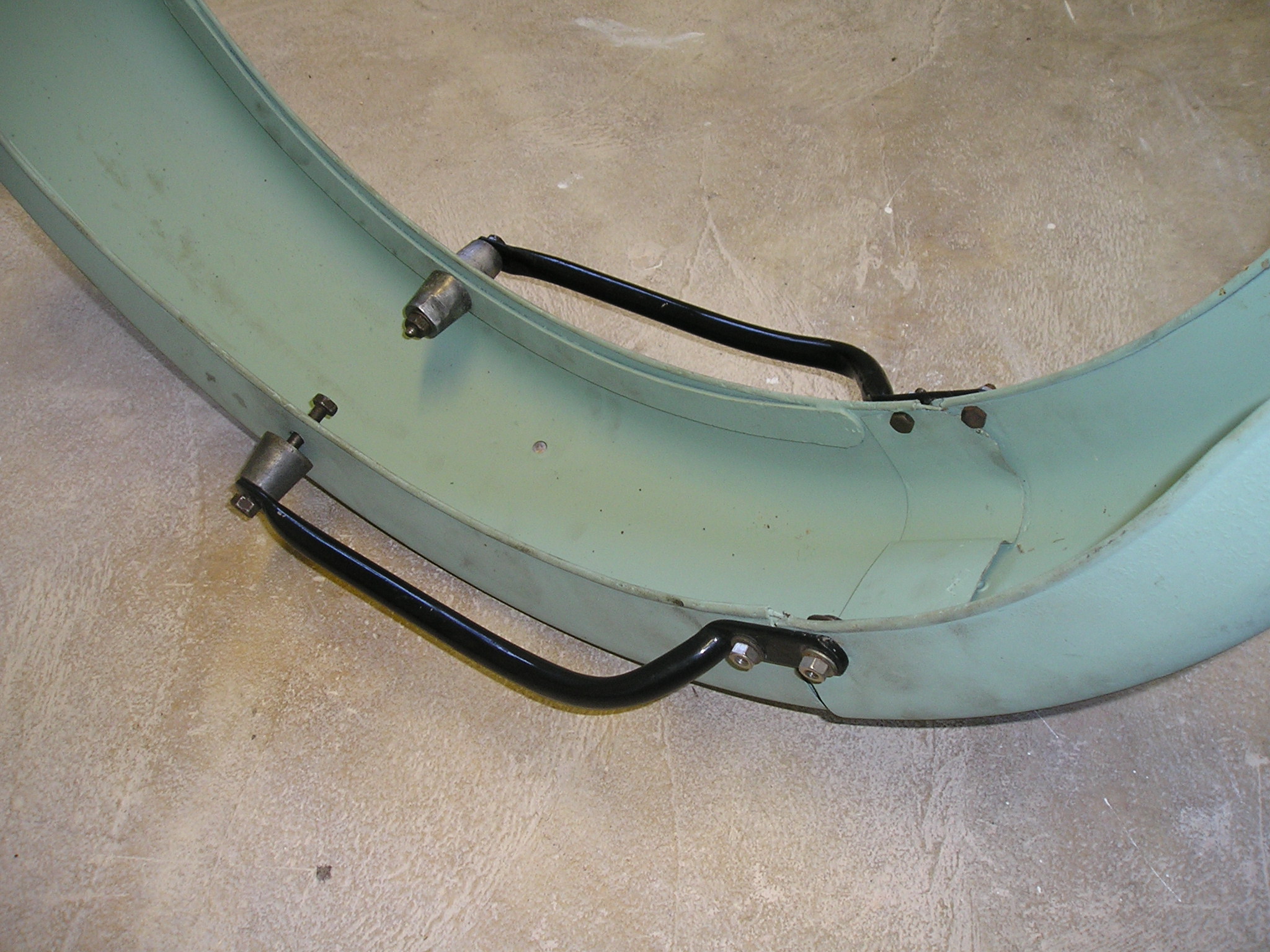

I can confirm George's message as my 1955 ES2 has these curved strengthening flat bars inside the mudguard. It would have helped support the the rear of the dual seat and given extra support for the lifting handles. Having the removable tail end of the mudguard these strengtheners would keep everything in line when the tail section was removed.
Photo attached.
Philip
