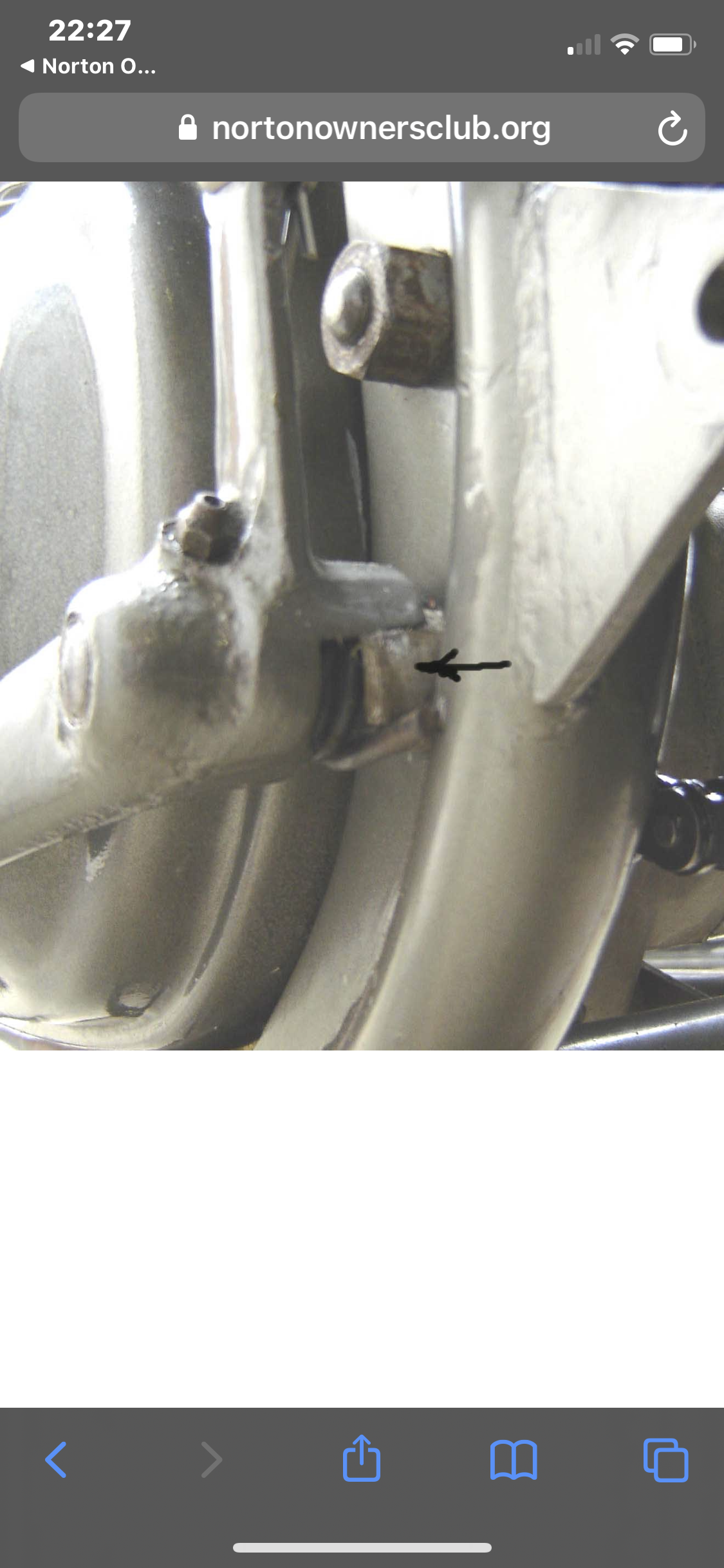

Thank you Simon so much for the picture which will be a great help to me when trying again to get this spring orientated. It would seem that I am not missing any parts so it must be a knack of manipulating the part between the stop and the rear of the pedal.

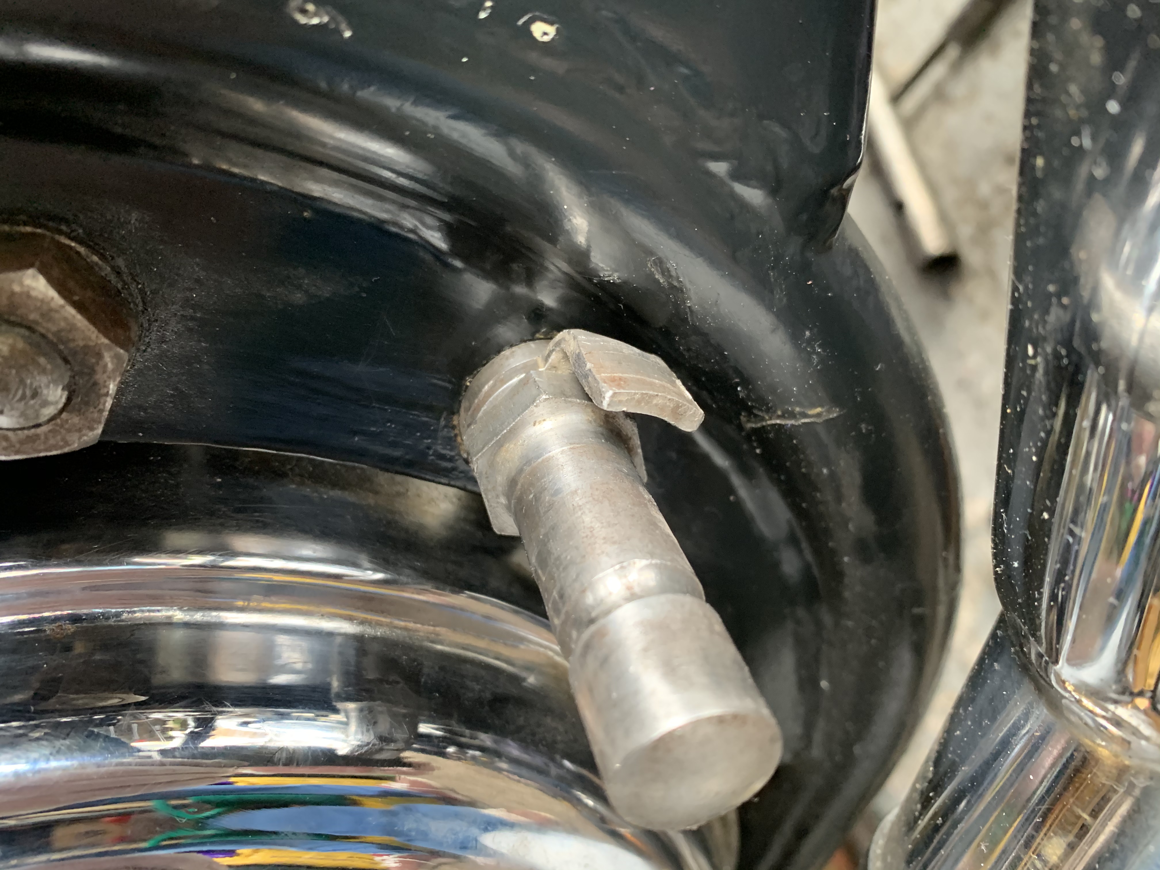

...that I made at some point was to put the washer behind the stop on the inside of the frame under the nut. Did some head scratching before I realized it went on the outside under the stop.
pivot
