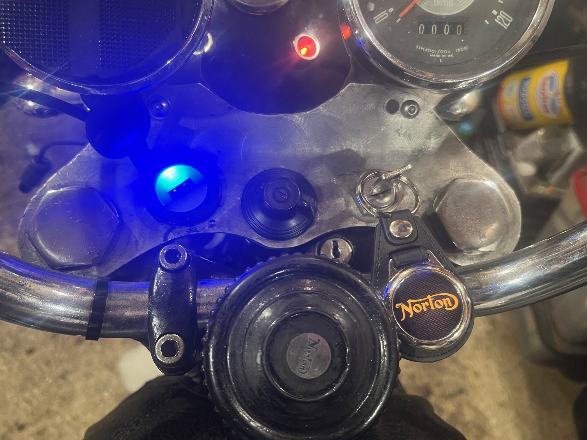

Lucas Ignition switch - positioned on the instrument bracket for easy access

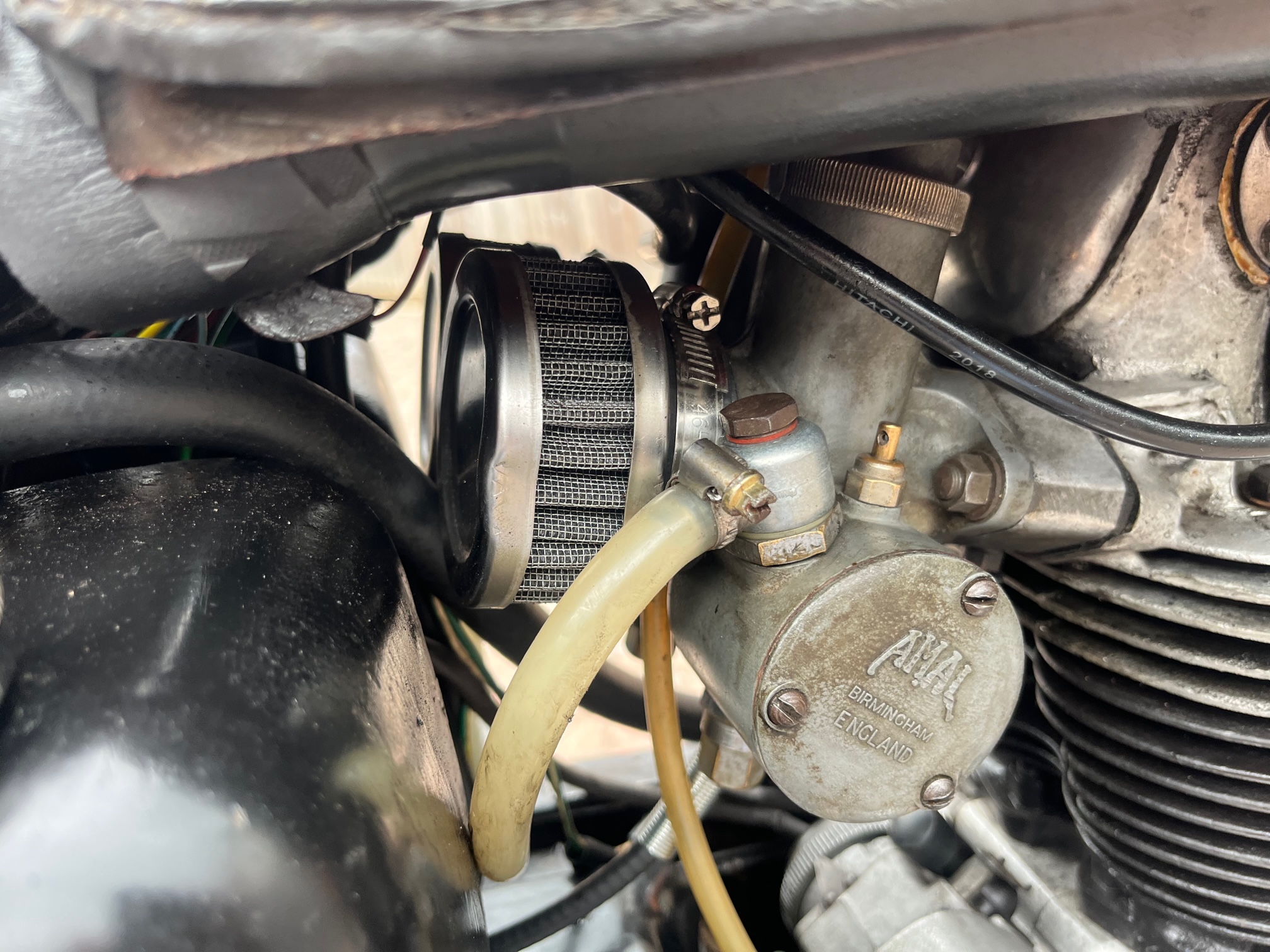

Twin air filters - Makes adjusting and balancing the carbs much easier and quicker
USB jack - positioned on the instrument bracket allowing easy connection to a phone or sat/nav. Works fine with positive earth but you have to be careful not to short out the lightning connector on the frame. It did that once and blew the main fuse!

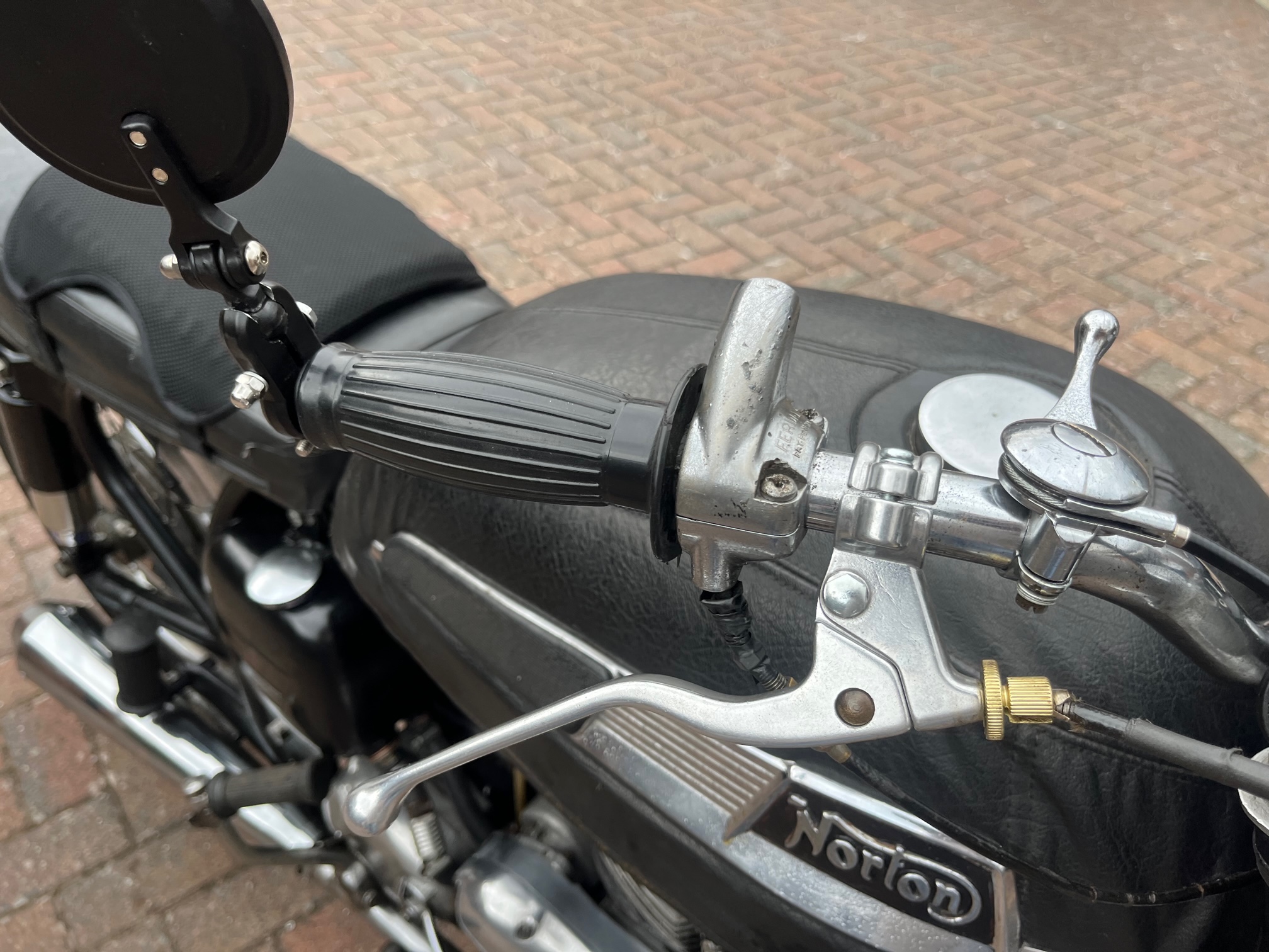

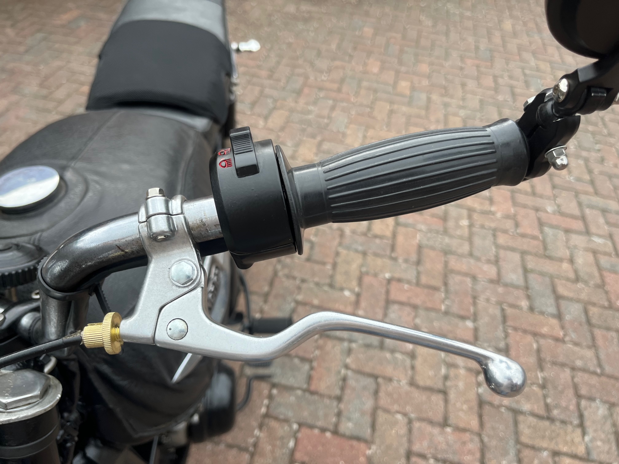

Adjustable alloy dog-leg levers - much easier to use, they look the part and have additional cable adjustment

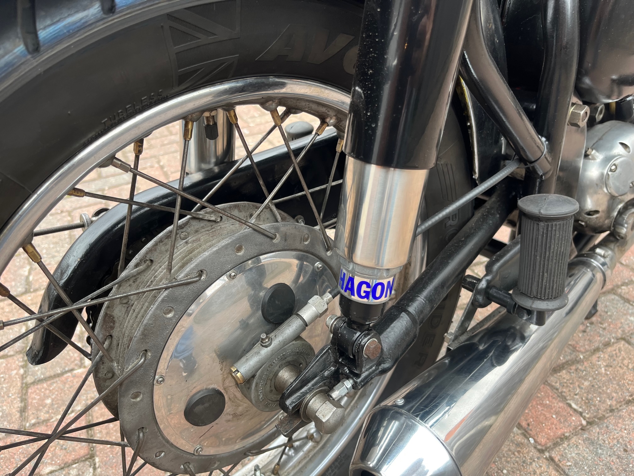

Hagon rear shocks - big improvement on the originals

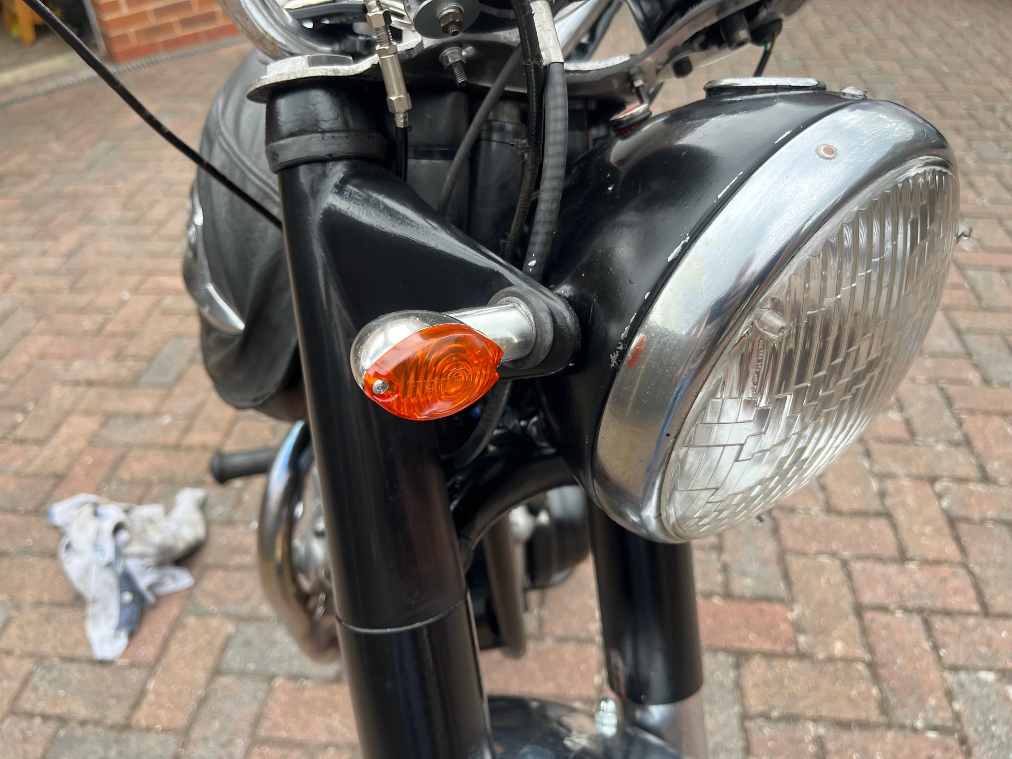

Indicators - these days they’re needed
Modern L/H Indicator/horn, lights switch - easy to use and doesn’t look out of place on a classic bike

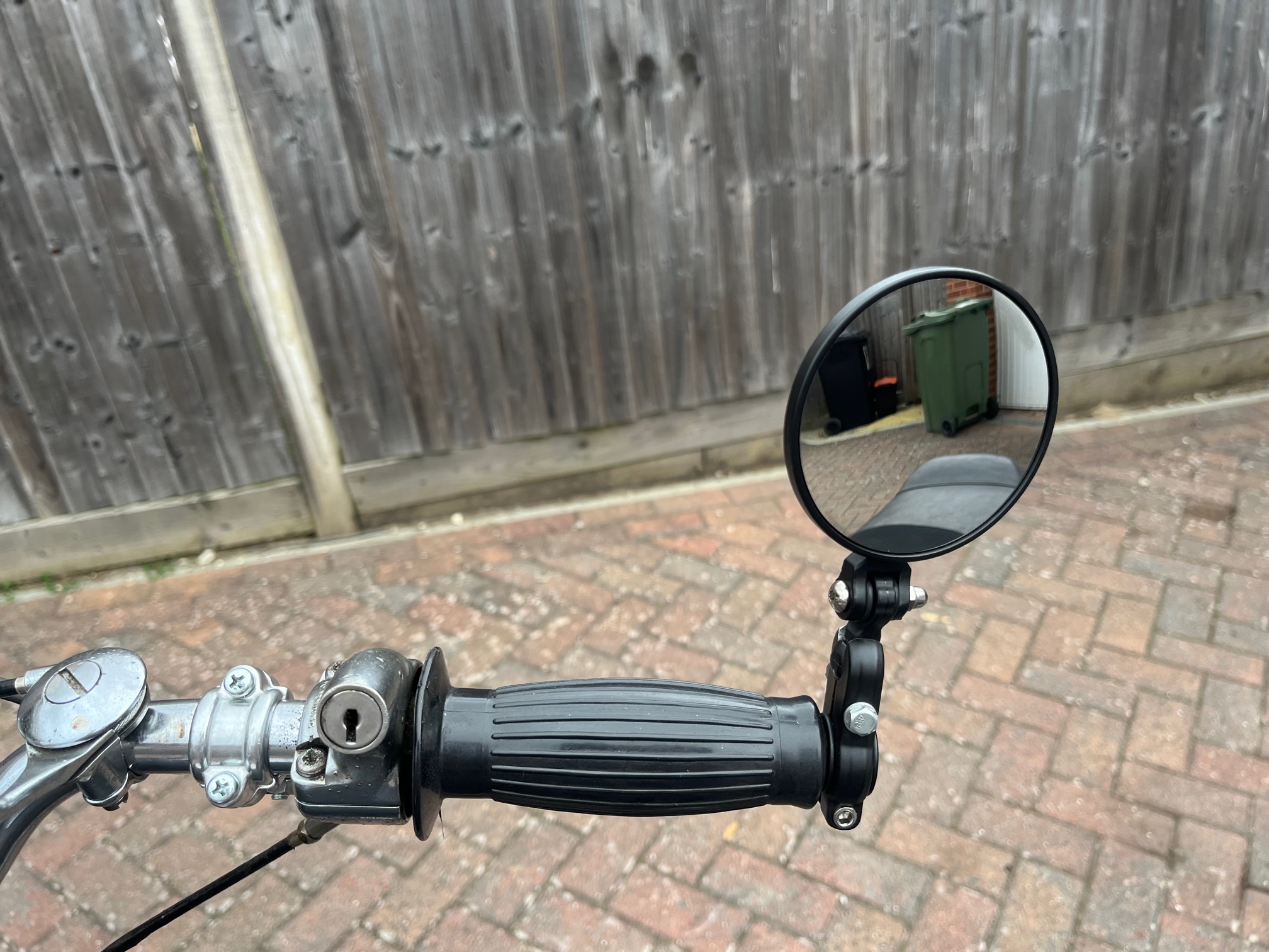

Bar end mirrors - natty little adjustable mirrors that give excellent rear vision and don’t blur much
Instrument bracket - made from alloy sheet & polycarbonate. Enables placement of the USB jack, on off lights switch and ignition switch as well as facing the tacho and speedo more towards the rider so they’re easier to see.

Brake and clutch levers look…
Brake and clutch levers look to have distance wider than 7/8” between pivot and nipple centers?. If so will work but with reduced efficiency. Hard clutch , iffy brake. Also very wide reach makes for slow response in an emergency.
Good point, but these are…
Good point, but these are dog leg levers so the lever action is less

Hi Graham, I would re…
Hi Graham, I would re-consider those levers as they are giving the cables a hard time with sharp angles that will make for heavy action and fast wear. Perhaps a slightly different handlebar will allow them to work at a better angle ?.

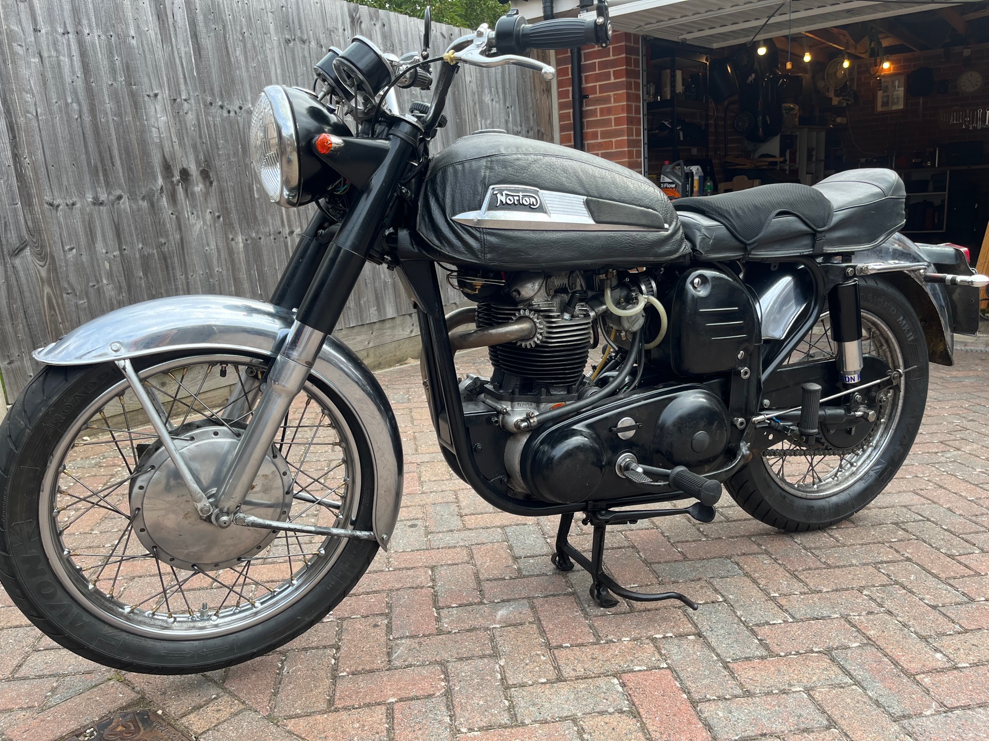

If I have read your engine number correctly this was from a large batch of Atlas models that got shipped off to Berliners in Spring 1966. The frame looks to be from a slightly earlier model.
Only suggestion to improve your bike would be to check the tension of the rear chain which looks a little tight to me. On the mainstand you need at least 3/4 to 1" of slack, otherwise the teeth on the gearbox and brake sprockets will start to get damaged.

Hi Graham, I would re-consider those levers as they are giving the cables a hard time with sharp angles that will make for heavy action and fast wear. Perhaps a slightly different handlebar will allow them to work at a better angle”
Yep- that front cable is going to fray, then break or jam. Get the basics of maintenance and safety right, before embarking on clever modifications.

Hi Graham, Sorry if we are raining on your parade !, it’s normal , there are lots of old salts here who have seen it all , but will happily give their time and experience if and when you really need it . I too have one of those mirrors with the extra elbow joint and it’s perfect in a narrow corridor folded away , Phil’s spotted the tight ? chain as I did , the last 4 bikes I worked on all had tight chains which destroy bearings and cause horrid vibrations , Norton boxes are prone to movement , well worth a regular check till it settles down , I like the tank cover and Siamese pipes , very practical, See you out there!
Bar end mirrors are the only…
Bar end mirrors are the only ones that don’t fall to bits on my vibey old twin.

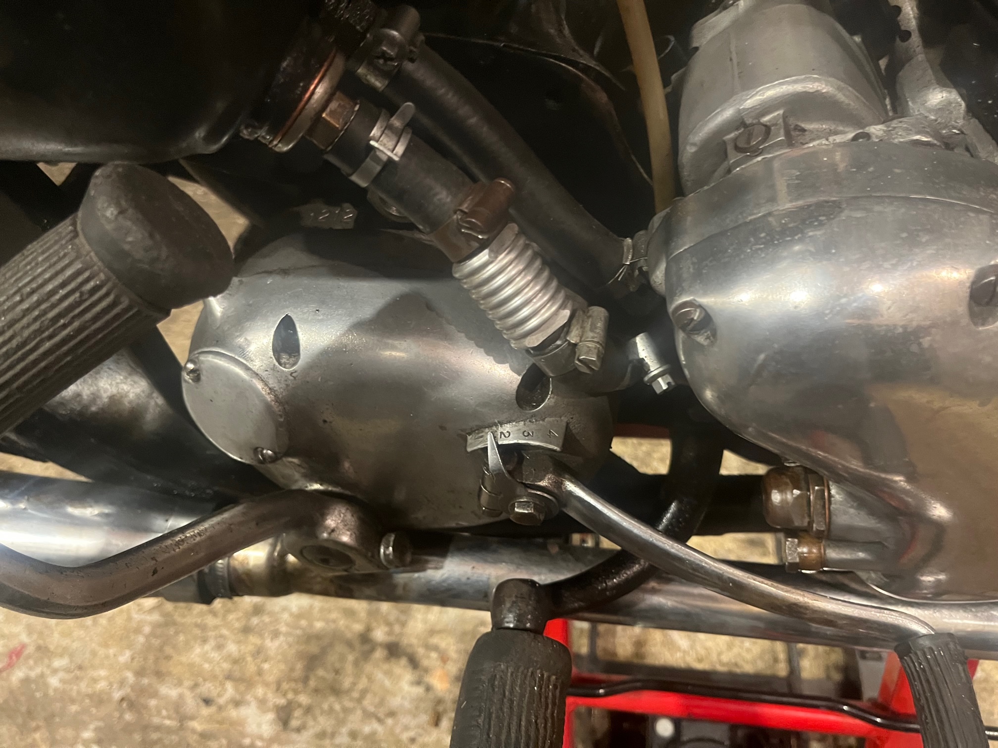

Not forgetting the footrest
The RH footrest seems low to me. Perhaps one serration up? And the other mod on my one - a single carb. Suits the lazy mechanic down to the ground. Only one choke and throttle cable, no carb balancing. Ideal.
I found setting the…
I found setting the footrests low made gearchanging difficult with proper riding boots , it did not do rear wheel braking any favours either ,. and made setting the std brake light switch unreliable . Better to put up with knees too high .An extra long (welded) gearchange lever and some raised handlebars with a sensible riding position makes it all work. .
