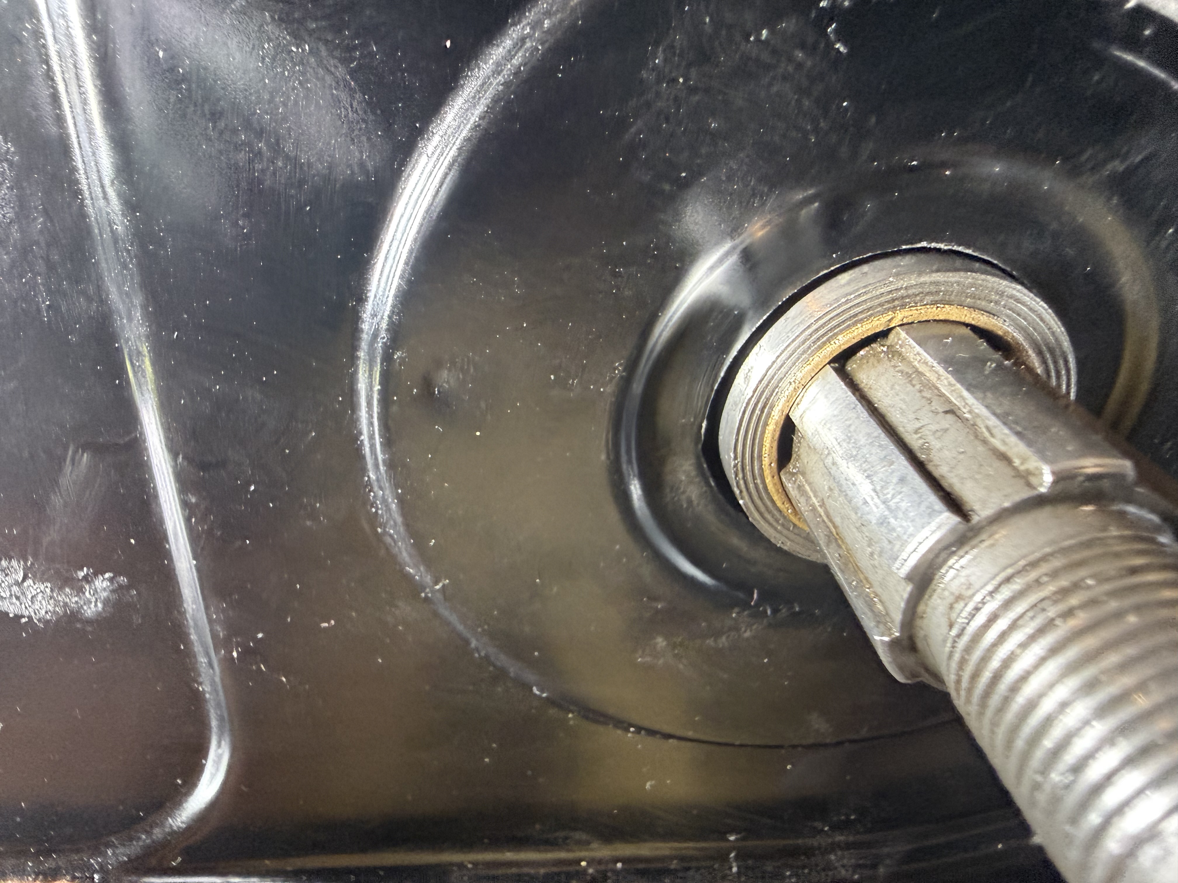

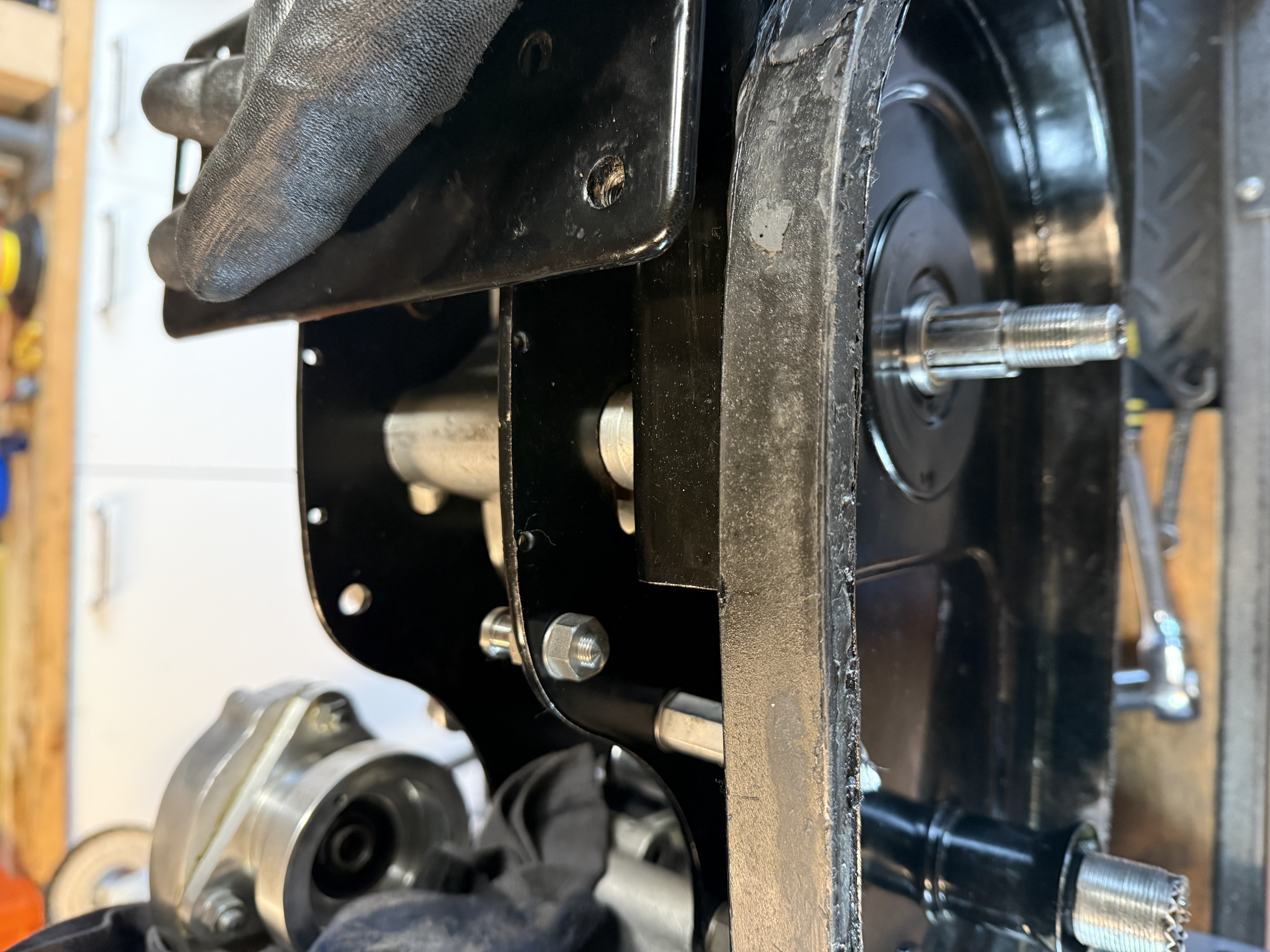

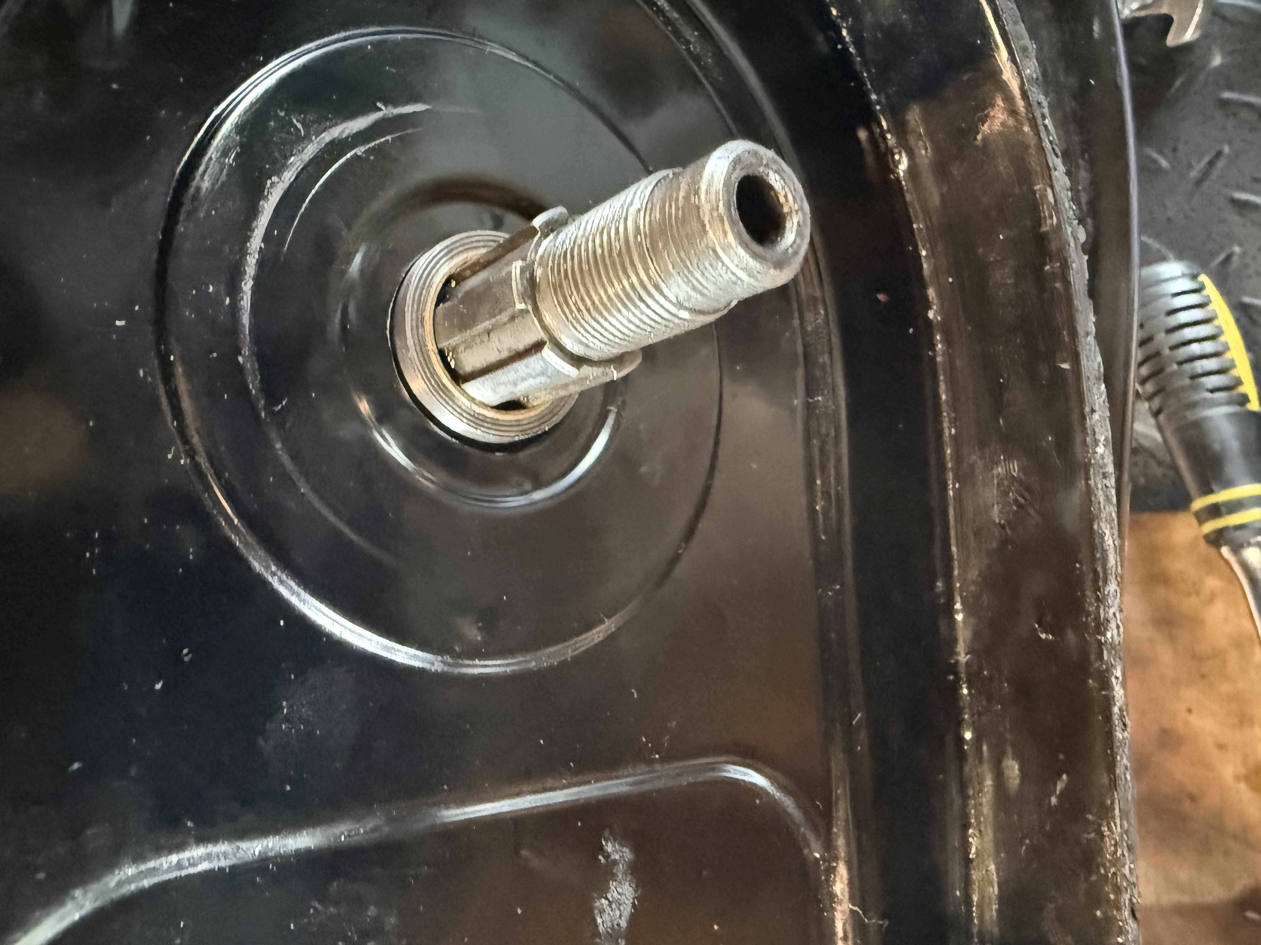

There is nothing at all like this on my chaincase. See pictures. I've been working the problem and at the moment my maximum movement fore and aft is about 1/16.
The pictures posted earlier don't seem to show this ability. My chain case is otherwise unmolested and seems in good condition. Everything else further forward lines up and the stator holder has engaged properly.

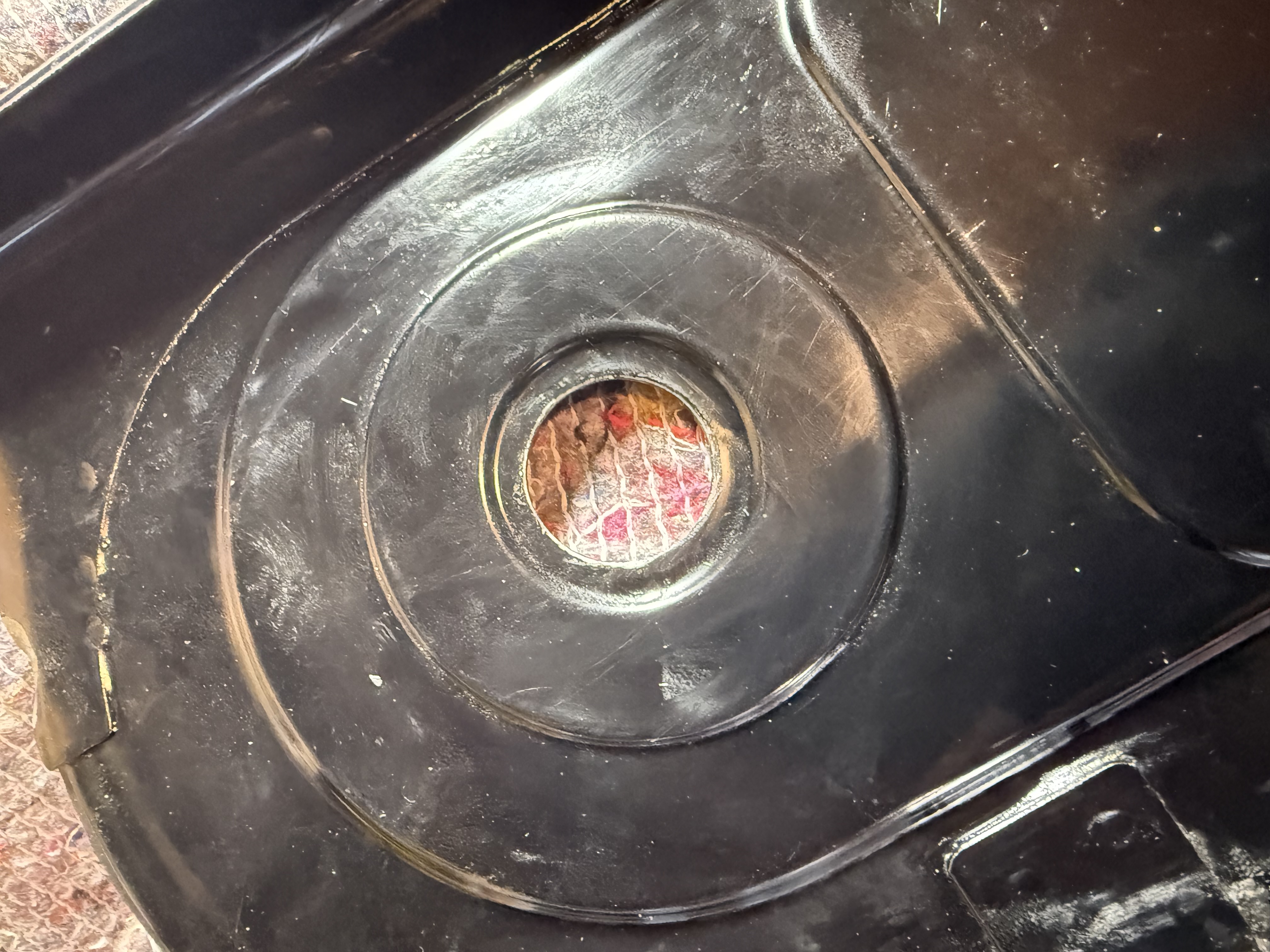

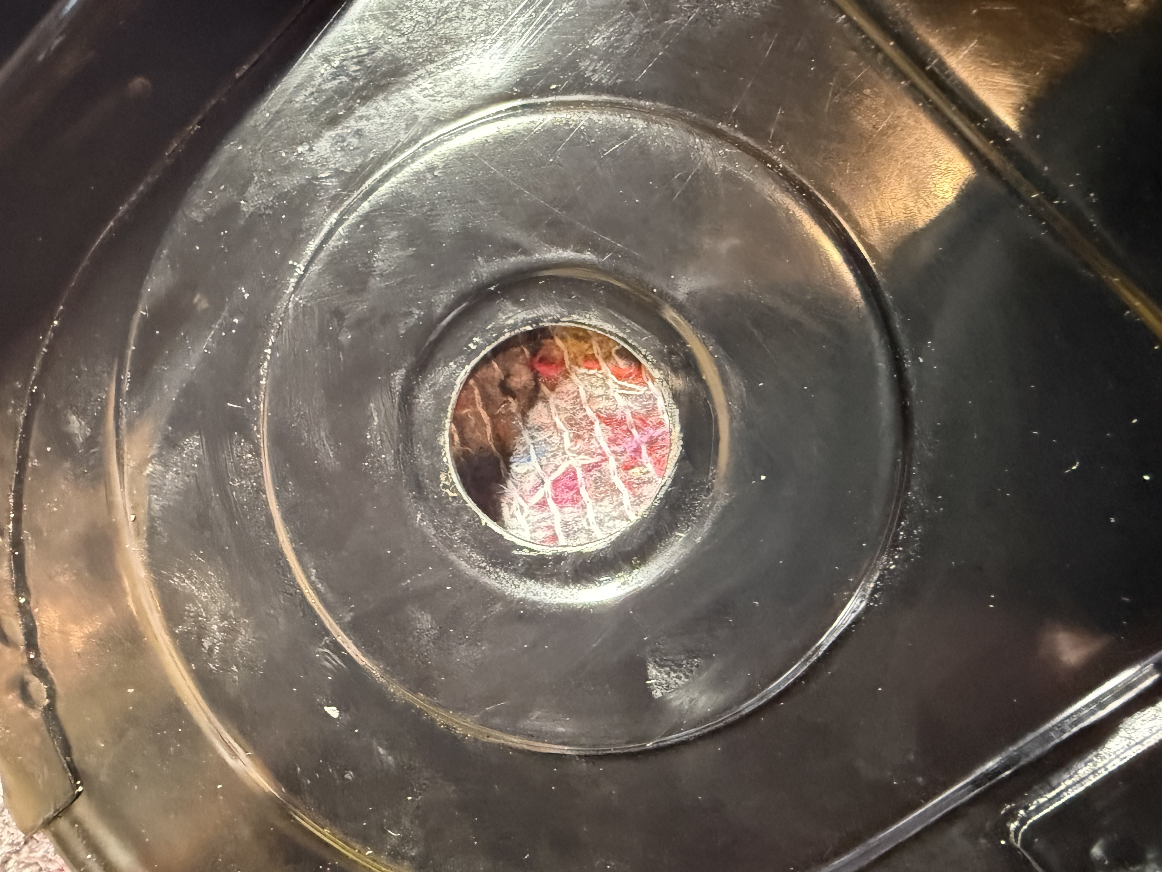

It looks to me that its been soft-soldered or silver-soldered into position. There are usually three rivets that hold both elements of the slider and felt gasket into position. You only show the inner chaincase inside element - is there another on the outside of the inner ? If so you should be able to unsolder the sliders fit a felt gasket and river it all together as good as new. If it is just paint stopping it sliding then a scalpel and small hide hammer should be top of your list for Santa. Nil problemo !! Howard

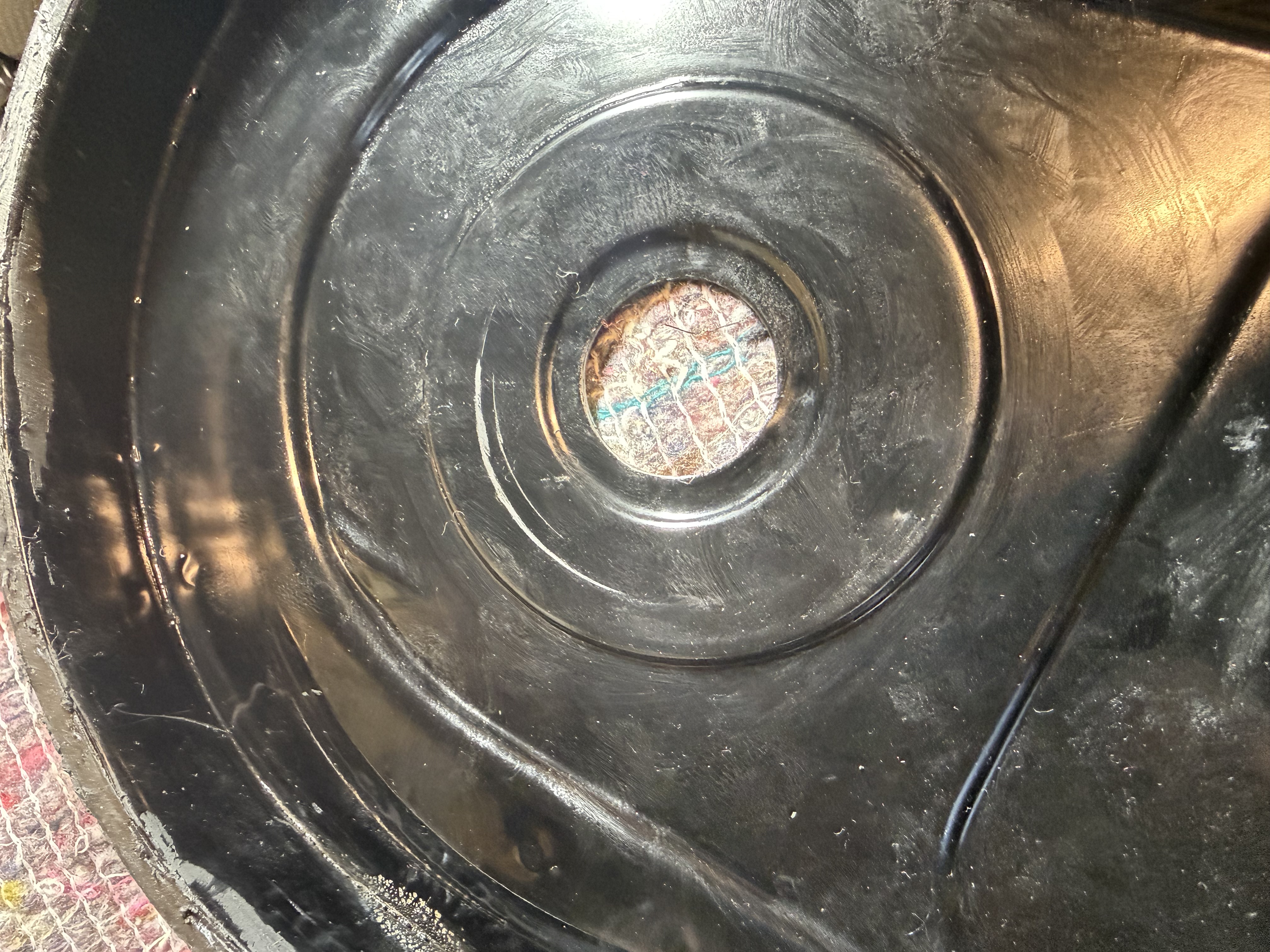

Well these are clearly a concentric set of rings. Are we saying that the inner ring should be movable? It looks like it's been painted in place. On the inner face there are four dimples or punch marks. See pics attached

It just looks to me that when the inner case was powder coated/painted, the movable part was fixed in position by the paint! It can be quite firmly in place, (don't ask me how I know!) cut round the adjustable parts with a Stanley knife (both sides) and when loosened sufficiently a sharp tap with a block of wood and hammer should free it to enable your gearbox to have its full movement.

Hello Kit - The gearbox mainshaft aperture in the primary chaincase inner cover should be able to move forwards and rearwards about 2.5 inches. So you will need to spend your effort in sorting out that anomaly. Sometimes the rivets that hold both elements of the slider together can get very tight. There is usually a felt gasket between the two elements to stop oil egressing from the chaincase and it can get hard and stiff with standing unused. good luck, Howard
