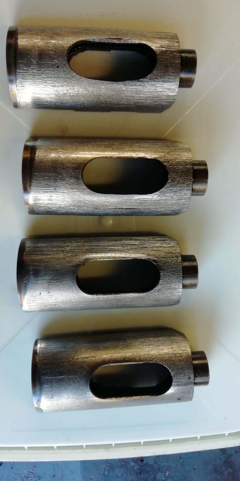

Restoring a 1973 850 mk1 Commando and have just had tunnels with local engineer rebored with +020 which I bought from andover. The cam followers were badly scored as were the tunnels probably grit left in there from previous rebuild shame as the cam follower tips were like new.
Does scoring really matter? They don't have much side thrust, and the oil from the head has to run down somehow.
You can recover scored undersized pistons by having them coated, worth keeping those followers in case you need another set.
Probably casting sand left in the followers from new (See NOC Service Notes).  I can remember picking sand out from inside new followers with an old scriber...
The alternative to casting sand is that someone decided that they had found a use for the coarse end of the grinding paste tin when lapping new followers in !
I had similar issues with mine years ago, caused by a PO leaving blasting media inside the crankcases, after having them blasted to look pretty. A wire brush can make them look just as good without the risk. It wasn't just the followers, but the bores, pistons, big end & main bearings, crankshaft journals, camshafts, camshaft bushes, valves & guides, oil pump; get the picture? If it is caused by casting sand, it would have been dragged through the whole engine, not just confined to the follower tunnels.
