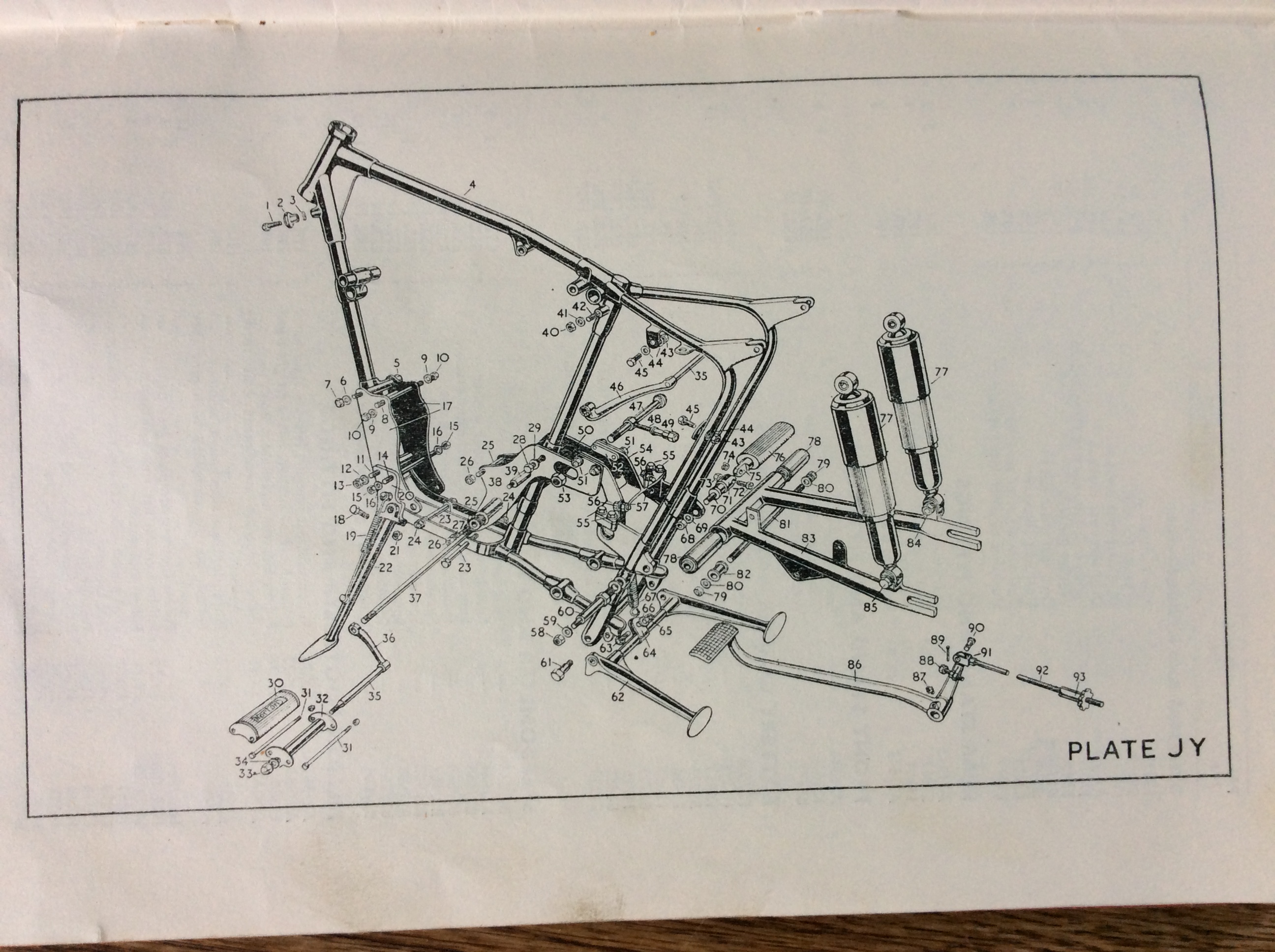

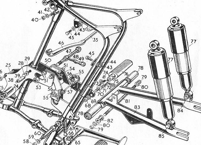

Dave Rademacher here in Minnesota. I've had my bike a number of years but am still a rookie asking questions and trying to learn. The bike is a 1954 Norton Big 4. All that said it was orderedan delivered to Vienna Austria with a swinging arm suspension. I am in the process of installing a Watsonian Palma on the left side. I have found some issues that need to be addressed. I have found a frame photo on Andover Norton with some description numbers but no factory numbers. Also it does not seem that they stock the parts. I have tried to post the bike photo and the frame photo, I hope it worked.
The parts from the photo I am looking for are, Numbers 51-52-55 and the bolts, nuts and washers for the top of the shock absorber. Also this photo from Andover Norton is great but my question is where can I get the rest of the information that goes with the photos. I have I have the blue spare parts book but the frame and details is not in it.
Am I mistaken or is this a ES2 frame with a big 4 motor and trans?? Again I apologize for my lack of knowledge.

Hi Dave,
what an interesting bike, do the frame and engine numbers match?, yes I would imagine that the cycle parts are straight from the contemporary ES2/19S and that you should get the parts book for the 1955 models of those to get the part numbers.
Re parts availability, I would imagine it is going to be Ebay or get somebody in the club to photograph and measure them for you. Molnar stainless in Preston, Lancs., www.manx.co.uk used to make some stainless parts for the pre-featherbed s/a models, it may be worth trying them, also https://racingnorton.co.uk/.
Good luck, and please keep us posted.
