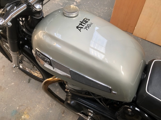

Hi John,

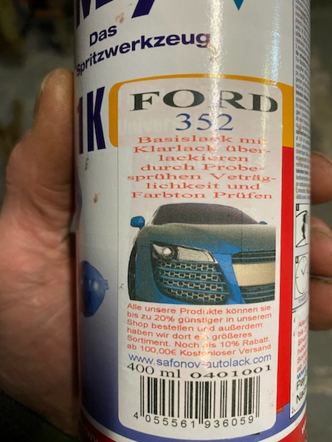

(Mark - I replied with this also to your post…). I sprayed my 1963 Atlas last year using the Ford Silver Fox equivalent. I found a rattlecan version on ebay, a base coat and a 2k clear coat, made by Safonov Autolacke in Germany. Their website is on one of the photos. I assume XSC352 or 352 is the code.
SprayMax 2K Set 800 ml Originallack FORD EUROPE XSC352 SILVER FOX MET. 1966-1971
Ford recently launched a new Silver Fox, which is a flat, non-metallic grey, code JQQLXWA, which is now stocked by many suppliers and can lead to confusion! Be careful not to end up with this one…

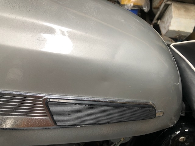

The rattle can kit was very easy to use and sufficient for one tank; the 2K clear coat also makes the paint E10 petrol proof. A few photos of the tank attached, hope this helps,
Holger
