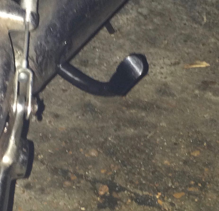

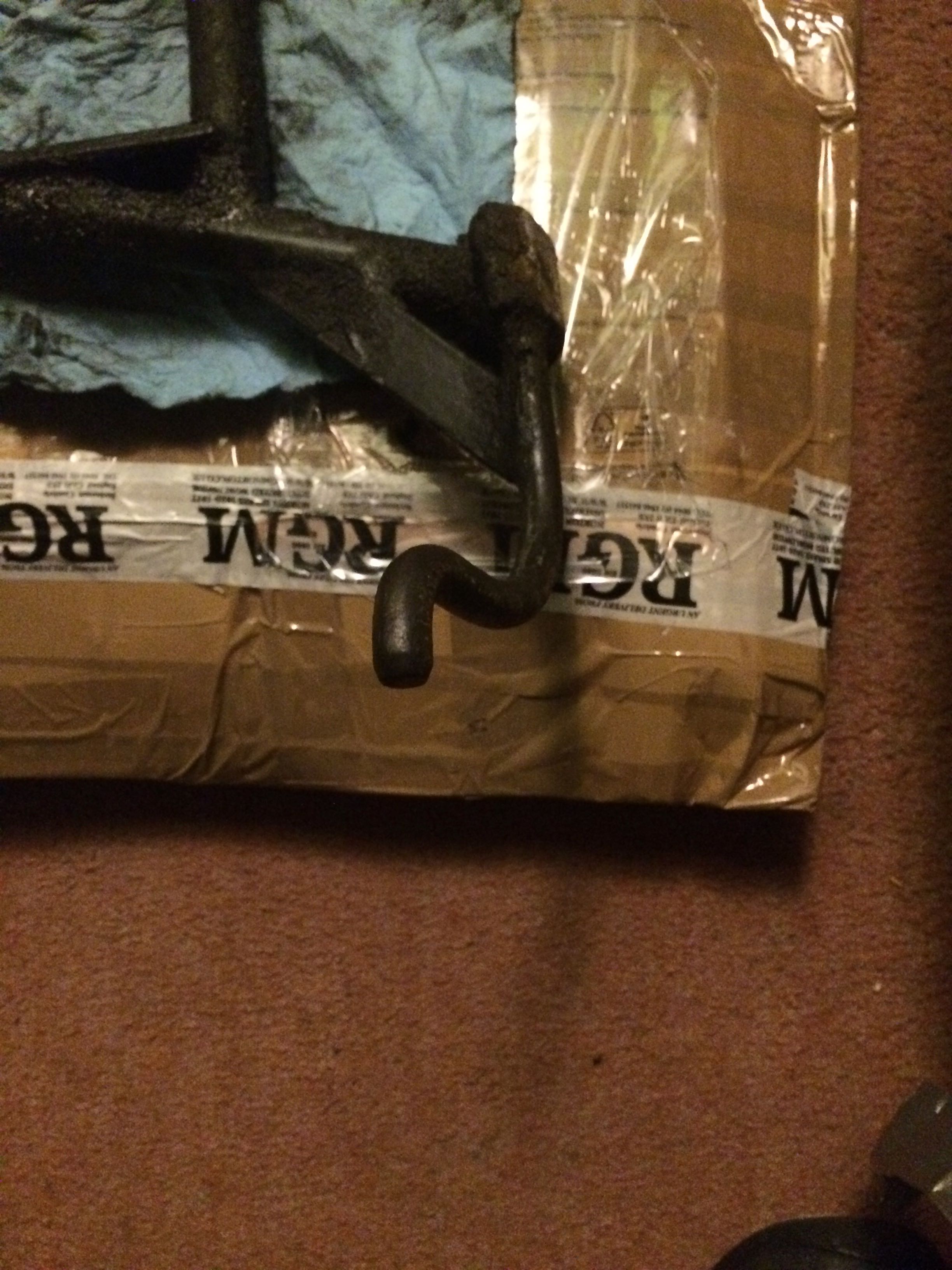

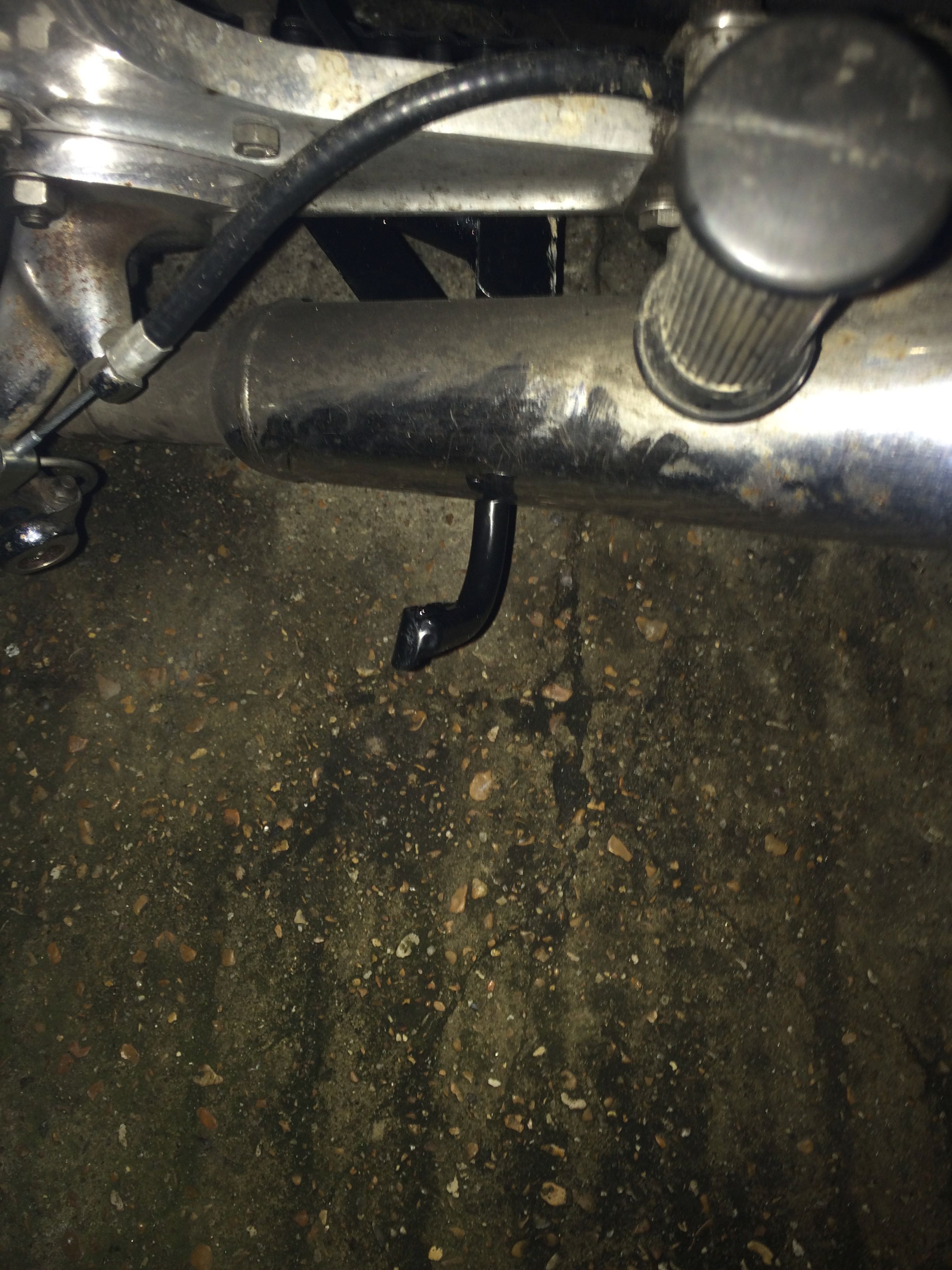

I think whoever designed the centre stand currently available from AN and RGM â they look the same to me, and may be available elsewhere â was either wearing wooden clogs when they tried it, or didn't try it at all. I find one I just bought from RGM painful to use, whereas the original wasn't the slightest bit uncomfortable, assuming you were wearing reasonably sensible footwear. I'm grateful that this part is available for my 43-year-old bike, but it shouldn't hurt.

Ow, I bet that hurt! I would agree that decent bike boots stop most of the 'ow factor', reducing it to a mild impression, but, as Allan's experience suggests, we aren't always about to hop on our bikes when we move them. Compare these two further images for the difference in design, and consider how one spreads pressure on the foot while the other focuses it.

Hi Colin,
The stand you show in the 'Replacement' pictures is correct for the 850 MkIII.
The one you show as OE is correct for earlier models.
So the designer is Norton !
Interesting Tony, so it is! Not having a MK3 handy, I just checked my copy of 'The Powerchoice' poster for that and the T160, the MK3's centre stand tang is clearly visible. Do you have a MK3, Tony? Now I'm wondering how MK3 owners get along with their centre stands. I've had to change my approach to only using my right foot to hold the tang down, while putting pressure on my left foot, on the ground, and pulling the bike backwards, only doing a little lifting.
Even so it's the only design of tang offered by AN or, as far as I can tell, RGM for my MK2A. Other stands offered by AN have the same design, apart from the (currently) unavailable stand for engine numbers below 141783. So nothing's changed about this issue for me!
