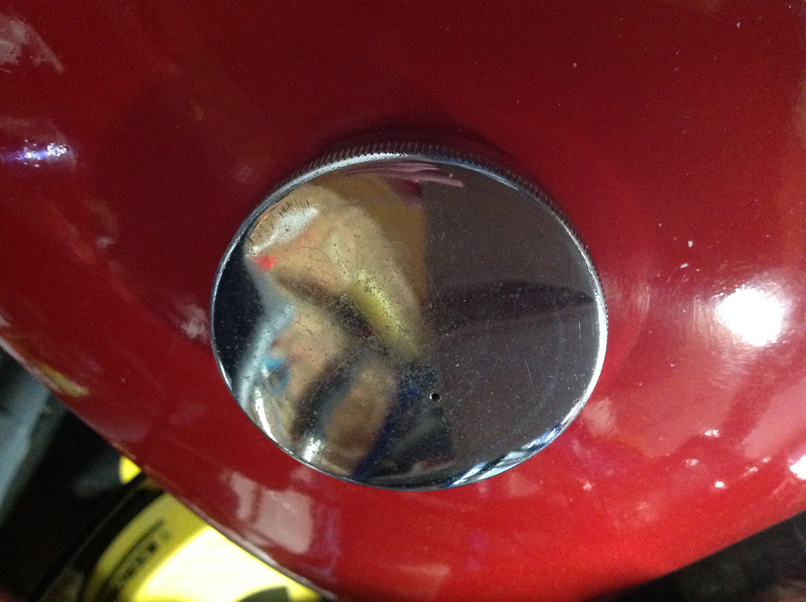

Just wanted to ask whether anyone has experienced petrol fumes in an integral garage. As you may gather from the above, I am making efforts to set up the carburettor. I had purchased a gasket kit from NOC but I found these lacking in some respects. The vital gasket on the float chamber broke as the holes were slightly adrift and the main jet gasket washer was too big. Anyway, this meant that I had petrol leaking out from two different places and I decided in the end to send off for a gasket set from Amal. I had no choice but to drain the float chamber and the rest of the carb for now. However, despite having the tank tap in the off position and with no leaks on the fuel pipe I am still getting a strong smell of petrol from the bike. I have now drained the tank to try and improve things but fumes are 'wafting' through the walls and ceiling into other parts of the house. As you can't imagine me and the Jubilee are not popular. I have attached a picture of the petrol tank cap which I assume is fairly standard. Are there any bright ideas out there please?

The hole in the cap is a permanent breather, put some tape over and see how the house smells a few days later. If the tape confirms its the cap breather then use tape when in the garage, if you forget to take the tape off before riding you will not get far.

Sounds a good idea. I shall disappear forthwith and tape over the hole. I have had a good 'sniff' around the carb etc and cannot detect any smells so the tank is my last resort.

Dear John. Followed your advice and used some thick tape to cover the fuel cap vent. This has certainly reduced the smell which is great news and I appreciate your wise words. Many thanks Ian
If you move the machine around you can create a pressure of petrol vapour in the tank ,so its a good idea to remove the tape till it settles. Same thing if there is a sudden  large temperature variation.  I also tape over to avoid moisture gathering in the tank over winter.
... I've never had any smell of petrol from the breather in a tank cap of any bike I've had in 60 years. Or maybe my sense of smell has been diminished over the years.....
.... with Ian S.  My garage is full of bikes and doesn't smell of petrol.  That is until a leak develops as happened recently with an ancient "Petroflex" pipe that was clearly past its sell by date.
If the smell persists I would be looking for leaks rather than blocking the tank vent.
I have now ordered a new gasket set from Amal and can be confident that the holes and sizing etc will be spot on. I shall make sure that all the seals on the carb. work as they should and then try again. Good point about the pressure building up in the tank with the vent taped over. Similar to my plastic petrol can which can sometimes bulge and 'hiss' when you open the cap.
I'd be looking for vapour paths from garage to house before anything else. And I don't even like candles on the mantelpiece.  Some of my bikes sometimes smell. I like to empty the float chambers before leaving them (although often don't).  I don't rely on the float sealing for a long time without turning off the tap.  Small leaks can often be sealed by rubbing them with a bar of soap. Handy to know in an emergency.
