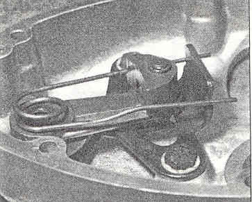

This spring can be a real pain, in the AMC gearbox, as in order to work correctly it must have the correct shape and just touch the floating crescent shaped selector pawl.  See attachment.

The return spring is almost immediately belhind the selector spring and returns the selector pawl back to the neutral position. See attachment which shows the 2 springs from the inside looking towards the outer cover.
If this section of the gearbox has not been correctly assembled then the return spring can get wedged open by the large washer that holds it in place. Especially if the large washer has been replaced by a much thicker item. The same problem will happen if the spring is cracked or broken.
The selector spring must be exactly the right shape so that it just touches the sides of the pawl. while each leg passes through the slots of the bracket.

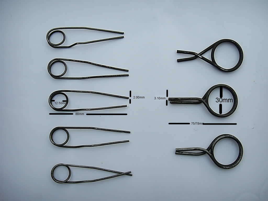

The second attachment shows a bundle of gearbox springs sold to me as suitable for an AMC gearbox. More than half would probably not work.

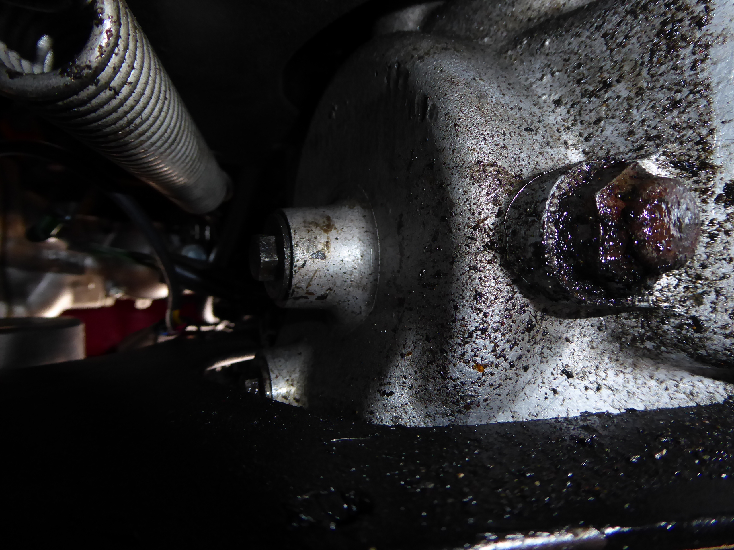

Roger.......you should be able to both see and access the quadrant and camplate nuts from underneath..A cranked ring spanner on the camplate nut will probably be the easiest to turn.

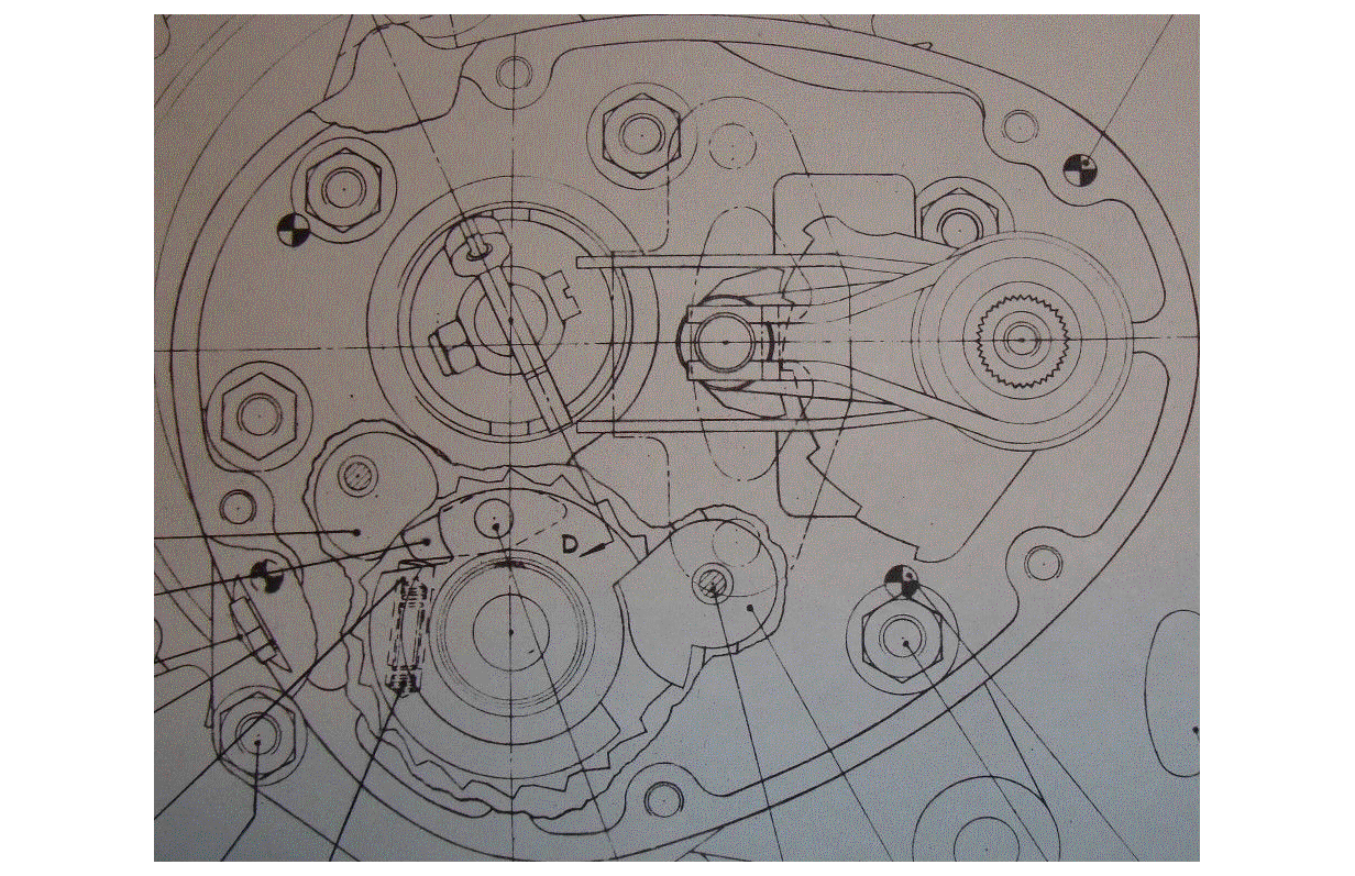

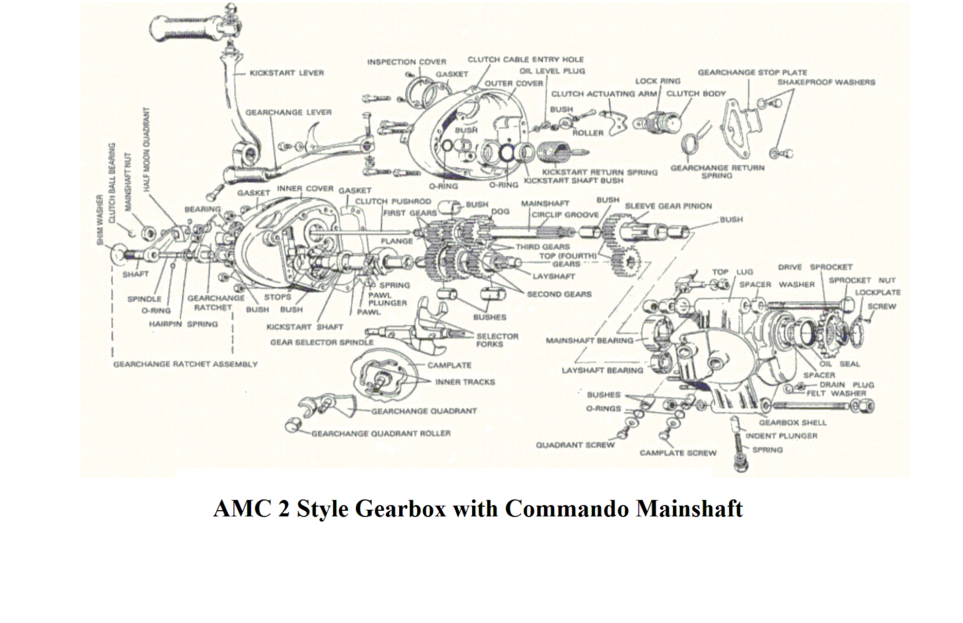

See photos of Commando gearbox diagram and my gearbox in frame. The 650 and Commando gearboxes share many components.
