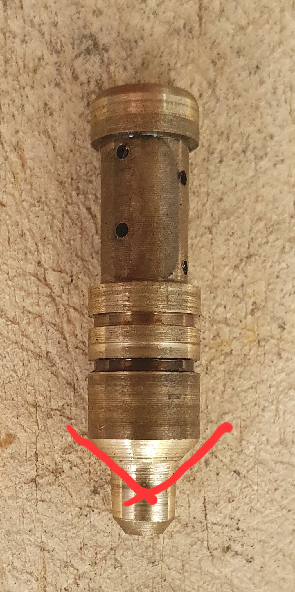

Thanks for the ideas Jon. I've just been inspecting.  The rear oil feed has been opened and closed and doesn't seem to be the issue.  But the quill tip is worn back.  It's feed hole is about right..that is until  I turned the tip off! A new one is on order.

Is that your centre feed oil quill? Looks like a crank one…   Is this on the 34 inter?  Could this be. Your over oiling issue you mentioned in previous posts?

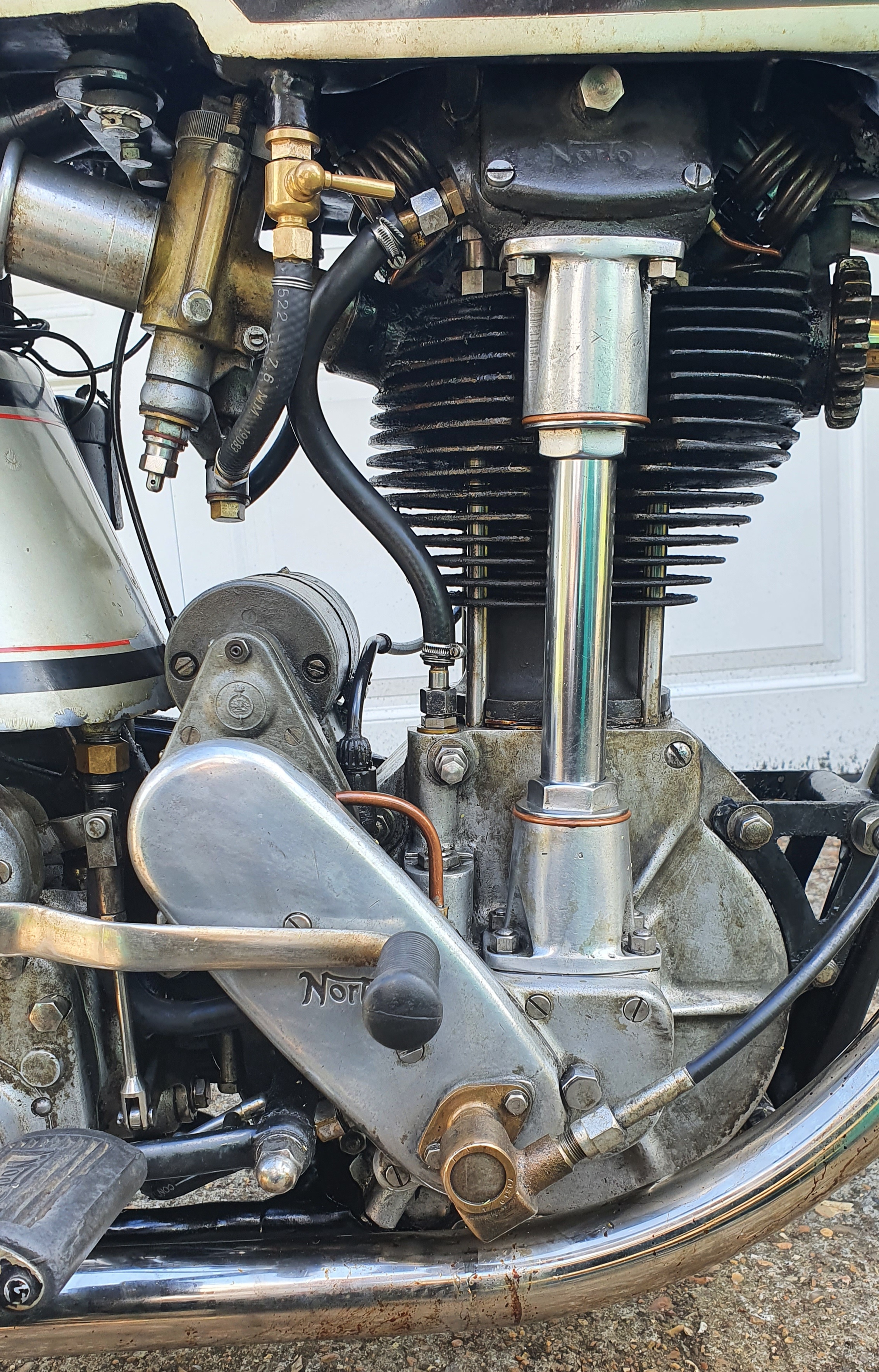

Be interested in some more pictures of the top end if possible. Must be one of the first inters?

It has a 1932 engine. But lots of later mods. Hairpins, magnesium cambox  centre feed.  The quill in the picture is the same as Paul Norman sells.. or it should be!  Early features are the horizontal exit for the drive side crankcase breather. That was redirected upwards very soon, otherwise it exits into the later oil bath chaincase.
The carb is an early TT version, which has a wider splayed inlet to suit a shorter, wider inlet trumpet.  Previous owner fitted a much longer one.

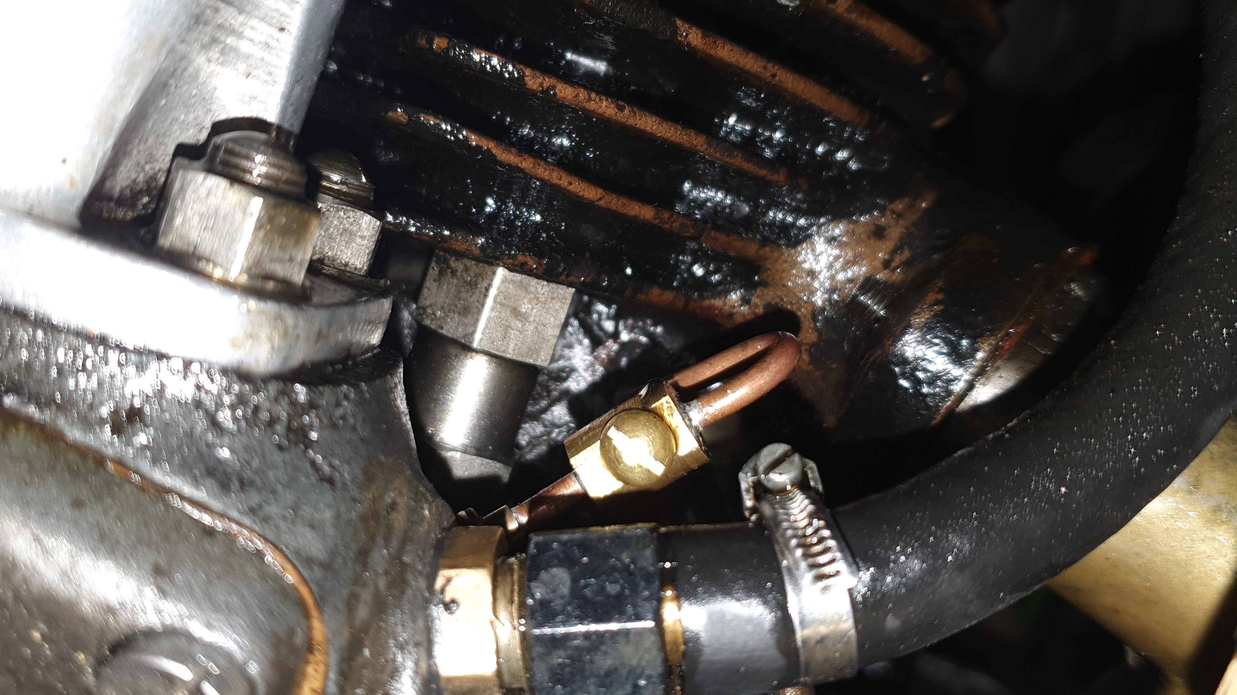

Update...smoke free at last!  The problem was (is?) excess oil draining down through the valve guide lubricator feed pipes. I added miniature valves to allow me to switch off the oiling at the roadside.  Close the valve (slot in screw across the pipe line) and the smoke vanishes.
Now of course I have to decide how much oil it needs. I can re-drill the screw with smaller hole.  It's not easy to simply turn it half off...because I can't see inside it.

David, that’s a rather neat idea. I can’t help thinking that you have a particularly healthy oil supply to the top end.  The picture shows a motor that has seen a lot of oil seepage.

I put a gauge on it and it varied from about 7 to 12psi.  I have had leaks and recently changed the seals. It's a lot better now.. but castor based oil leaves an almost permanent mess...
