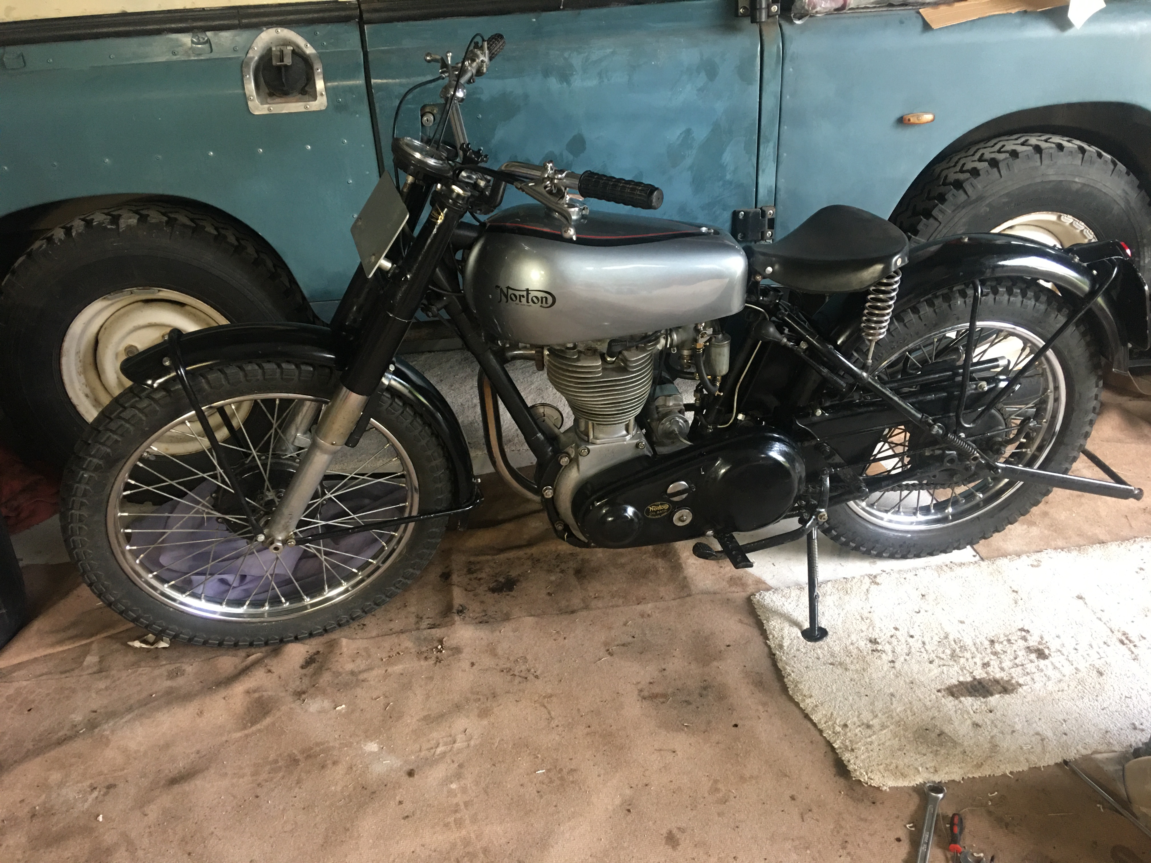

First post on the Forum. Does anyone have a Norton 500T side stand for sale? Alternatively does anyne near Preston Lancashire have a bike I could look at and perhaps make one if I cannot find one?

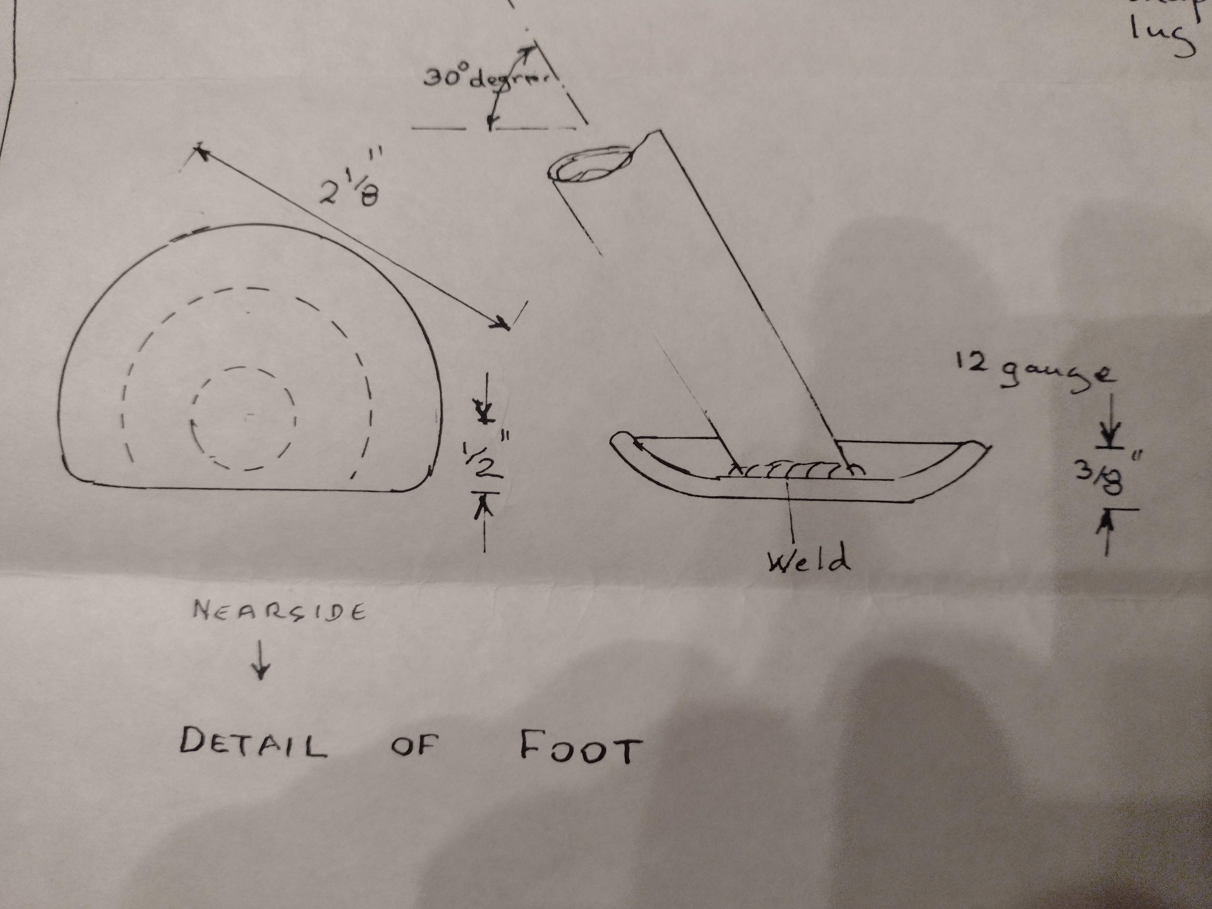

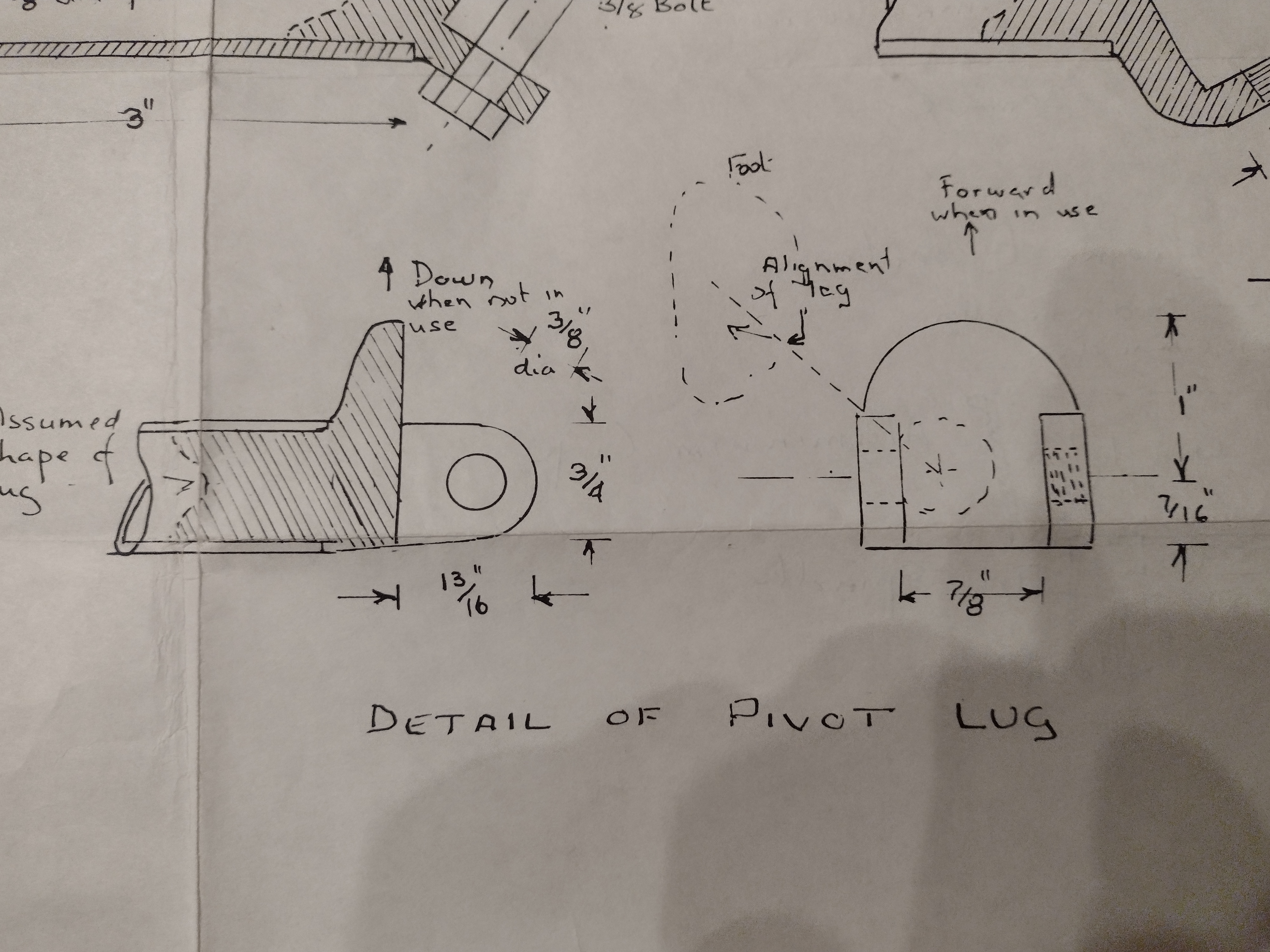

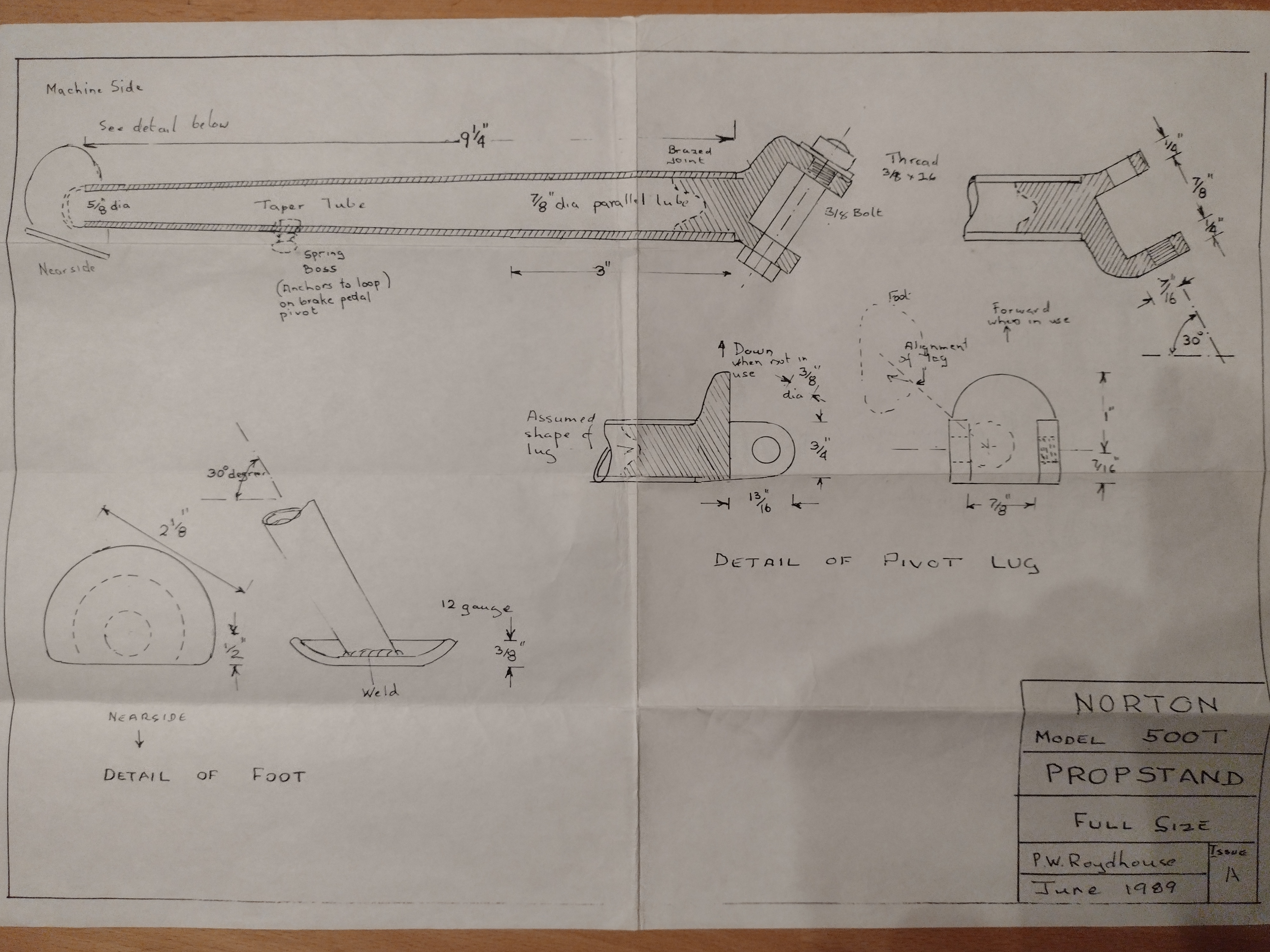

I could support You with an technical drawing of the original sidestand I got from peter Roydhouse, so You would be able to build an exact replica. If You are interested please let me know.

That would be wonderful if you could supply a drawing so we could make a new stand.

Found it at least, so here You go. A pic of the whole drawing and extra pics of the details.
Hope it is useful to You and good luck in making the prop stand!
