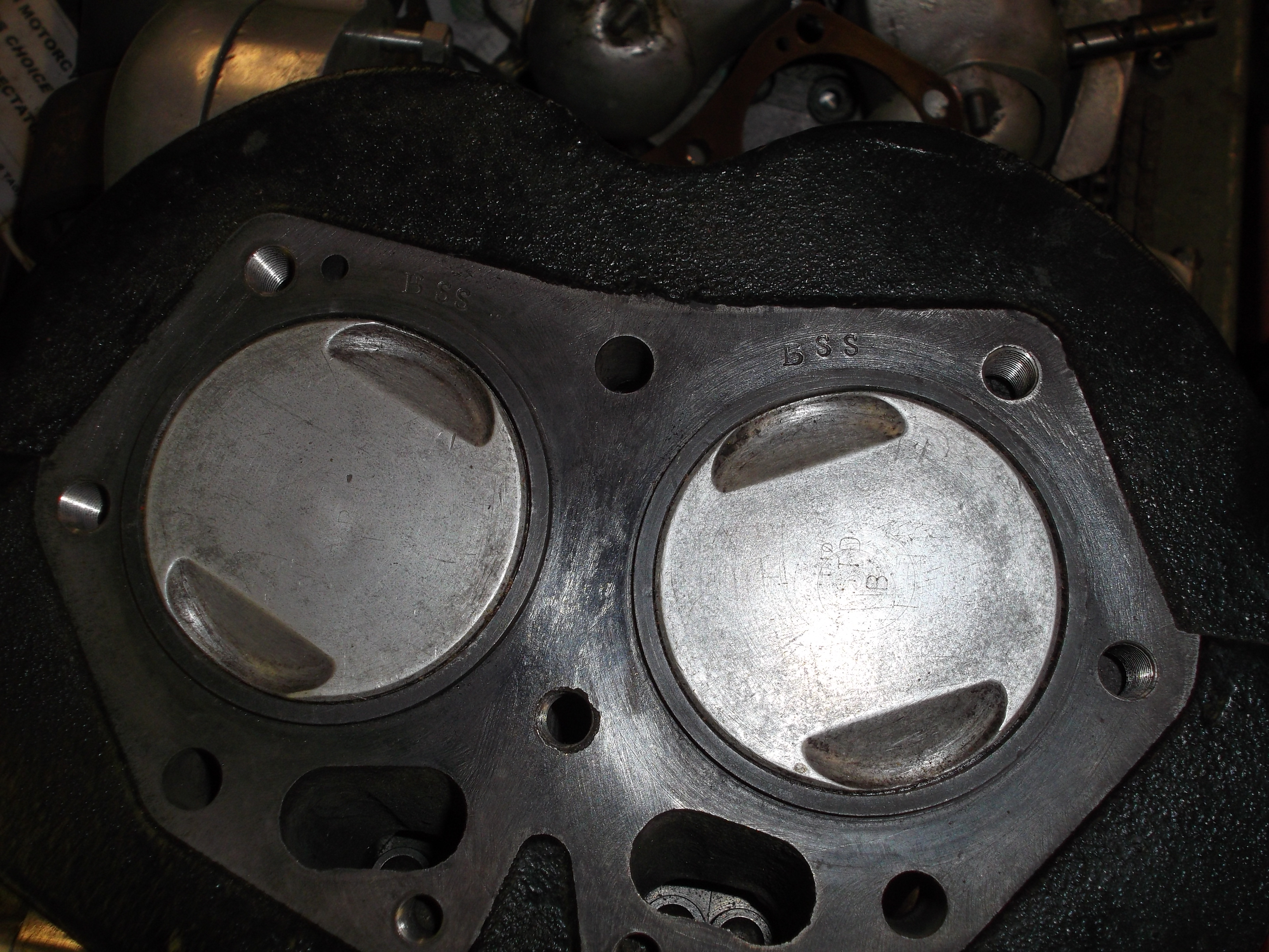

You might find a problem with the22792 in early 500 barrels. Later 500ss barrels were marked/stamped due to added clearance machined for the pushrods, mainly for the exhaust....pix of B grade bore, SS push rod passage clearance markings.
