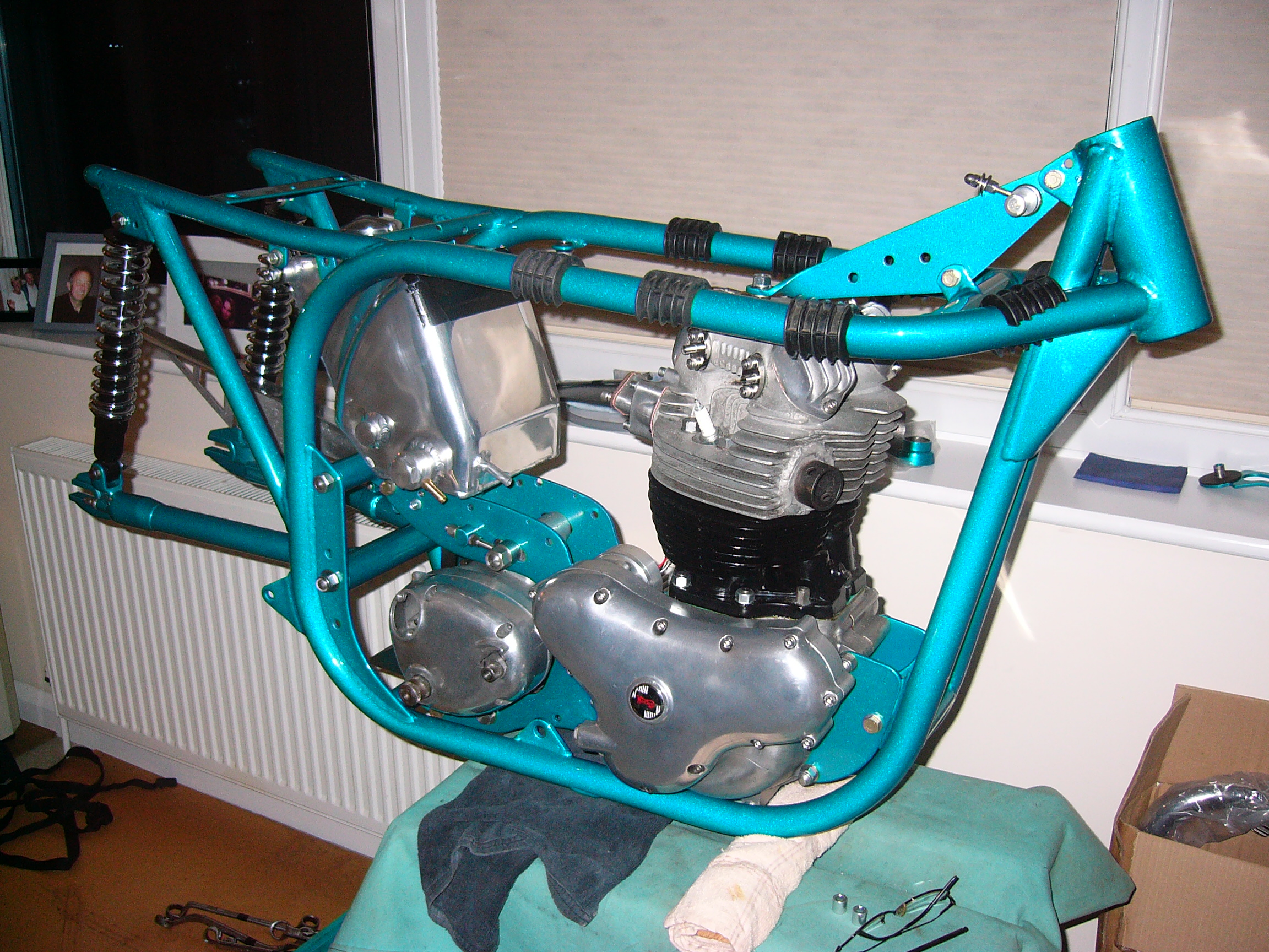

Although I spent what seemed like a lifetime pouring minute amounts of engine oil into the crank from the tiny hole on the end of the timing side I`m asking how everyone else does it ? Is there a better way ? I first did it when building the engine with it on it`s side . It`s now together and in the frame but I`d like to make sure it`s full .
