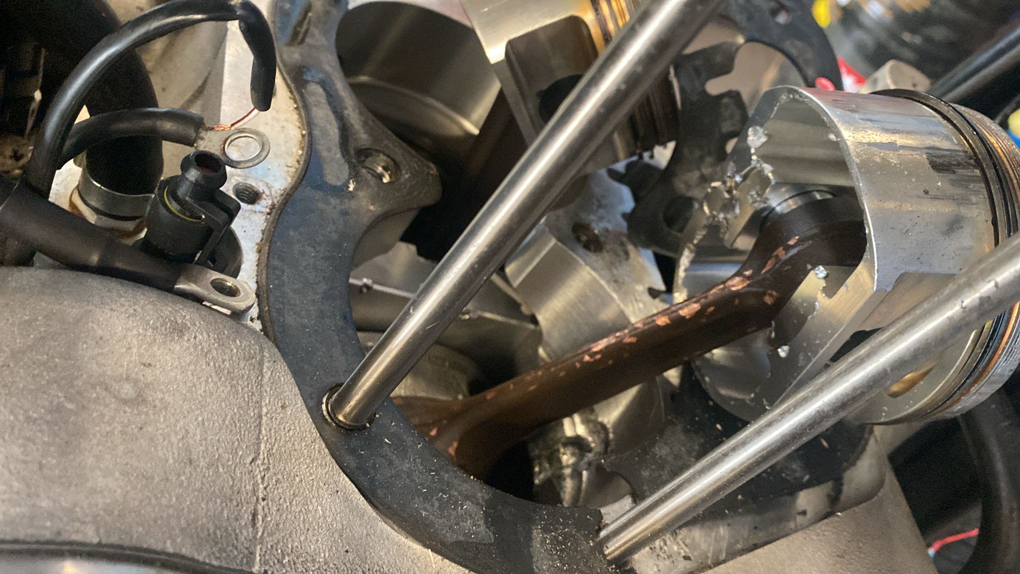

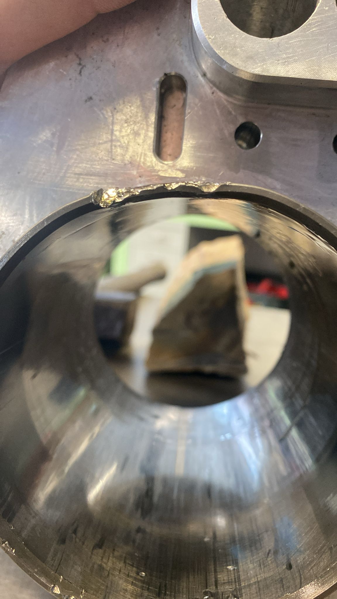

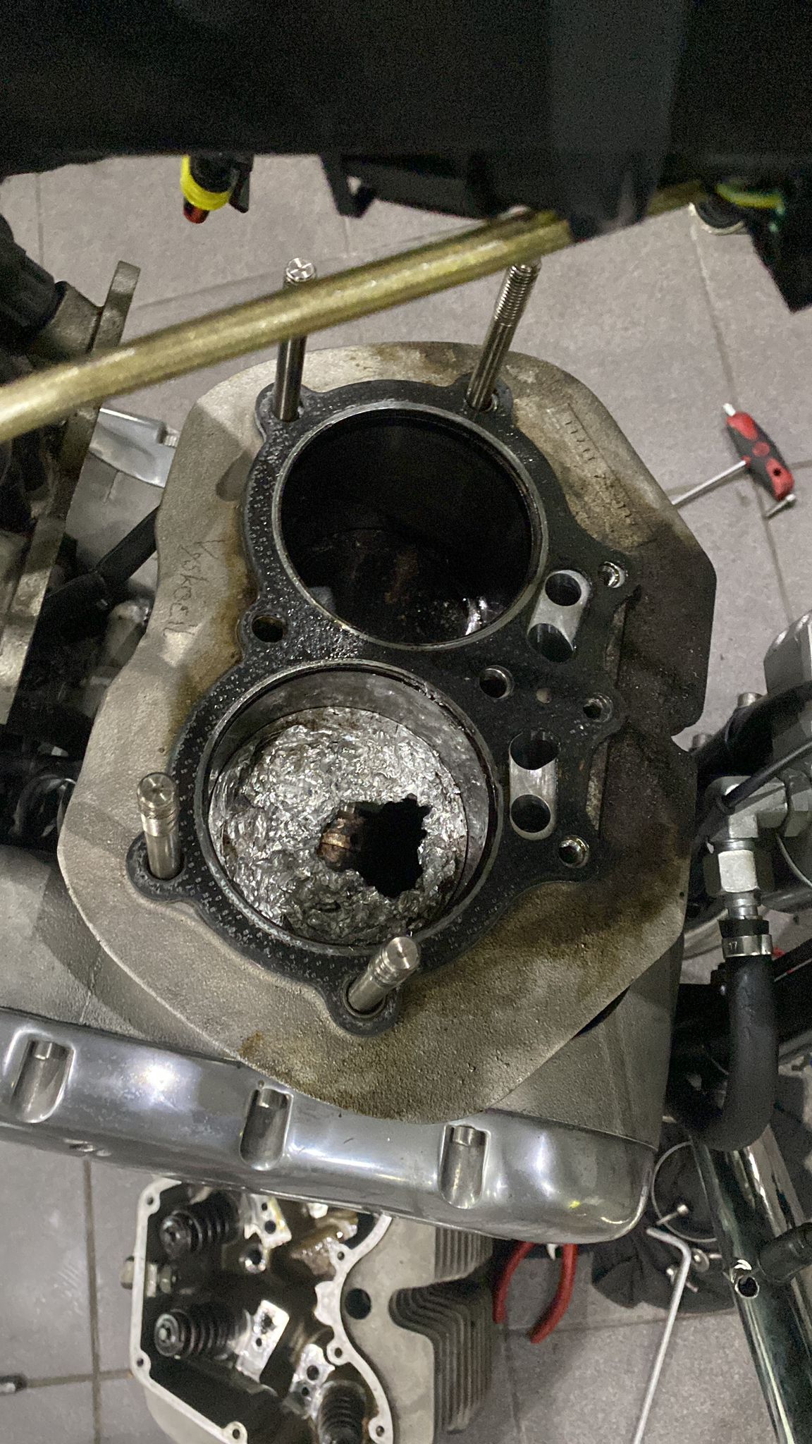

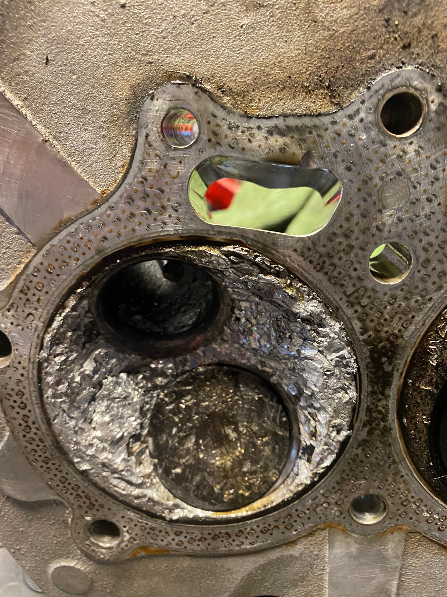

The exhaust valve puppet…
The exhaust valve puppet went through the piston head and damaged crank case internals so, that the cylinder sleeve is deformed at the bottom, see pictures attached.
