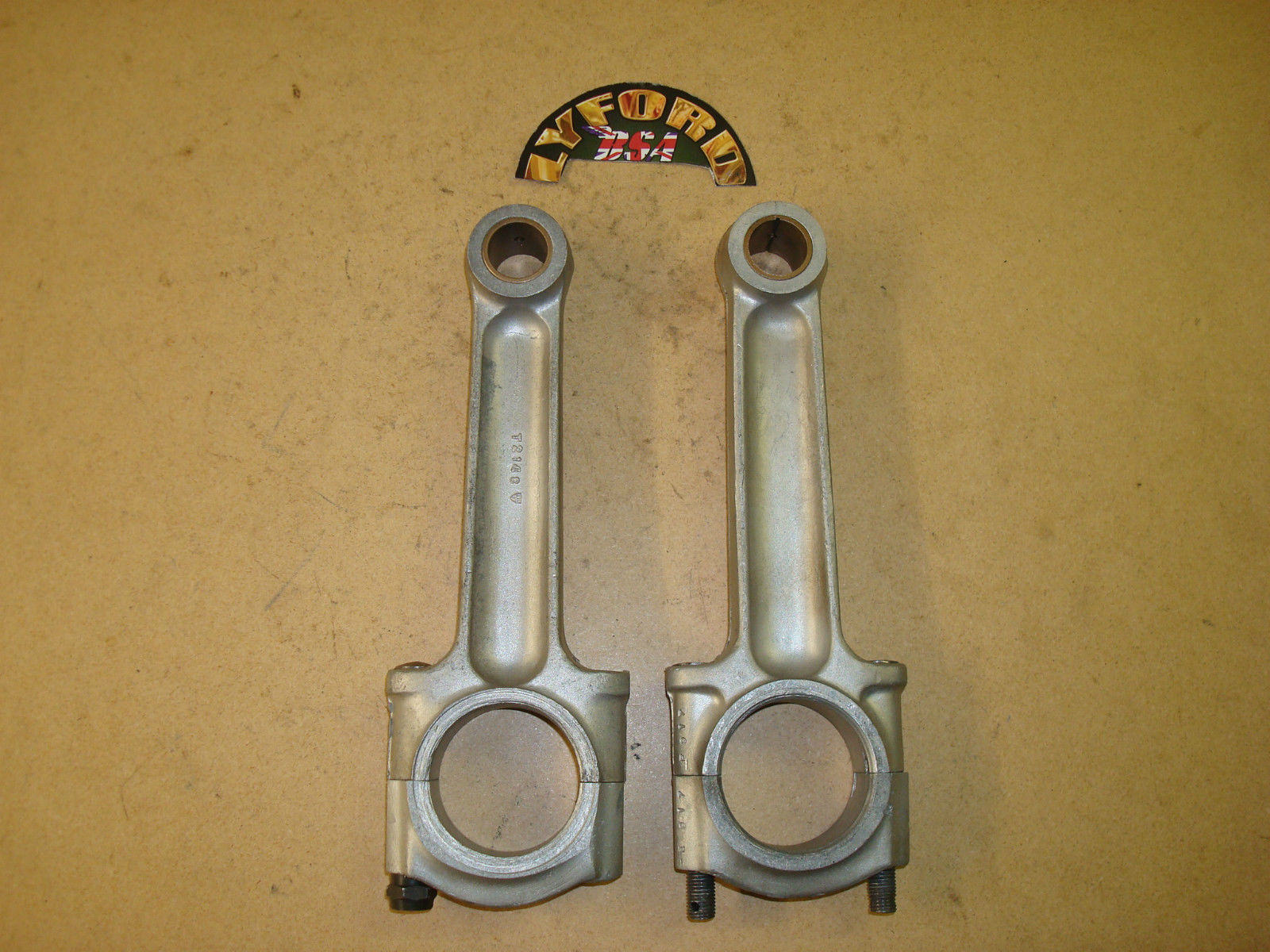

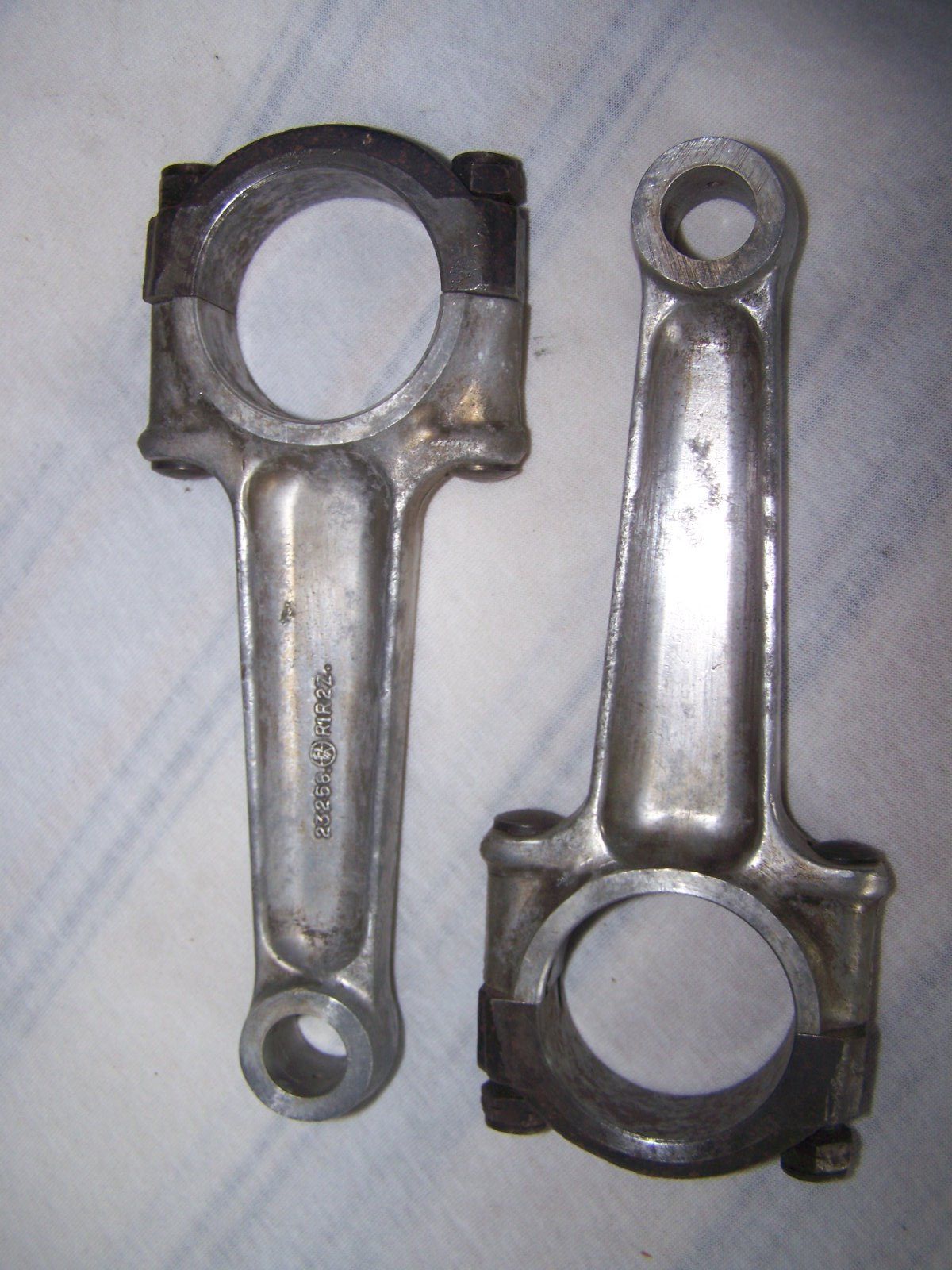

All Lightweight conrods have a plain, un-bushed, hole in the small end for the gudgeon pin.
Often damaged by forcing rusty or burred gudgeon pin through on piston removal.
Heavyweights of the era had same diameter gudgeon pin but brass brush in the conrod small end. These bushes, which need shortening for Jubilee, perhaps Navigator/Electra, make a good repair. Need reaming to final bore size after pressing in, as you have noticed. Take care to keep parallel to big end.
Lubrication is via the hole through top of conrod small end. Countersunk slightly to catch a bit more oil. Any bush obviously needs drilling to restore lubrication hole.

The 500 & 600 motors used conrods that had bushed small ends.  Whereas the 650 and 750 end used rods with un-bushed small ends.  The Gudgeon pins for these rods ran in the plain Aluminium small end.
Con Rods
Rod Small-ends

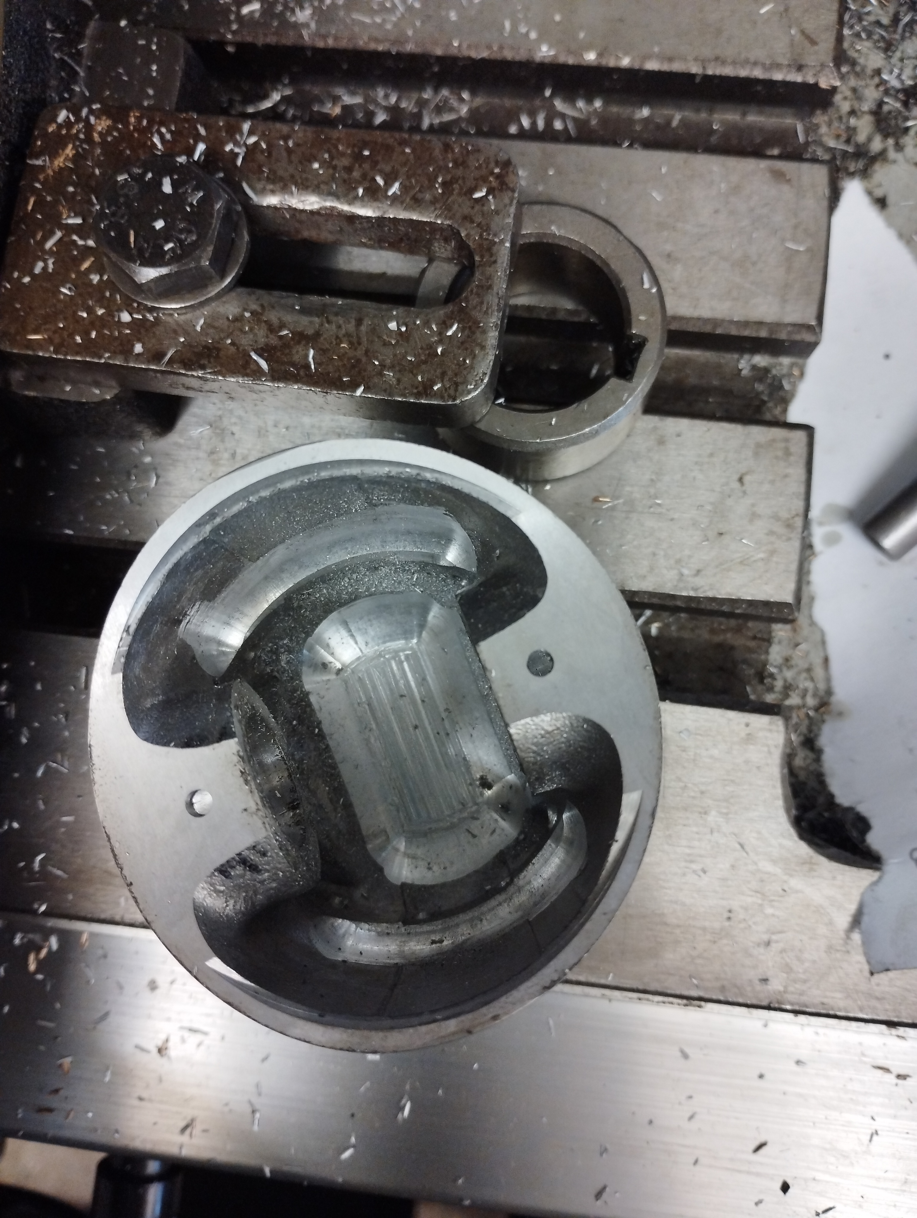

Paul, I've removed metal from inside the pistons.  Some from the inside of the crown, couldn't remove as much as I wanted, these pistons have what looks like a centre drill "hole" in the crown, part of the manufacturing process?
More metal came off the internal "bulge" that accommodates the rings, far too much metal below the rings.
A little bit more from chamfering the bottom of the skirt to help with oil control.
The pistons are now within (approx) 10grammes of the original H&G pistons.
