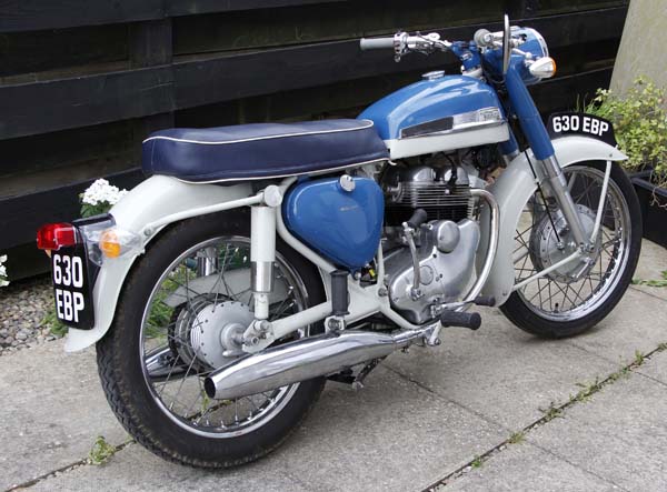

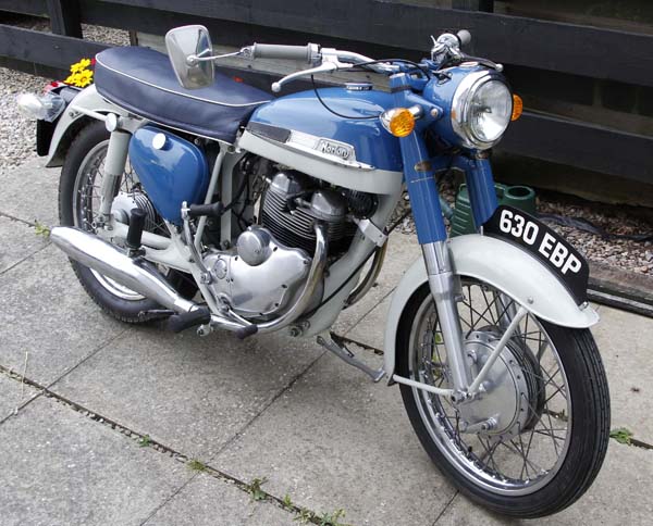

Just over a year ago I bought a 1961 Navigator which was a runner and in good comdition so didn't NEED much doing to it. But as I got it to give me something to do to keep ME in good condition I decided to try and bring it up to more modern standards without changing the look too much. I think I have managed that fairly well, but that is for you to decide, and I'm sure you will tell me if I haven't.
Right hand from front
I have rewired to 12vneg earth, fitted Boyer Electronic Ignition and indicators plus a few other alterations. Also added an external screw-on oil filter and ball valve in the oil supply line which has a microswitch to isolate the ignition unless the valve is FULLY open.
I will post some details of the work done in the next few days, here are a couple pics for now.

Right hand from rear
Bike looks stunning and the right rear indicator is brand new, still in its plastic bag!
That size and resolution won't show the small chips etc so it looks better than in real life,
Stan

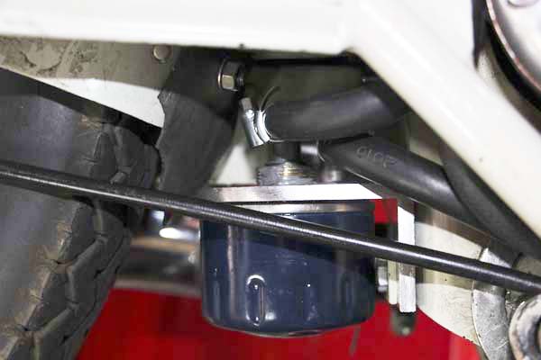

You bike look great, I have done the same mods but unfortunately my Navigator was a basket
case. Where did you fit the oil filter?
Thanks Steven,
It is fitted on the back of the central frame just in front of the mudguard. I couldn't find an adaptor with 3/4"UNF threads for my stock of Crosland filters so had to make my own.
Stan
oil filter

Crosland 659 screw-on external oil filter -  I have 10 of them from previous bikes and as they have 3/4" x 16tpi UNF thread I had to make the filter adaptor. It is fitted onto the back of the central frame just in front of the mudguard, I fitted a rubber screen to the mudguard fixings to prevent any splash getting onto the filter assembly. Note, all the ones sold now are M16 metric threads. See previous post.

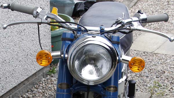

Amal 534 type ball ended levers - I fitted a set ot these which have 7/8" centres and also adjusters, so I made up new clutch and front brake cables to suit. The clutch now feels and works a lot better.

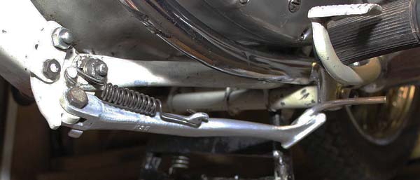

Stands - I adapted a Kawasaki ZZR600 Side Stand to fit at the frame joint below the front of the engine. A relatively easy mod and works fine. I still need to do some work on the centre stand, it works but could be better.

Headlamp lens - this bike has a step down rim that uses a 5.75" lens, the one I got on ebay is a sealed beam H4 and also has a pilot light, for £16.99 I thought it was good value.
Indicators - I have fitted as set as I feel the old 'sick your hand out' system is a bit outdated these days and not safe either. They have LEDs fitted and as I can see the front lights  when working I didn't have to fit a warning lamp. I shortened the rubber end on the fronts as they tended to vibrate too much, I can't see the rears when on the bike so they have been left as is. The flasher unit is a two lead unit inside the headlamp.

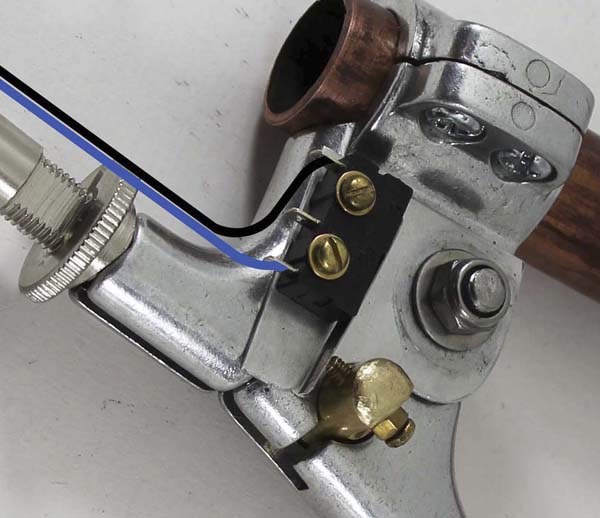

Front brake switch - again for safety, this is a microswitch fitted by two 3BA screws under the brake lever. I made a extended cable nipple with a small adjusting screw which activetes the microswitch. Being under the lever and with a thin alloy plate fitted between the lever and microswith it will be reasonably well protected from the weather. Also I don't intend using the bike in the rain unless I get caught out in it.

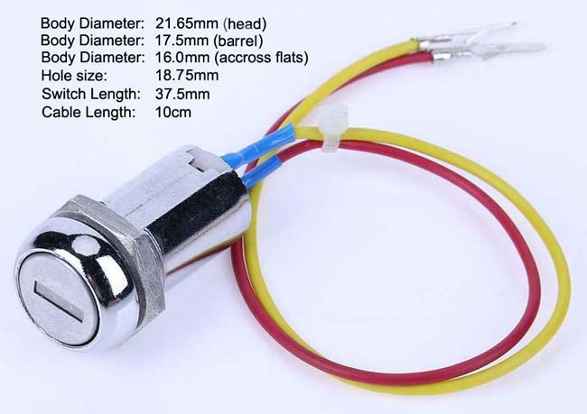

Key ignition switch - this is fitted in place of the original and only needed the hole opened out slightly. It allows me to leave the bike parked and know it can't be started even if someone finds the master switch. It also means I don't have to use the master switch when parking up for a short time. I know some will think all this is not needed, and I do agree, but as the master switch was fitted first I just left it there. I thought it was fun to add all these things and not make them obvious. The key for the switch has had the plastic top cut off and is secured inside the original switch knob so in use you don't know its there. The rubber washer is stuck to the lamp shell and helps prevent rain getting in round the switch, and the knob protects the swich internals.

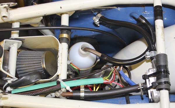

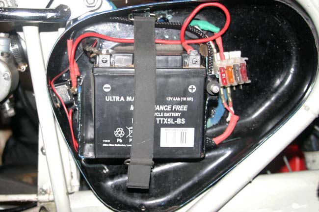

I bought a GIDIBII rear chain oiler which has been fitted inside the frame centre section below the carb. Space is tight so I moved the electrics main switch into the battery case to clear the way for it. I also got a cheap LED rear lamp to modify my new modern copy of a Lucas Type 564 Rear Light to LEDs.
Moving the main switch - This switch has been moved to the front upper edge of the battery box just inside of the upright frame tube, and almost out of sight. Its terminals are in the space immediately in left of the battery compartment so I fitted an insulating strip of tyre rubber onto the face of the it. All the rest of the additional electrics (volt/reg, fuses, charger connection socket, the live and earth leads) are also in or on the box so it is more like a self contained electrics box now.
The battery/electrics box contains the following components:-
  • Battery - this is secured by a Royal Enfield battery strap
  • Fuses - 10A main fuse, 5A horn fuse, spare 10A & 5A fuses in dummy holders
  • Voltage regulator - this is bolted to the back of the box. There is a recess just the right size for the unit to fit into. I drilled the holes and because the fixing bolts have countersunk heads (to reduce the intrusion into the battery compartment) I dimpled the edges so the bolt heads are flush, then a large washer was used between the battery box inner face and the unit, this allows for the dimple and also creates a space for airflow under the unit.
  • Main ON/OFF switch  - this SPDT 2-position switch is fitted on the side face, along with its cables (1 to battery, 2 (in an enclosure) to the fuses & 1 to charger socket). It is fairly well hidden so not easily seen but still easy enough to flick on or off as required.
  • Charging adaptor - this is a 2.1mm DC socket fitted low down on the side face of the box, actually in the small compartment below the battery base. The socket points slightly down so any water getting into it will drain out.
Battery box

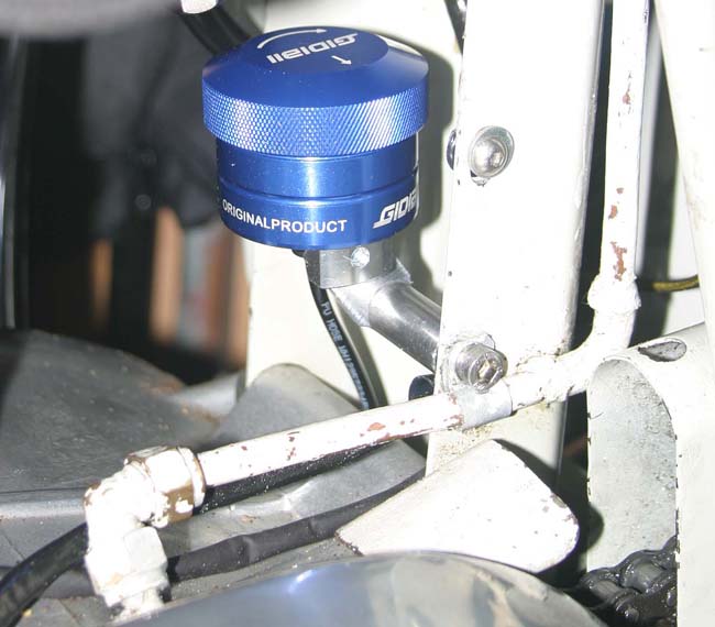

GIDIBII Rear Chain Oiler - Because I want to keep the Navigator looking as original as possible, I looked for a mounting position so it wouldn't be too obvious. The only position I could find was in the frame centre section below the carb. This is another advantage of not having the styling panels, if I was to do it again I would go for the grey/titanium coloured version.
Fitting the GIDIBII chain oiler reservoir - To locate it in this position I removed the 5mm bolt that holds the breather pipe and alternator cable P-clips (this hole may not be standard as the breather pipe had been modified), then I filed out their holes to 6mm and ran a drill thru the frame hole. I then cut a 30mm length of 19mm stainless tube, inserted a length of 6mm ID rubber hose to make a stand-off for the oiler and secured it all with a 6mm stainless Allen headed bolt.
GIDIBII chain oiler
Unfortunately this is not the easiest place for it to be topped up when required, but I felt that as this won't happen all that often then I could cope with the slight inconvenience involved. I have a large syringe that makes it a little easier. I could re-route the rocker oil pipe closer up the frame to give better access to rotate the reservoir when I fill it with oil.

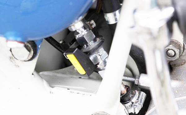

The route for the oil feed pipe - The oil feed tube runs from the reservoir down thru the space behind the gearbox and the frame, then out between the top and lower chain runs, back under the swing arm pivot, along the joint between the LH swing arm leg and the lower chainguard to the adjustable arm guide mounted at the end of the chainguard then down to the chain just in front of the sprocket. The feed tube is secured to the chainguard by the two supplied clamps, thru the guide block and along the extension arm.
Chain oiler arm guide mod - To fit this I used the mount tube that is fitted under the swing arm for the lower part of a full chainguard. This has an internal dia of 1/4" and is approx 1 3/16" long. To use this I tapped a 5mm thread in the inner arm guide hole that is the alternative position for the screw that holds the arm on the other side. I made a 50mm long stud by cutting the head off a long 5mm bolt. This was then screwed into the arm guide and locked with Loctite bearing fit. I then fitted thin double sided adhesive tape to the top and inner face of the arm guide and attached this to the swing arm and lower chainguard then secured it with a washer and nut at the inner end of the stud. The arm was fitted and the oil tube fitted thru the guide and held along the arm, by two cable ties, not thru the long lower slot as designed due to the alignment of this setup. The oil tube was bent to align the oil drips onto the centre of the chain run. To give it stiffness to retain the bend I have used a length of brass tube pushed up inside the plastic tube.
delivery arm
Once filled and primed the system works fine. It is a bit awkward to use due to the location I selected but that's life when working on old bikes and wanting to keep the looks as original as possible.

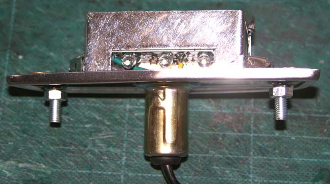

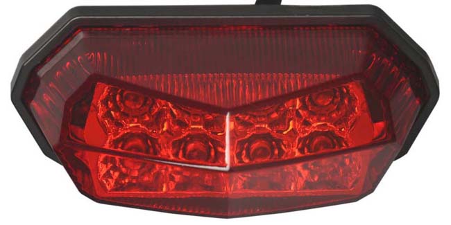

Converting My Lucas Type 564 Rear Light to LEDs
Because the rear lamp on my Navigator was in poor condition and repairs were not, in my opinion, satisfactory I decided to buy a new replacement. This was a modern copy and although it worked ok I decided to see if I could convert it to using LEDs.
LED rear light
To do this I bought a lamp like the one shown above. This was dismantled, rather the lense of the lamp was cut away from the base, then the LED board and reflector unit removed. The bulb holder and leads were removed from the Lucas lamp and then the LED unit was trimmed where it contacted the internal screw heads in the Lucas lamp and secured to the inside of the lamp base. The leads come out thru the hole for the original lamp holder leads.
LED insert fitted
At the moment for trials the led unit is just secured with double sided tape, I will probably use silicone later once I am happy with it. The silicone will give it added protection from vibrations and seal the leads entry.
No plate LEDs
So now I have a new looking rear lamp with better LED lighting which should survive the vibrations of a parallel twin and with no filamenmt bulb inside to blow and need replacing.

There is a LED bulb available for the rear light which fits into the socket, also with positive earth.
I have on one my Navi.
Which ignition lock did you sue? A generic one?

it wont be long before we use up the supply of Kawasaki side stands!

Uli, I got the switch on ebay, I see there is one on just now, item number  403744518357. You will see why I wanted to change the key fob!!! I did the LEDs that way just to see whet it looked like and it was another way of doing it, permanent I hope.

The Kawasaki stand was an easy fit and works well.

I think I have used 3 Kawasaki stands, one on my jubilee, one for a navigator project and one on my short stroke ES2!

So it's you that's using all the side stands, you'll be pushing the price up.
