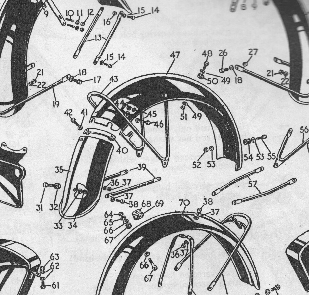

I'm sure that the fittings for the Model 7 rear mudguard is the same as the ES2 for that year, someone will correct me if not. Attached is a pic from my parts list which could shed some light.
If so, that list is readily available, probably on this website's spares list.

Yes ES2 and Model 7 rigid/plunger frames are identical.
Pic shows a single bolt & nut fastened to the frame with a hole drilled in each of the two frame cross tubes.

(1952) has a hole in each of the 2 cross tubes. It needs a spacer approximately 3/4" thick between the bottom cross tube and the mudguard to get the correct relationship to the tyre (3.25" section in my case) - number 54 in the pic.

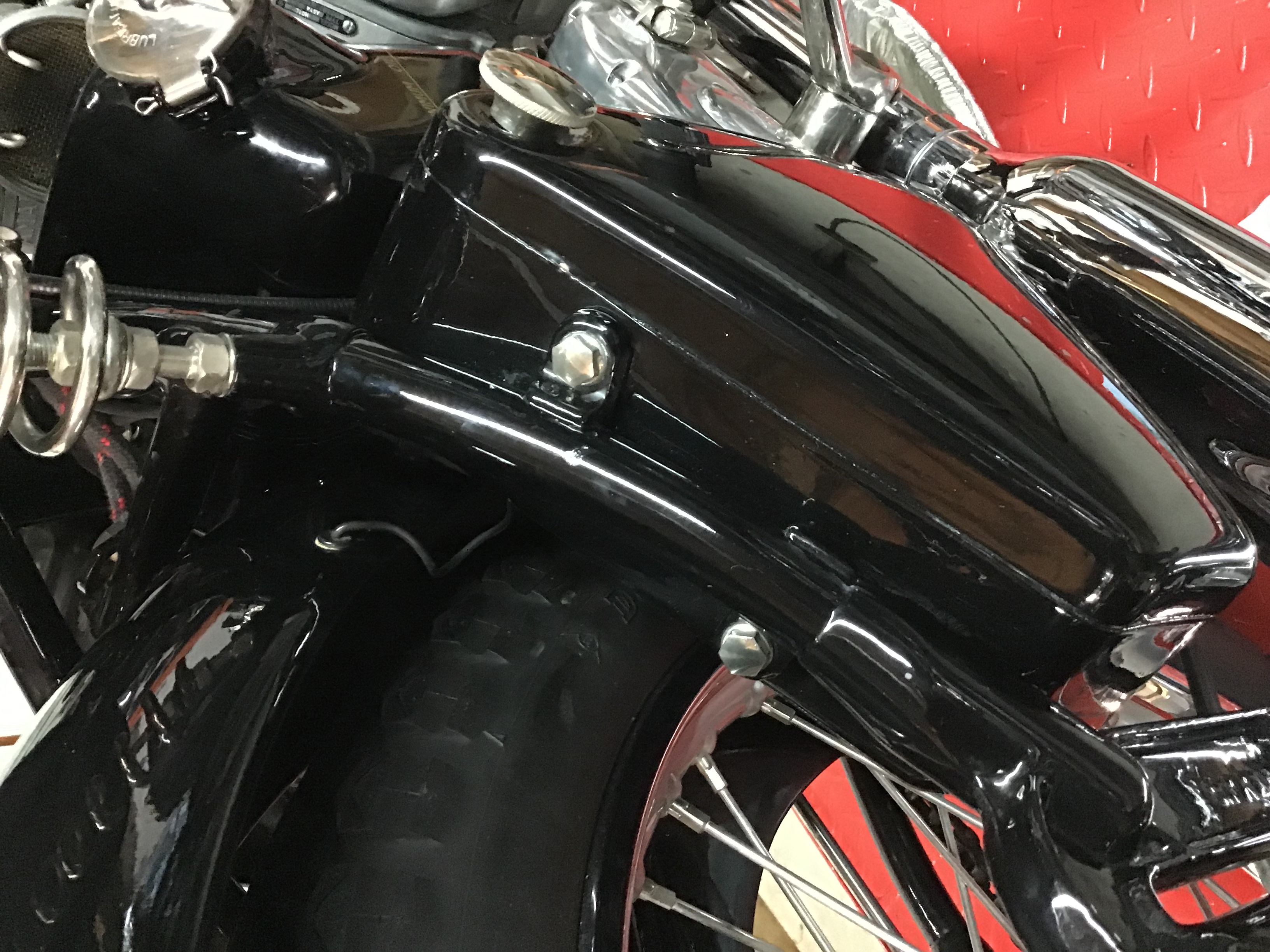

Here are some photos of my 1950 plunger ES2 .
The removable section of the rear mudguard fastens to the large section with two bolts - these can be seen in the photo above the two of which also pass through the the license plate/tail lamp holder. The bottom end of small section bolts to mudguard stay . Large section bolts to lifting handle/ stay , also through cross tube by lower seat springs. This bolt passes through an L bracket for top of oil tank and a spacer for fender.
  The bottom of the oil tank has a tab which mates up with engine / gearbox plates by gearbox adjuster and is fastened here with two bolts.
 The toolbox hangs from upper rear frame member with two bolts through tabs on frame and is secured at it’s bottom with a bolt and spacer through mudguard.
If you need further help / photos I’ll be happy to help.

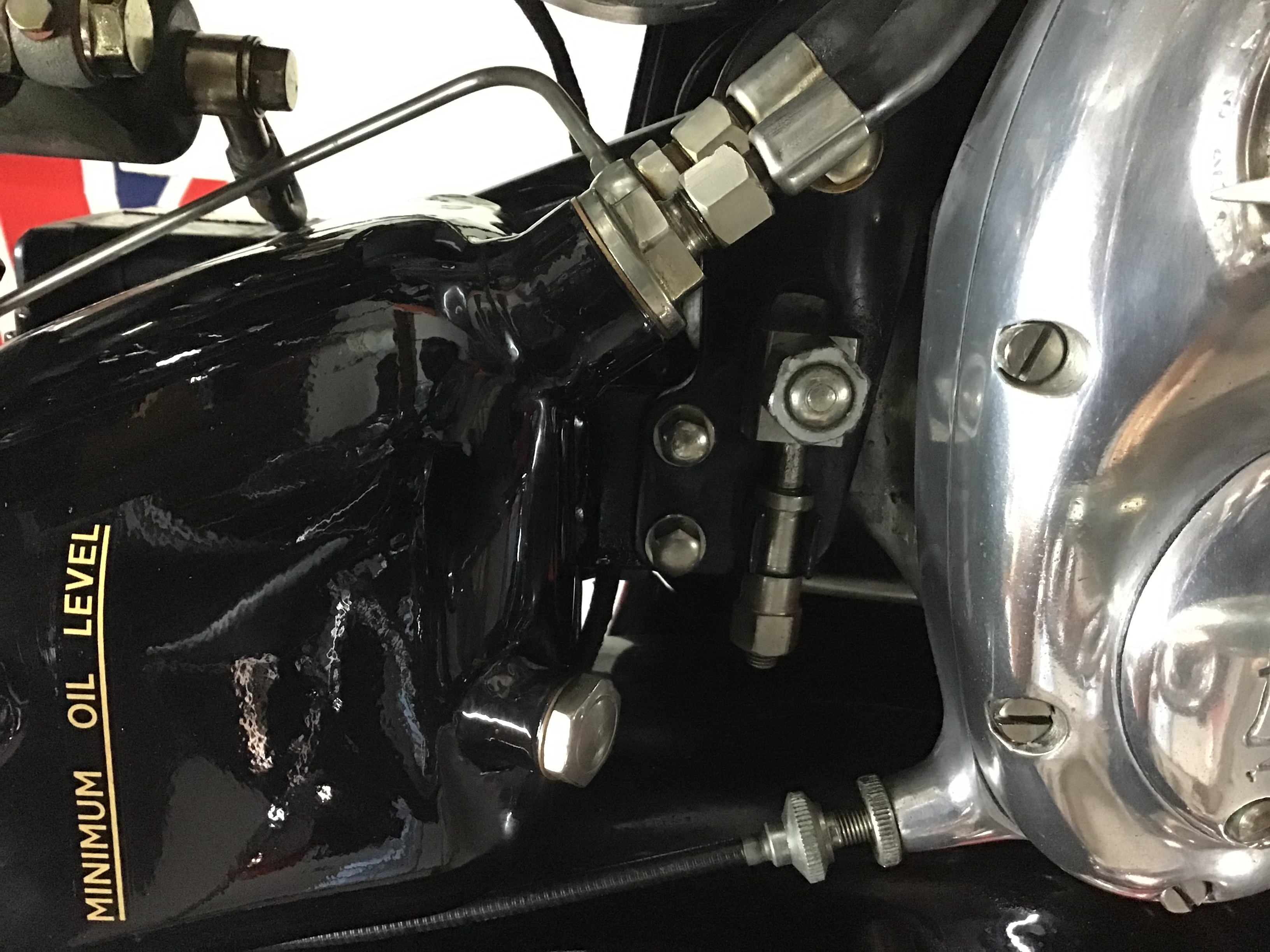

Here's the picture of the P clamps to fix the rear mudguard short piece to the frame and also the top mount of the oil tank.
Paul
