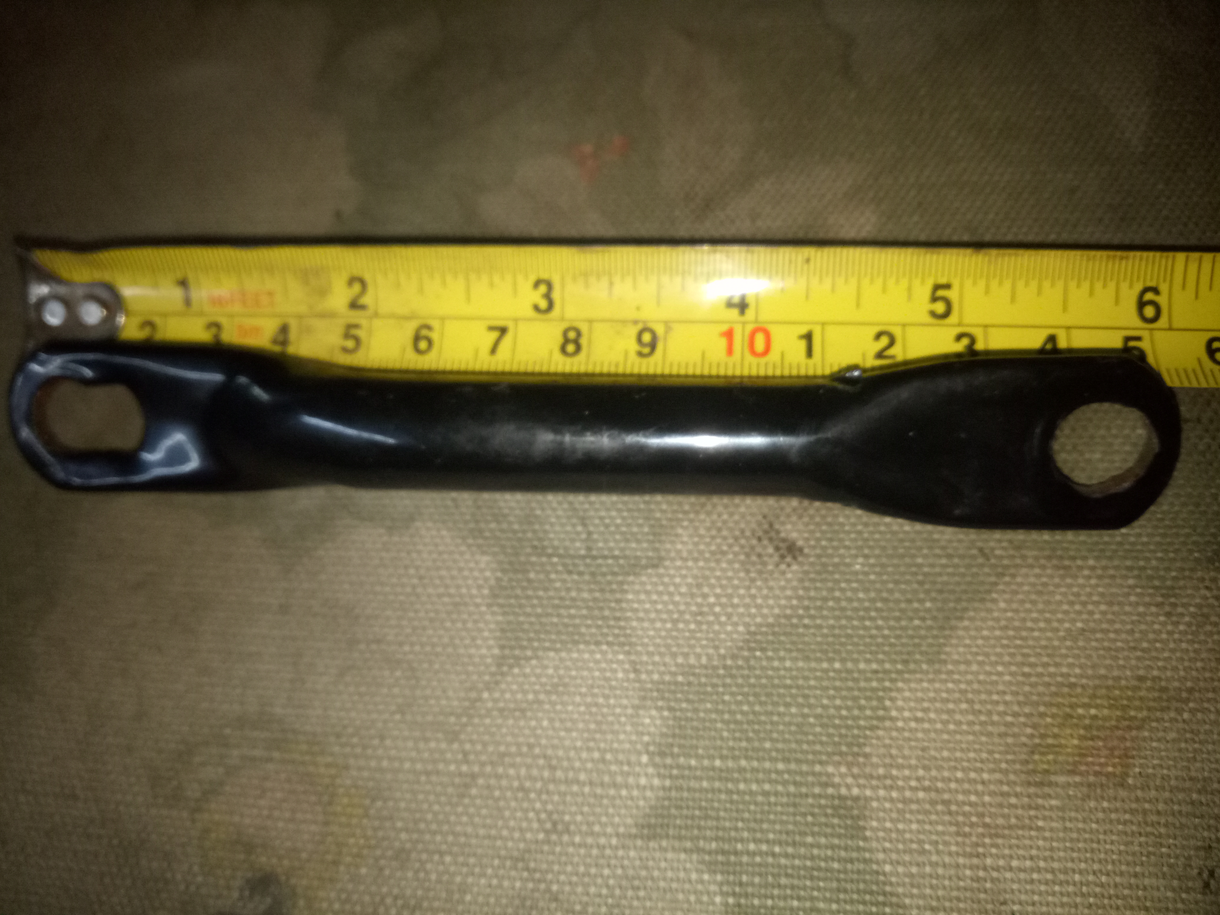

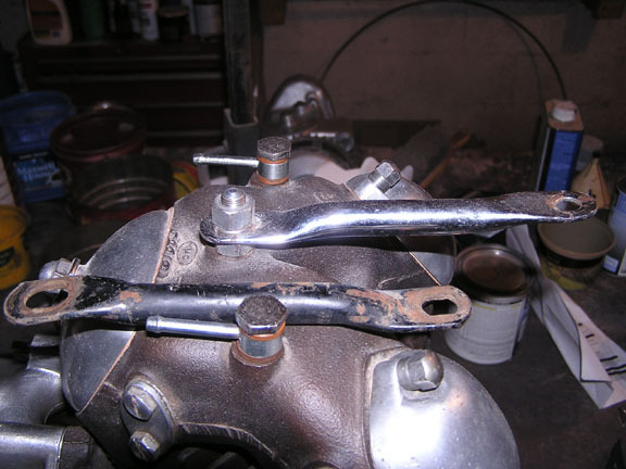

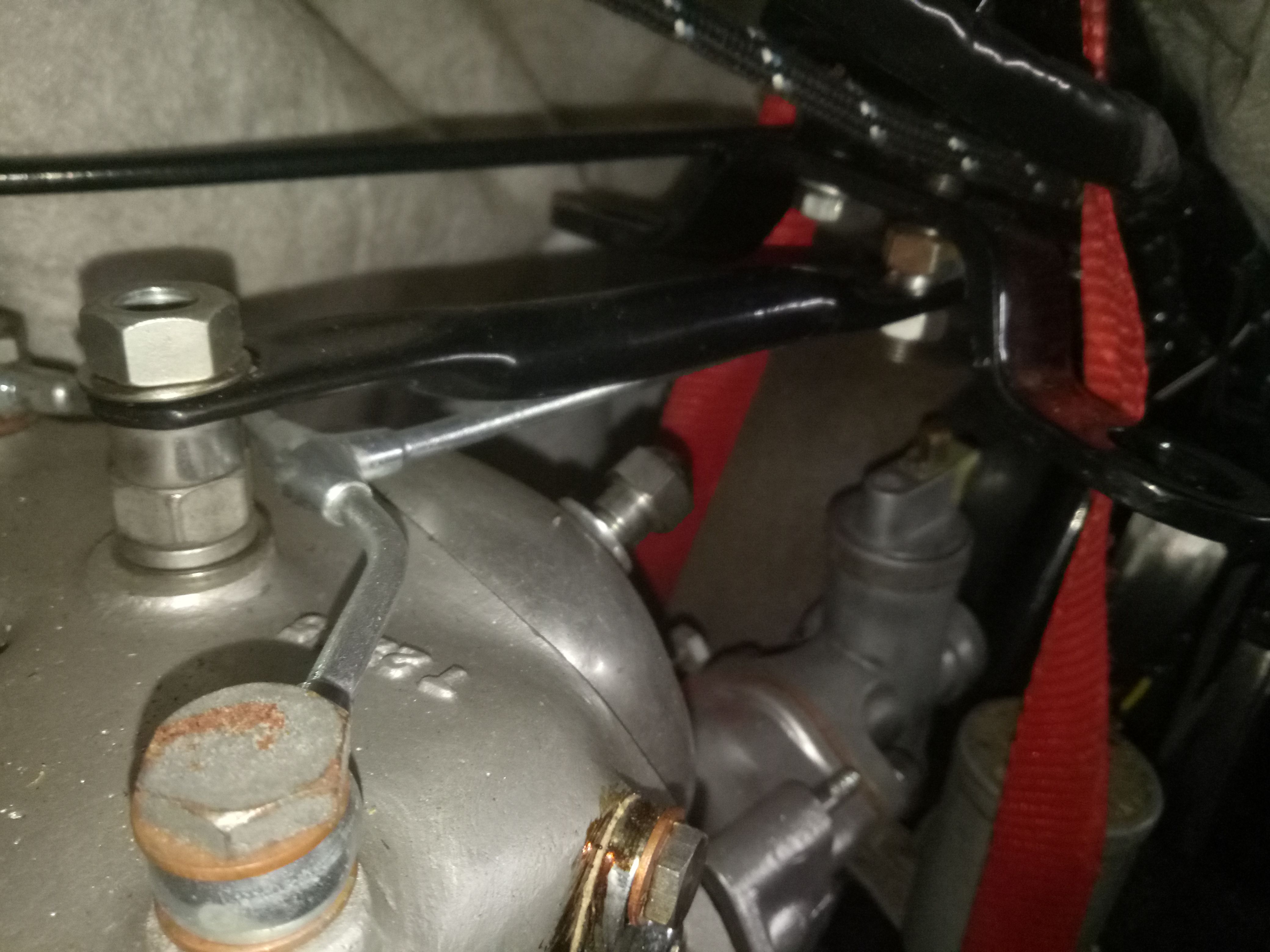

Hi Philip, Attached are a couple of photos for you.
The same part fits a plunger model 7, swinging arm model 7 and also a rigid model 77 500 cc twin.
If you want a template send me a PM.
