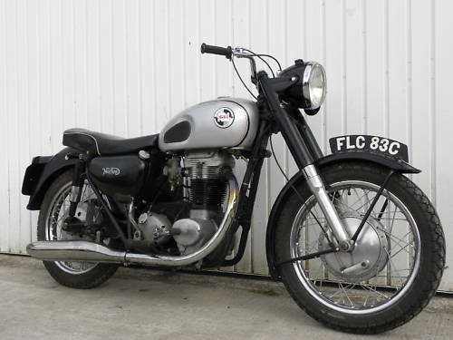

Does the model you are talking about look anything like my attached photo? This one seems to have it's front brake adjuster wound up tight, perhaps to stop it rolling away...

Is this the model you are wondering about?
Paul
Worth remembering that when a bike is firstput onthe road, that doesn't mean it's the current model forthe date of registration.
Paul
ah , yes i see, it is very like the pictured one, so one should not determine age of bike byreg number dates, but i thought DVLA stopped you making a vehicle look newer by reg than it actually is ? the bike in the picture is what age , approx ?

thanks , now i know here i 'd seen that points cover before
