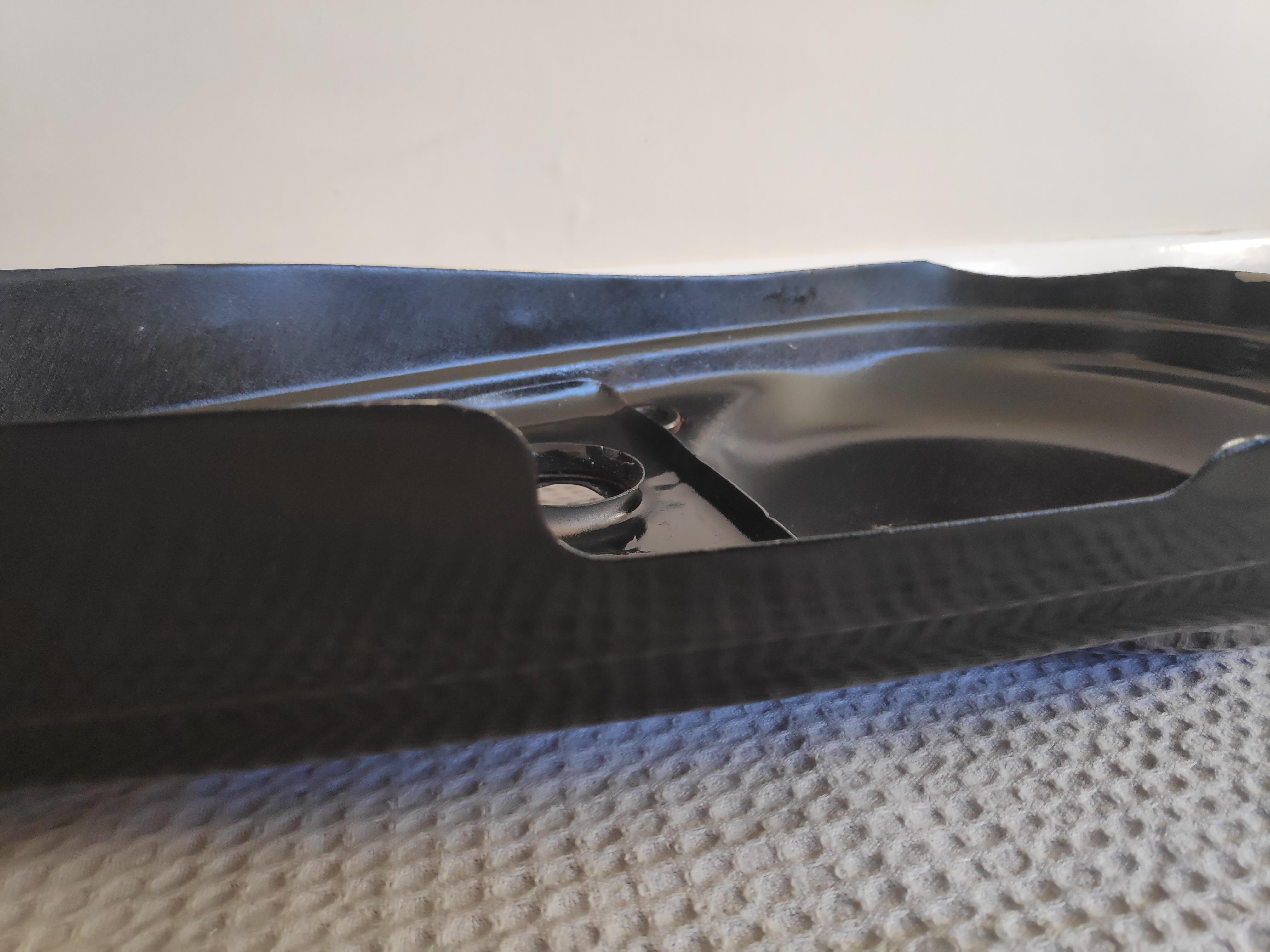

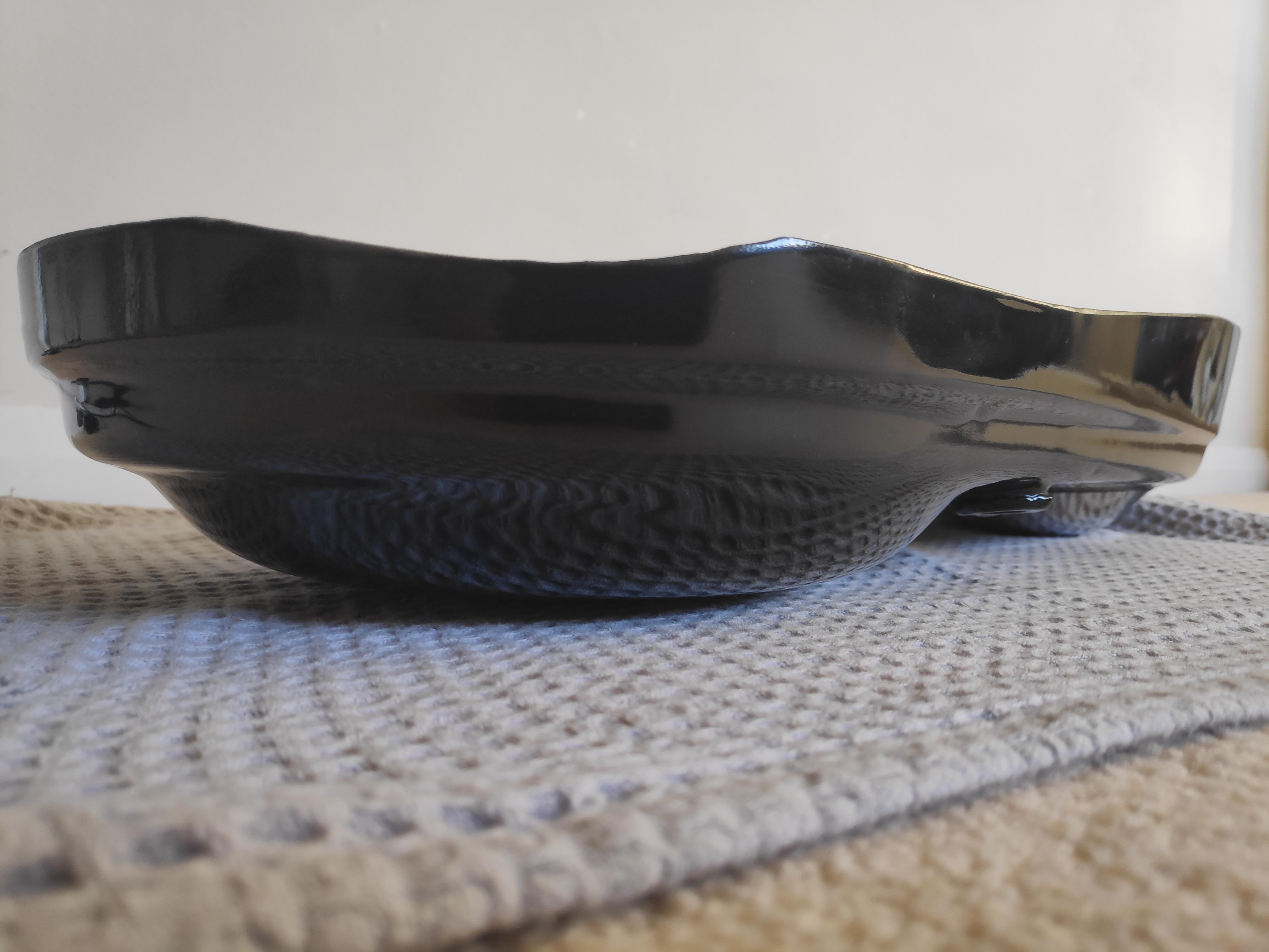

Can someone let me know if the primary outer chain case in the attached photos is correct or has the seal rim profile been cut away?
Thanks,
Ross

Dont know if its the correct part,but the case looks unusually straight. I would not write it off as the bit that actually seals looks ok.

Hi Robert,
I believe the part is original to the bike so would like to keep it.
I need to check if the profile of the seal is correct or if it has been cut up at some point as it doesn't look correct.
The images online of this type of case show the upper side of the case profile but not the lower side.
If anyone has a case they can upload an image showing the lower edge profile that would be great.

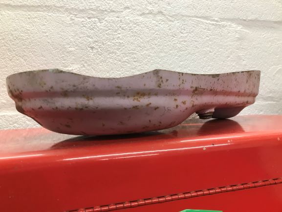

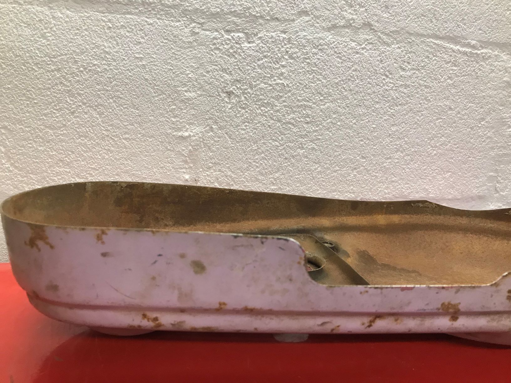

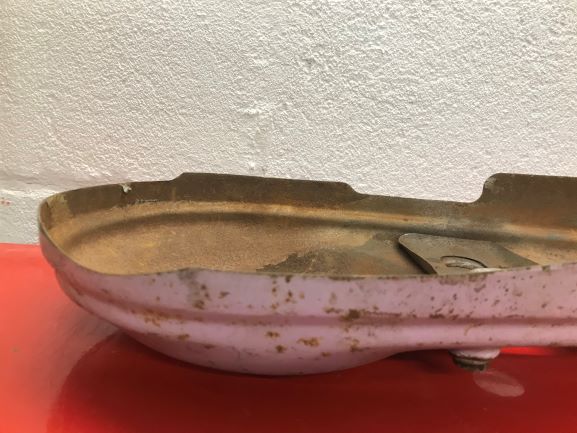

I'm fairly sure your outer…
I'm fairly sure your outer primary case is correct - I have a '47 Model 18, which has what seems to be an identical outer primary case. I can't guarantee it's original, but from the history of the bike, I believe so.
Hope these pics help,
Alan

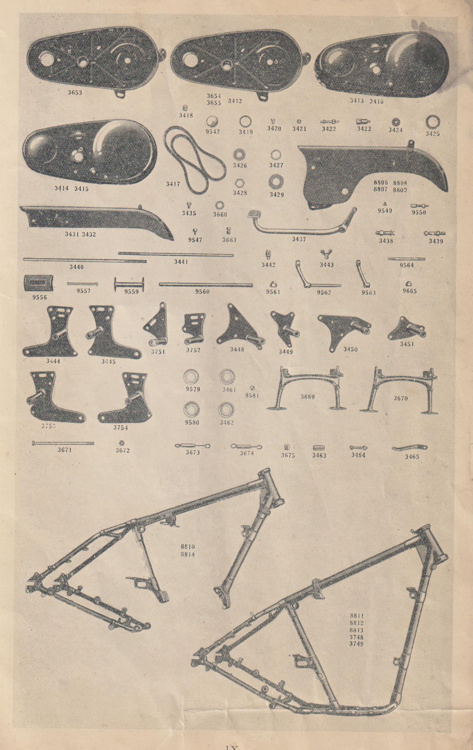

Parts Book Pictures
The attachment may be of some help. It is pre-war but the chances are that little had changed 10 years later. The numbers are......
3653 - Inner Chaincase Models 1, 16H 18, 19, 20, 50 & 55
3654 - Inner Chaincase Model 18
3413 - Outer Case/Cover Models 1, 16H 18, 19, 20, 50 & 55
3414 - Outer Case/Cover Model 18
Other number relate to Models CJ, CS1, 30, 40 etc.
Hi Alan, The pictures you…
Hi Alan,
The pictures you posted show your chaincase has the same profile so it looks like my case is correct.
Thanks a lot for your help!
Ross
Thanks Philip, Appreciate…
Thanks Philip,
Appreciate your help.
Looks like the chaincase is standard based on Alan's photos.
