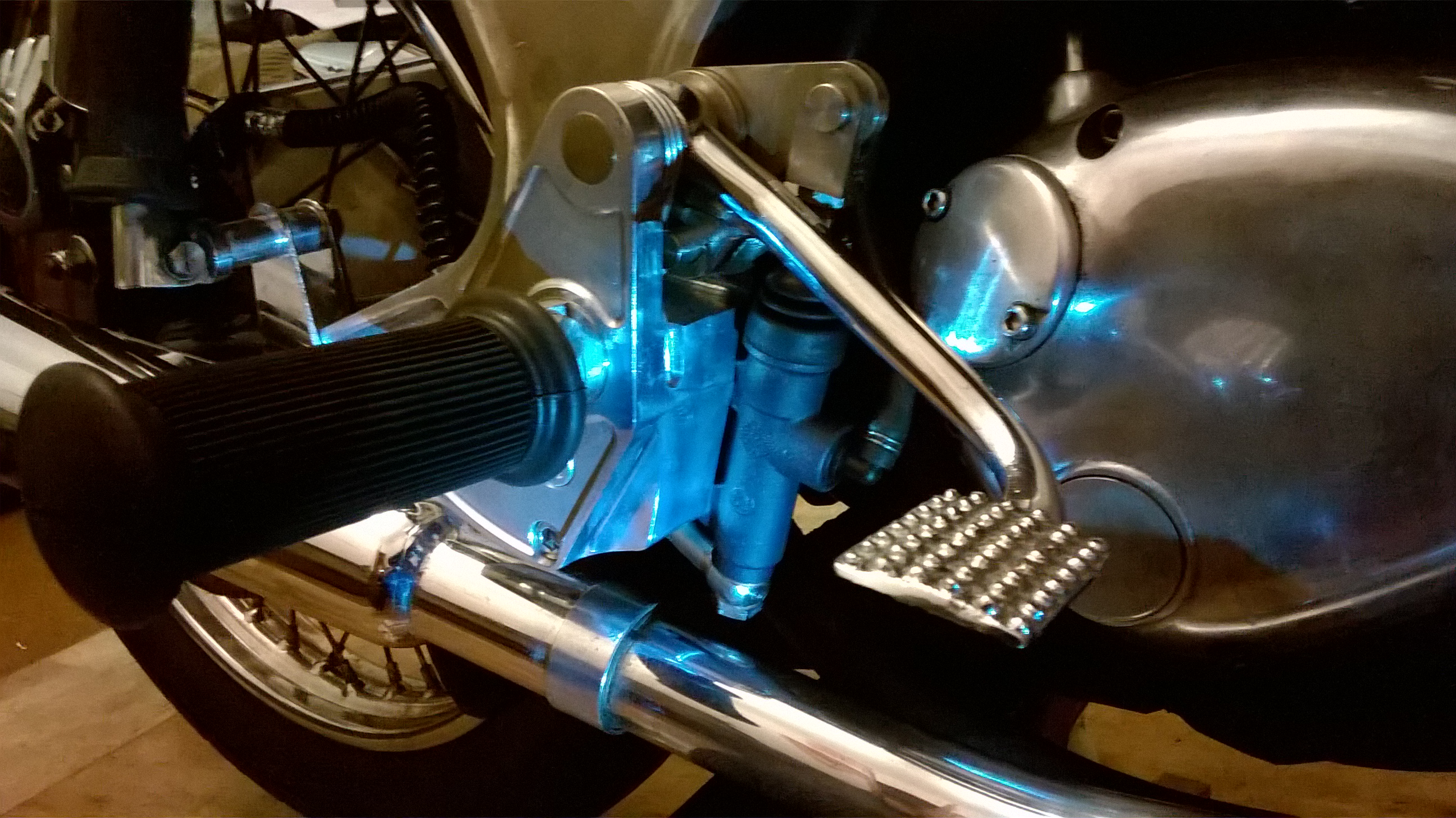

Thanks Katherine, don't suppose you have a photo of your set up by chance ?

I used a 13mm Grimeca master cylinder, bought from an autojumble for a fiver, what ever you do take into account the smaller cylinder and the lever ratio used, try and get the ratio to match the cylinder so your not over braking the rear wheel.
Thanks Peter, that's a neat…
Thanks Peter, that's a neat set up, unfortunately I have a kick start, so would have to modify it, but I get the picture.
