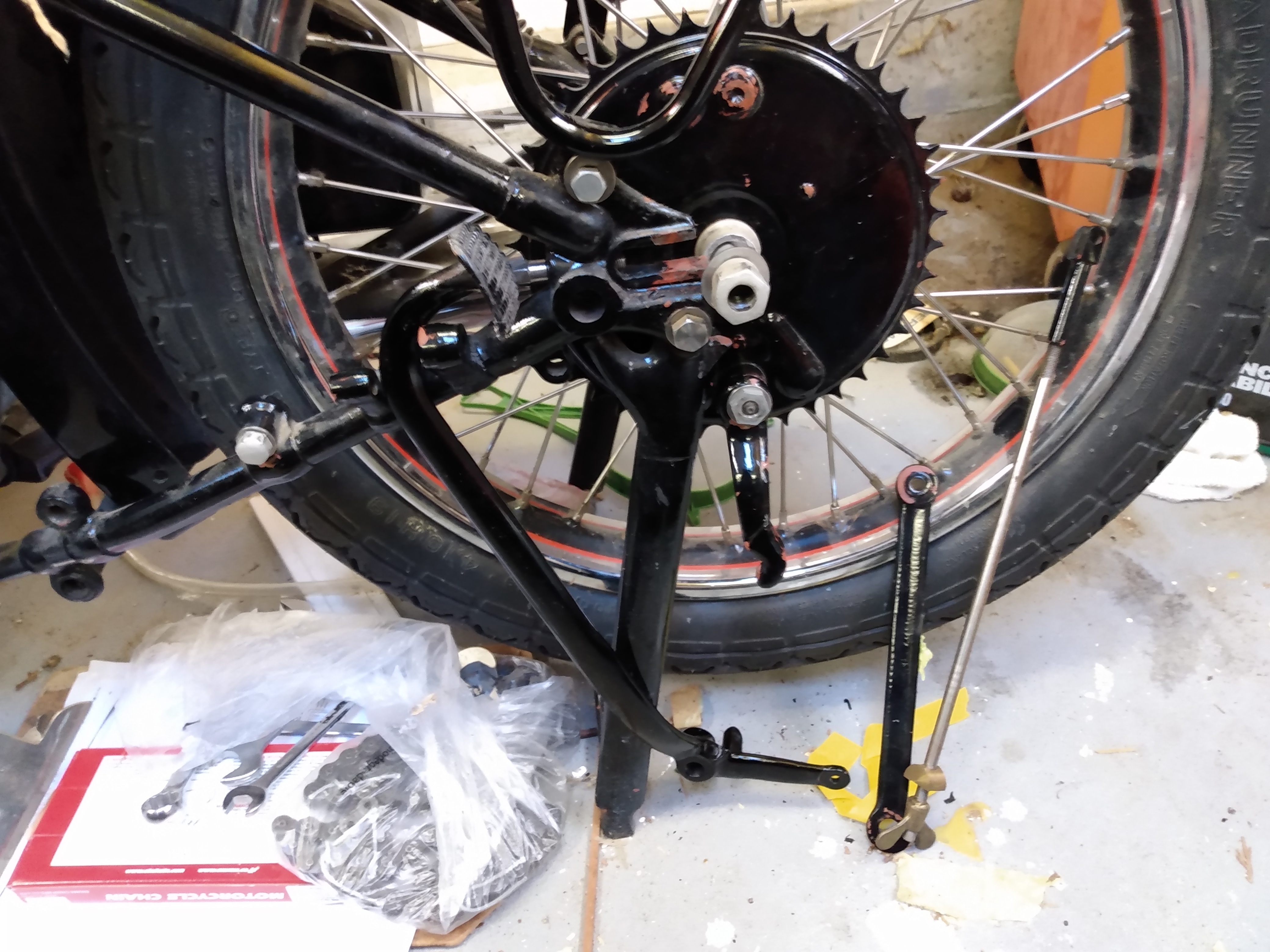

I am trying to get the back brakes organised. I have enclosed a picture showing the situation. Can anyone send me a picture of what it should be like. It is a mixture of a machine but seems to be more mid 30 16h than anything else.

The frame shown in the original post looks to be a 1940-on WD16H item, with both field stand and pillion footrest lugs. This shouldn't though affect the rear brake operation.
There were two types of WD16H rods, the early version being identical to pre-war civilian and the later introduced to allow adjustment at the front once the rear was obstructed by the military pannier frames.
In both cases, the operating arm should face upwards as per David's, with the torque arm fixing to a stud on the brake plate which sits underneath.
The original large bronze wing nut has a rounded nose which acts as a detent in conjunction with the rear curve of the brake arm. The half-round spacer was used in conjunction with the later set-up, as it was simply locked in place with a nut.
It looks as if you may have a mixture of earlier and later parts. Footrest arms and brake pedals too vary between military and civilian, not a problem if they are fitted as a set.

This is mine. 1937.
The threaded brake rod is 9/32 × 26. The proper wing nut fits into the lever. This one is from NOC spares but was 1/4×26. Drilled out and threaded
