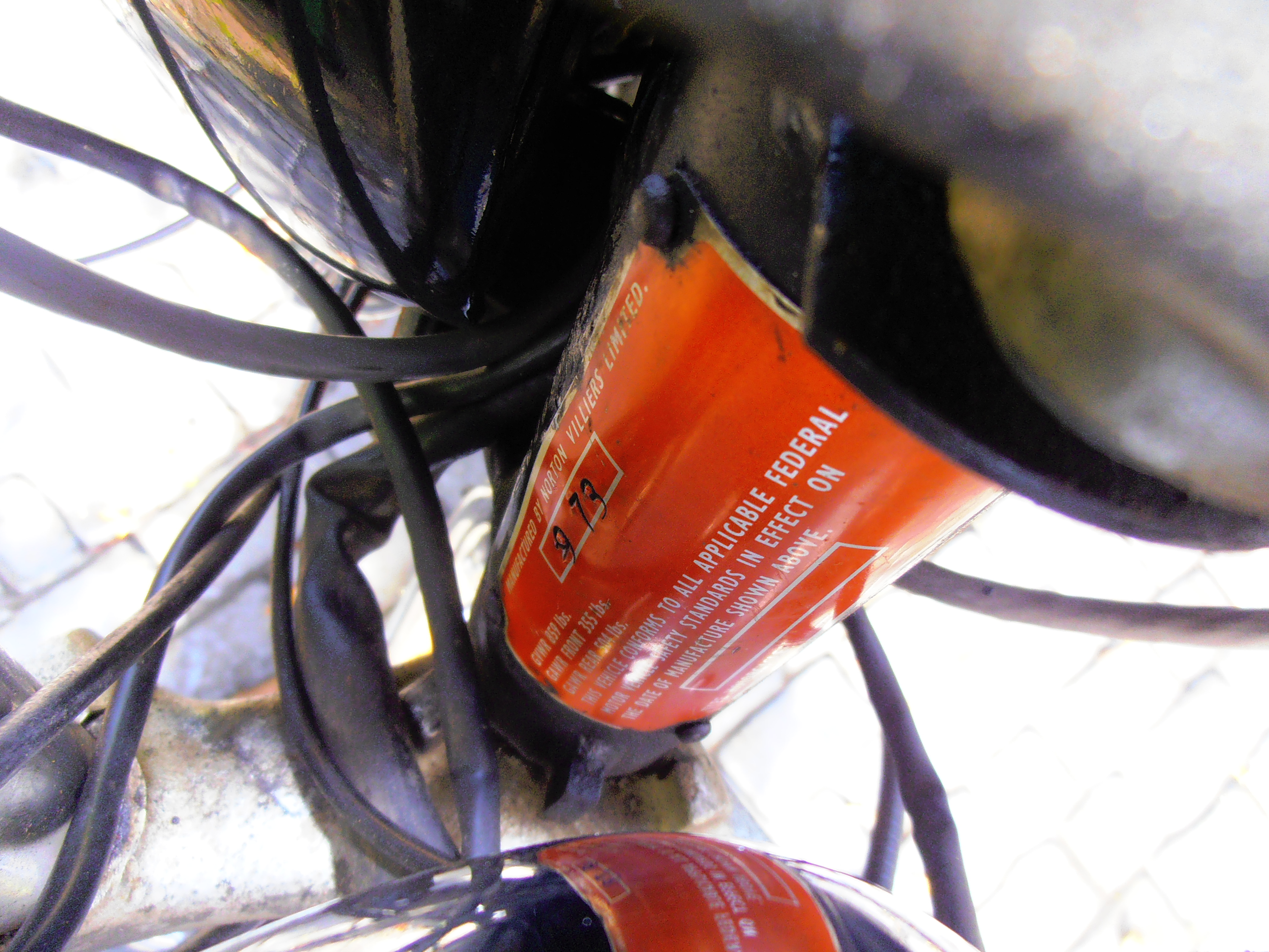

Plenty of exceptions and anomalies with the red VIN plate generally. This is my Mk1a 850 I've owned since '77 showing factory date stamp 9/73 (Sept '73) and nothing stamped in the other box space.
