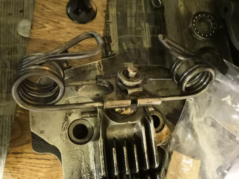

Hairpin springs.
Hi Christian,
You might be Interested in a period trade film on YouTube titled Norton preparing for the 1948 Isle of Man TT races. Sorry I couldn't copy the link.

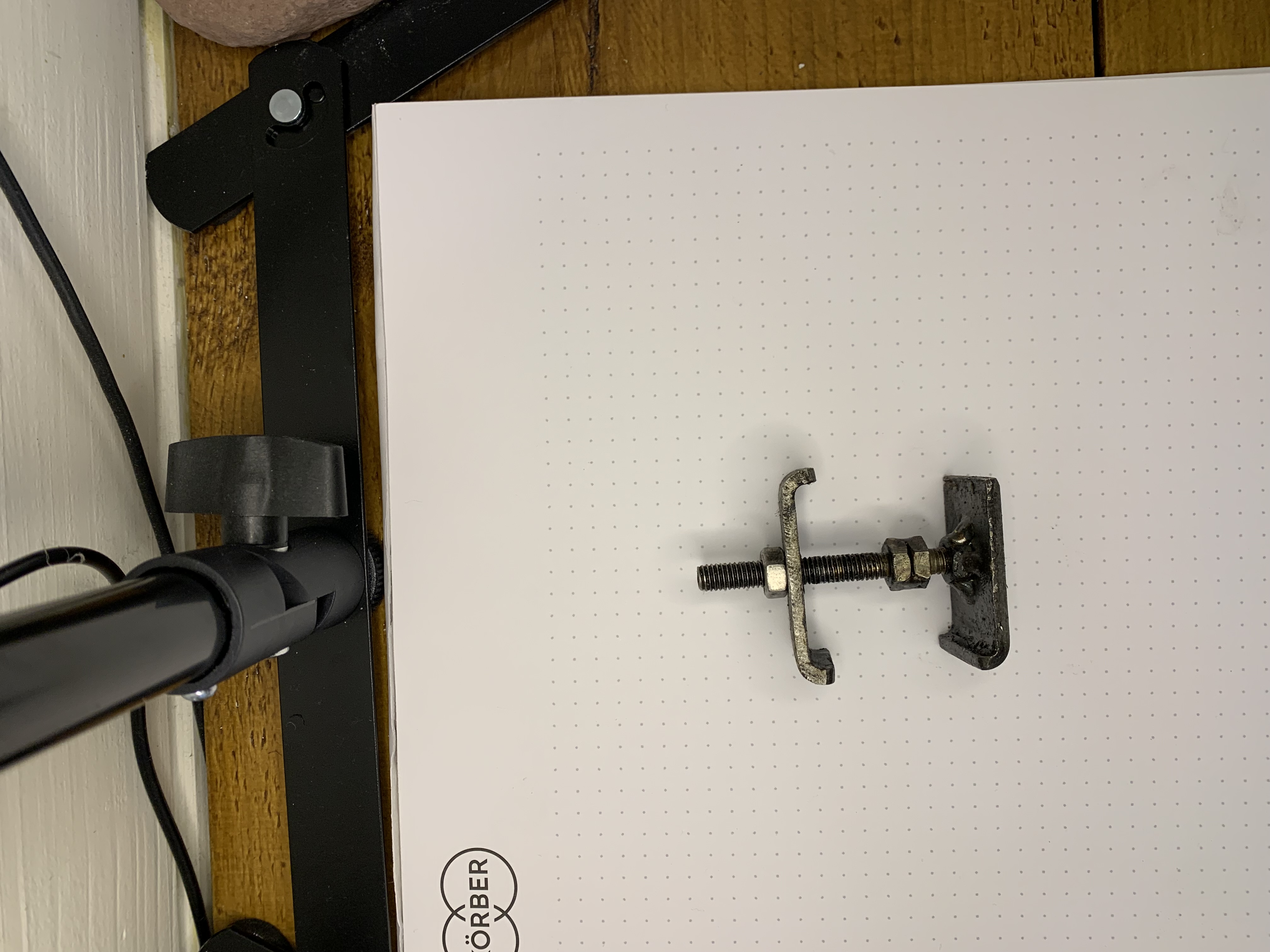

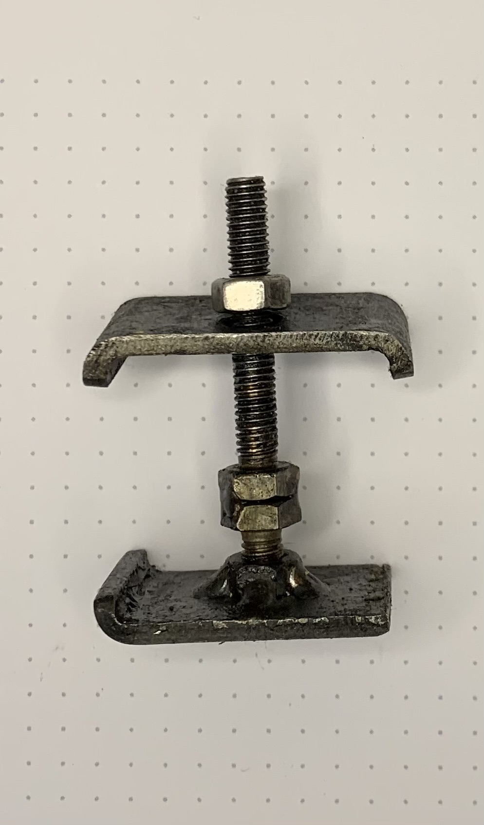

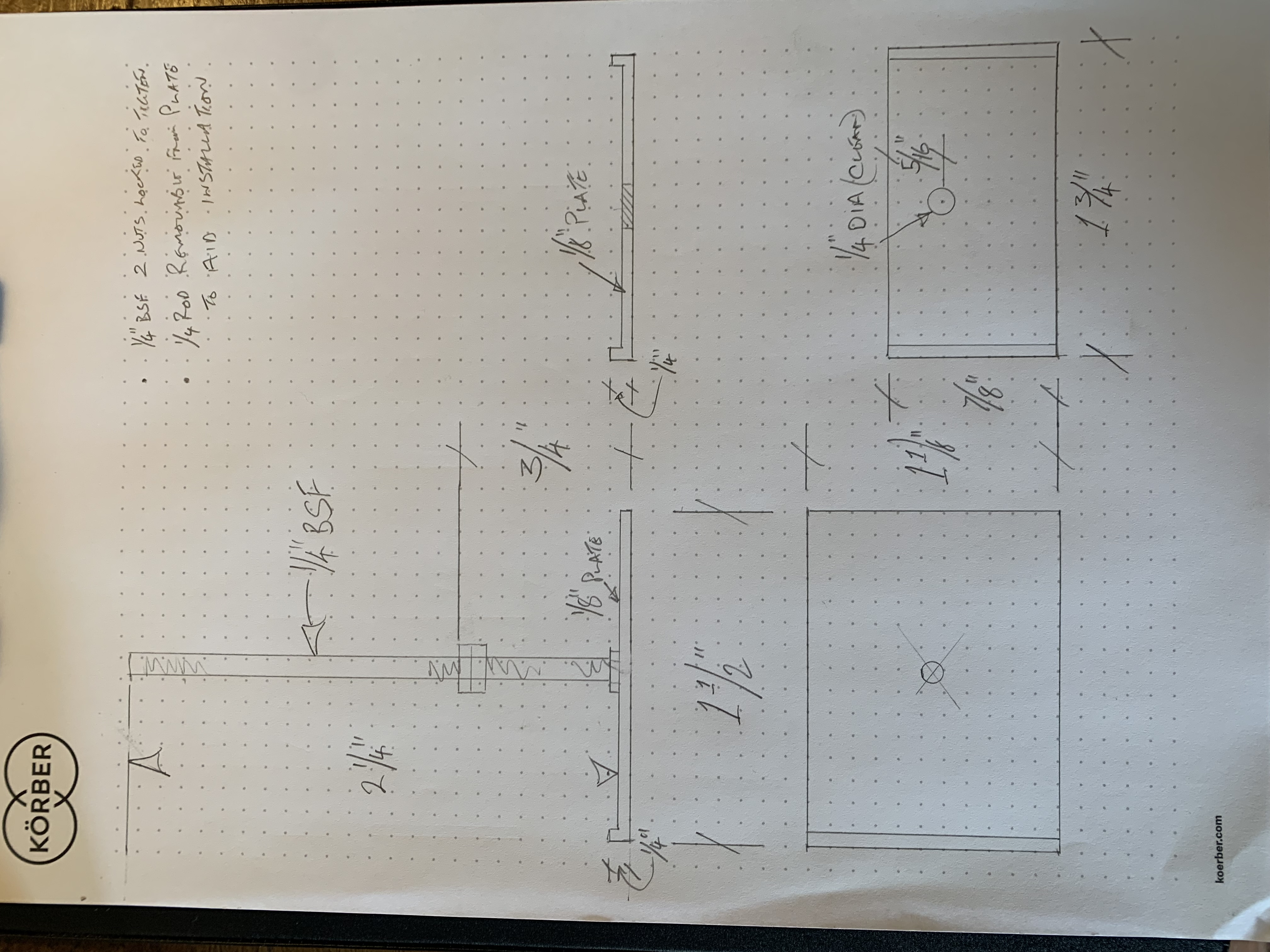

Simple adjustable
Inherited with a Manx. Ideal for setting the spacing accurately and slipping in.
Nice tool, thank you for the…
Nice tool, thank you for the drawings.

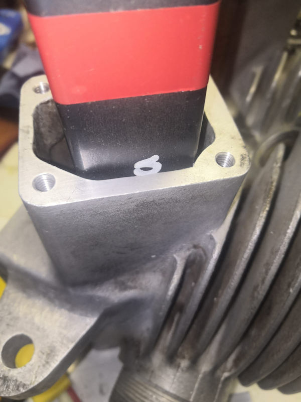

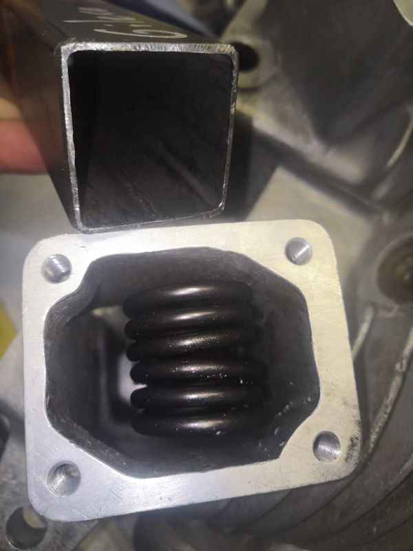

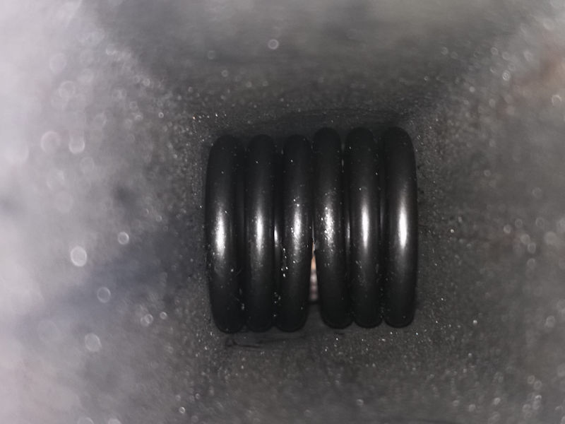

A friend just used a square tube to do the same job on his Saturno.
Fits like a glove and make the job real easier.
