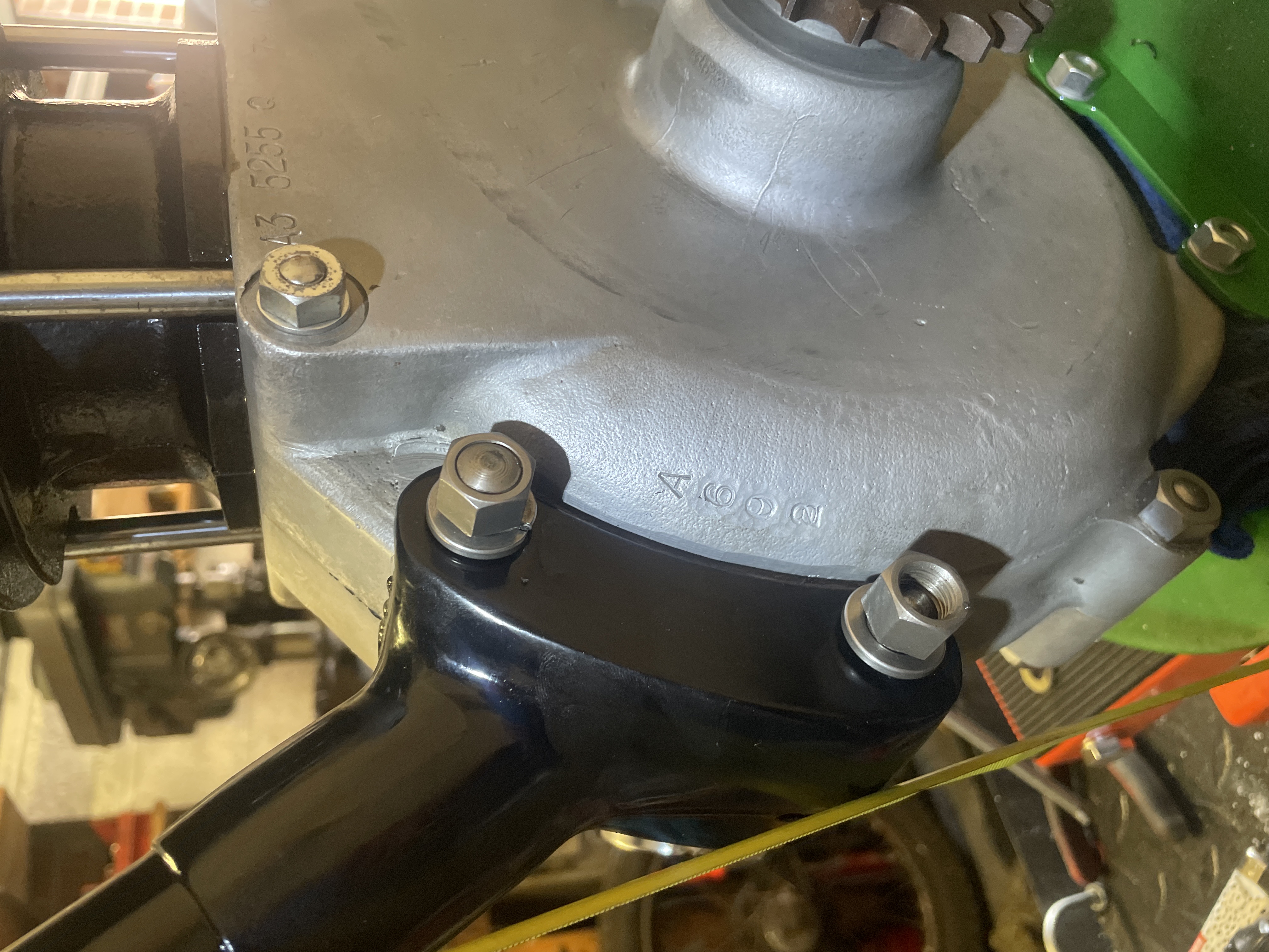

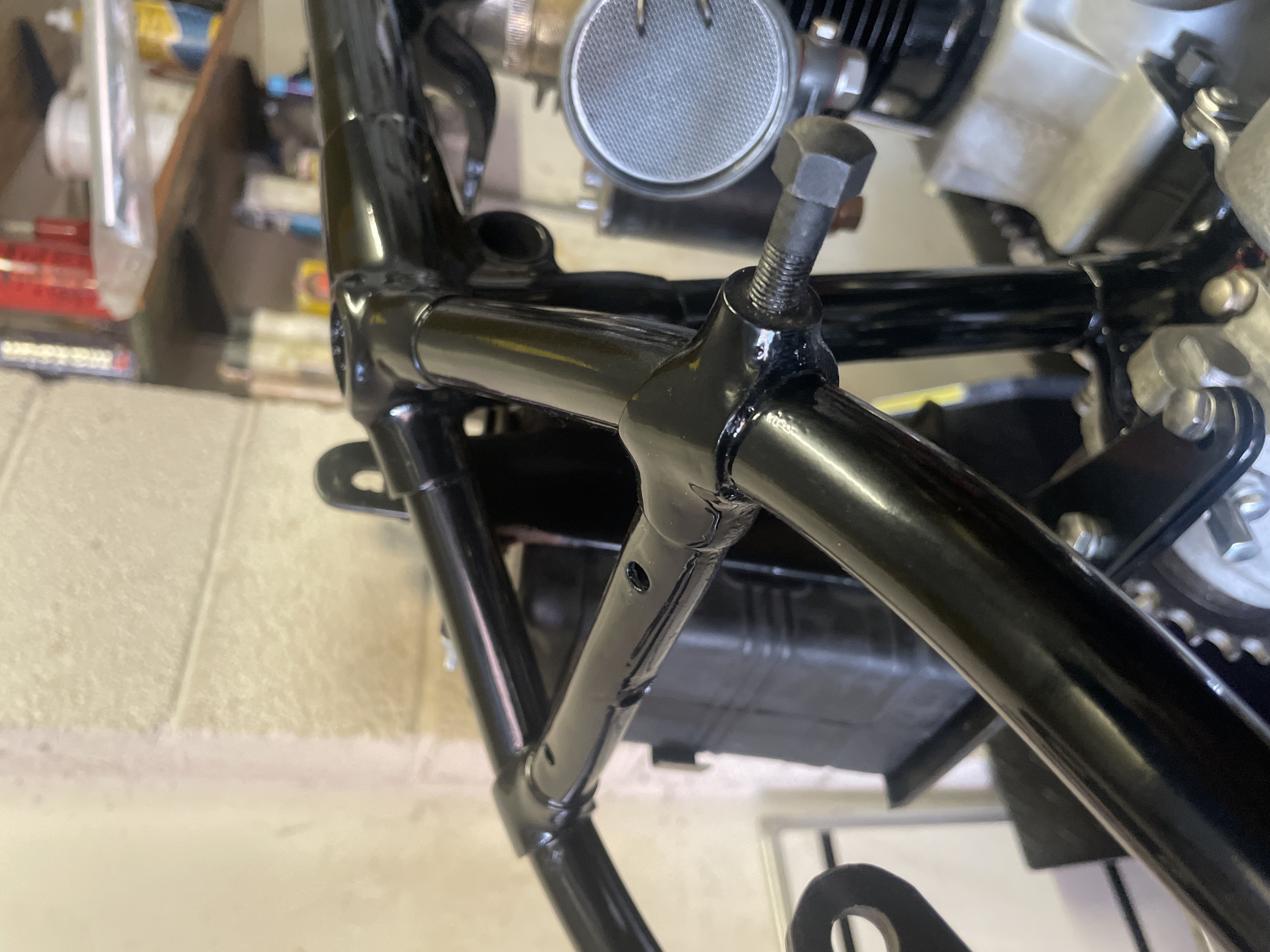

Starting to reassemble my 38 model 18 with a 47 engine.

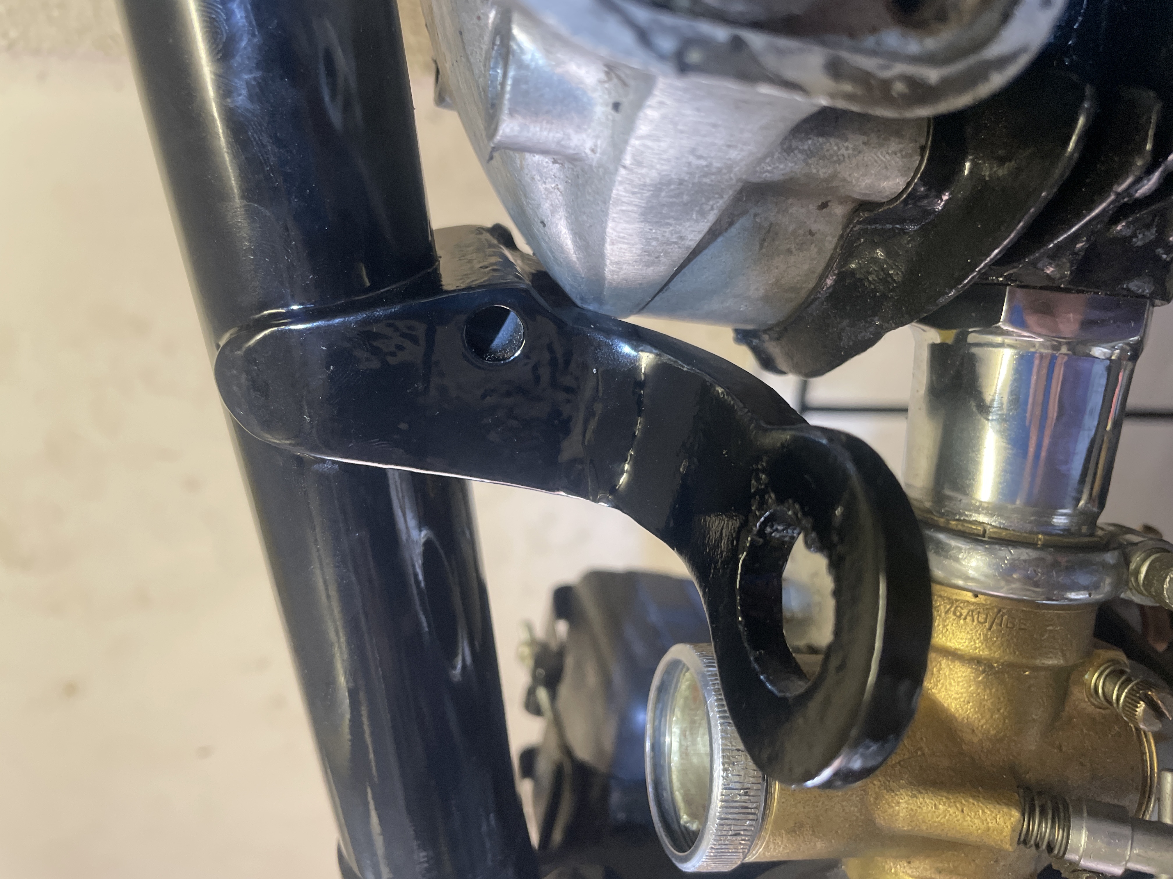

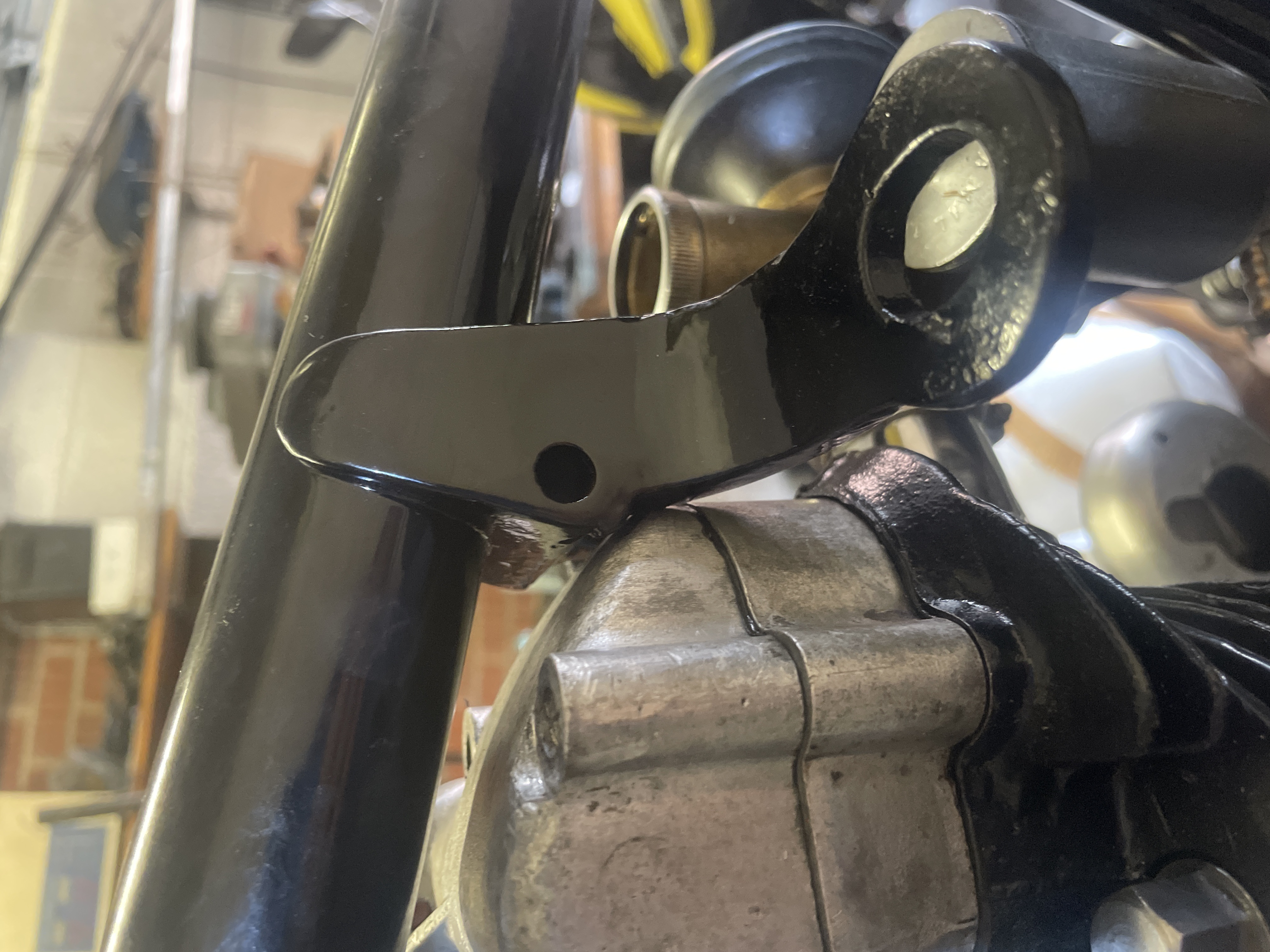

Looking at my nice model 18 completed there is a quarter an inch gap between the rear fuel tank mount and the top of the rocker box.
on my project bike there is absolutely no gap so I've had to drop the engine to get the rocker box off, which I did take off and put the engine back up onto the mount again. There is just no room the bolts are correct diameter and everything is fine at the bottom. It's just that there is no way to remove the rocker box if I did put it on as it is touching.
when I've got the project bike, it was all mounted apart from the rear engine plate plates which were hanging off so I'm wondering if it was mounted properly,
I've had the frame repaired and the gearbox mount tube re-tubed with the engine cases so it aligns correctly via Jake Robbins Engineering
What are your thoughts?
hopefully the pictures are clear enough
Model 18 frame ??
Frame

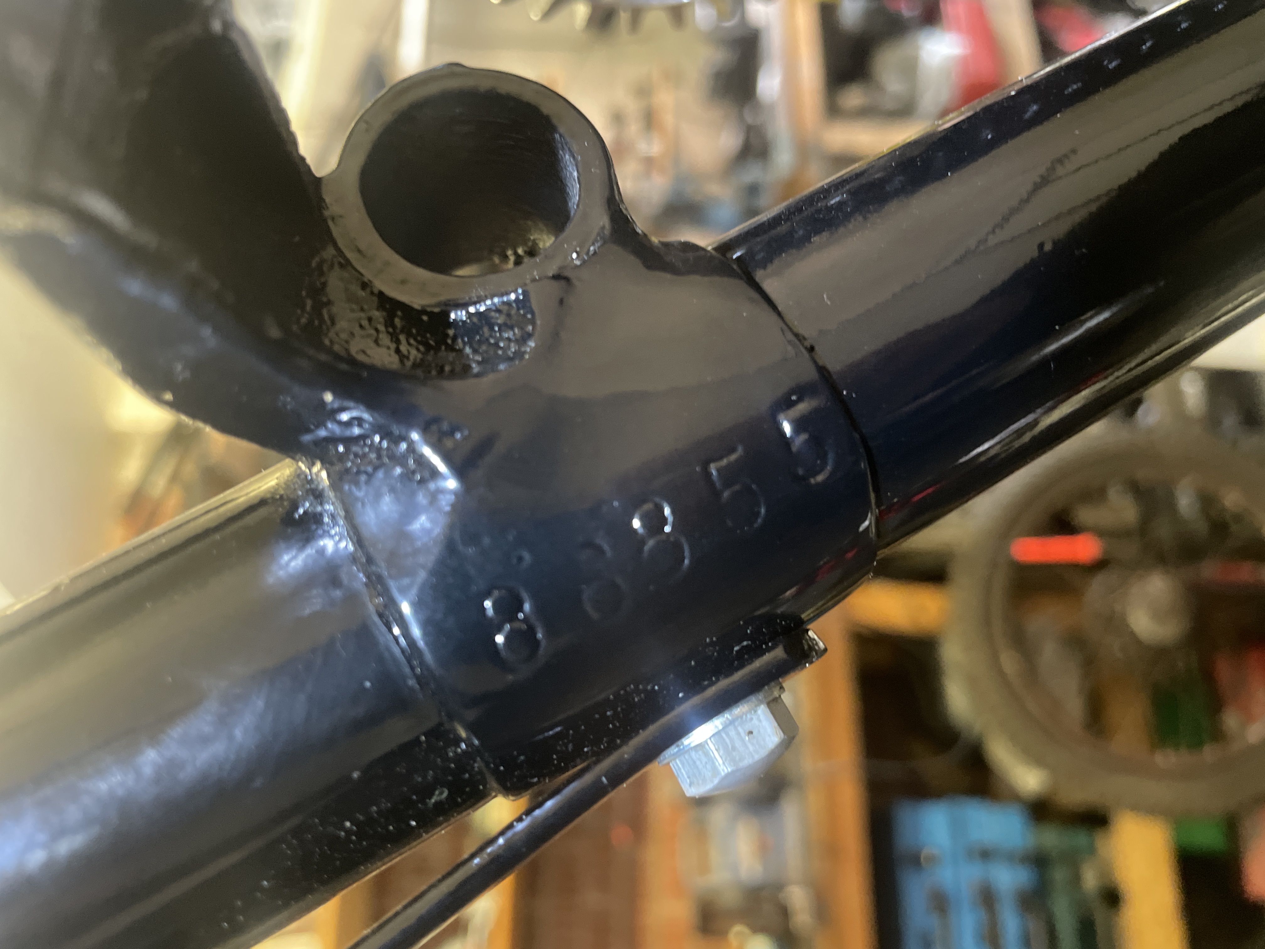

Hi Richard, thank you so much again the frame number is 86855 Which I believeThe frame number indicates a prewar frame from Dec 1937 to early January 1938.

Do the pictures, help a bit more
What are your thoughts, sir?

Dave Graham fitted a 1938 pattern Model 18 engine into a WD16H frame to replicate one of the small batch of WD18s produced in September 1939. I'm sure he mentioned that there were casting differences to the rocker boxes on the ostensibly similar post-war engines (which were all installed in full cradle frames) and the later rocker box would not fit in the WD chassis.
86855 falls between a couple of WD batches, but you have horizontal saddle spring mounts and the tall pillion footrest lugs (to clear the "Cow's Udder" silencers) so I'm sure you have a civilian frame.
Your engine plates with detachable footrest tubes are the WD type. I'd have expected some dimensional differences here to accommodate the WD main frame upright tubes being 1" shorter. If the frame has been tweaked to accept them then perhaps that might not be helping ?

As it is, the engine and Rocker box will not go in Even the very last Resort of filing down the fuel tank this is something I do not want to go down at all.
I would rather locate the correct components, what are your thoughts?

Richard Payne has the most knowledge and information of these models, but there are a couple of details that might be worth looking into. Norton could supply all models in the range to Trials specification from the early 1930s. Looking at your photos, the exhaust port looks too high compared to the front petrol tank lug when you look at other Model 18's of this period. If convenient you could compare the front down tube length with your restored model. Chris Streather should be able to check your frame number.

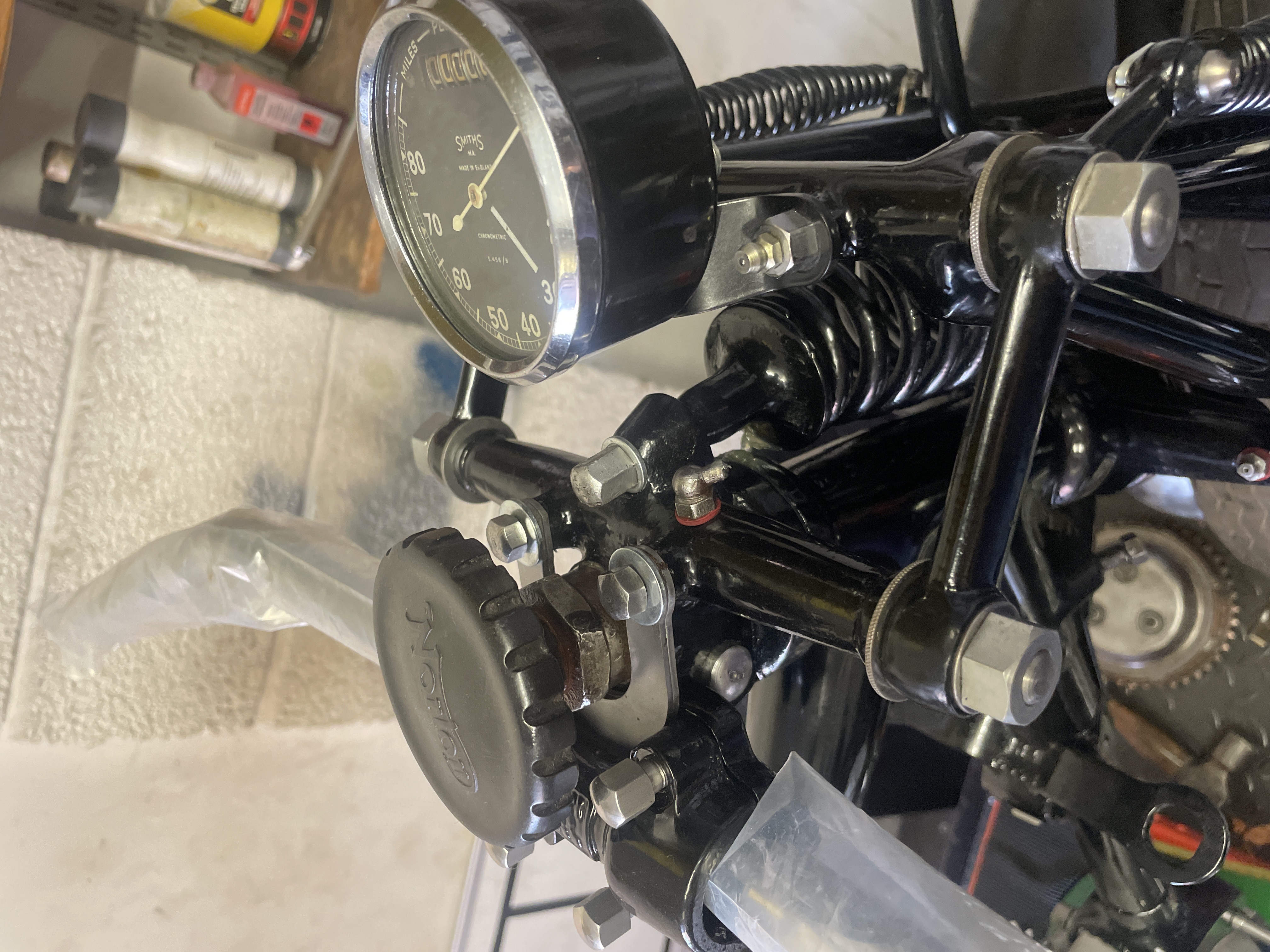

Yours has the hand wheel…
Yours has the hand wheel knob on the fork damper, not the hex nut used on later WD bikes. Is that significant?

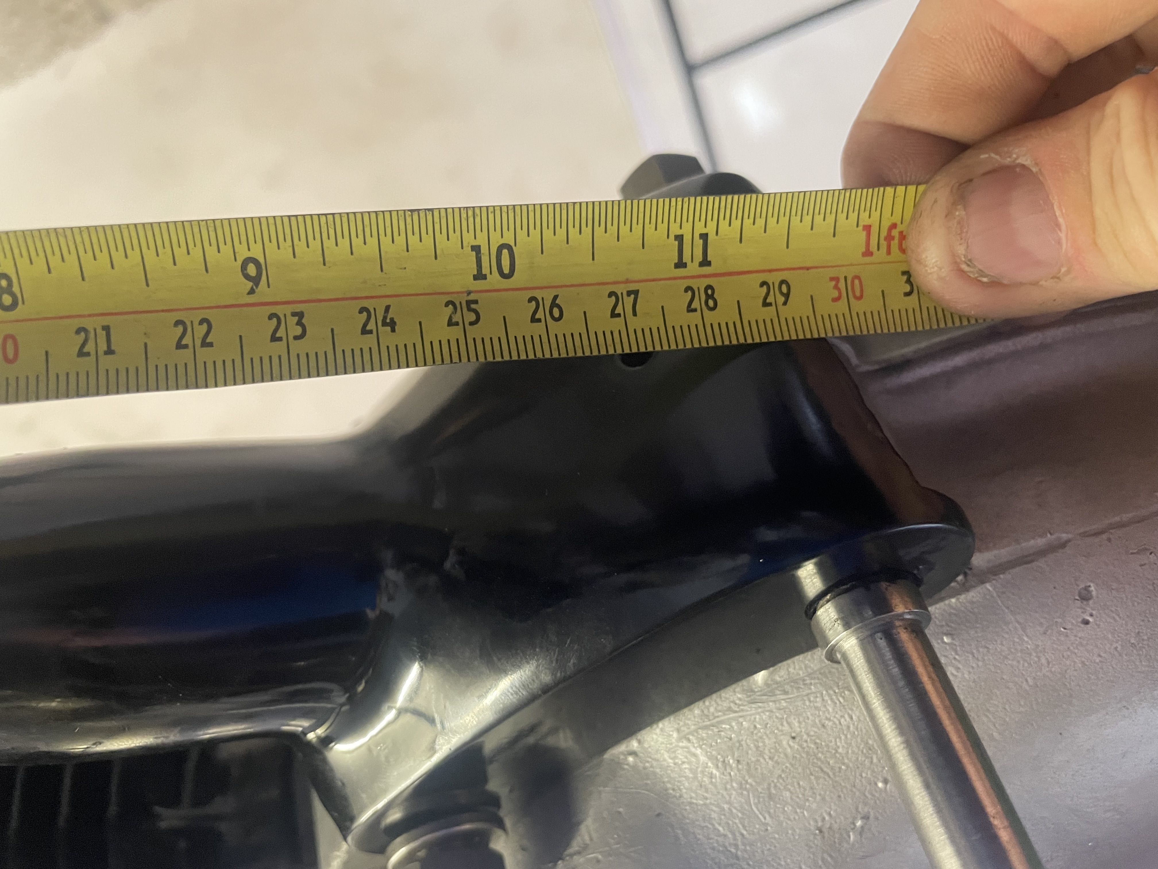

I've measured my nice Norton and it's 31 1/2 cm from the fuel tank mount lip ( tube inside) And the project one is 29 1/2 cm. .
I just don't know where to go from this Really yes, I'm sure I can make the engine fit, but something is majorly wrong either. It's a 16H or WD18 With a different rocker box.

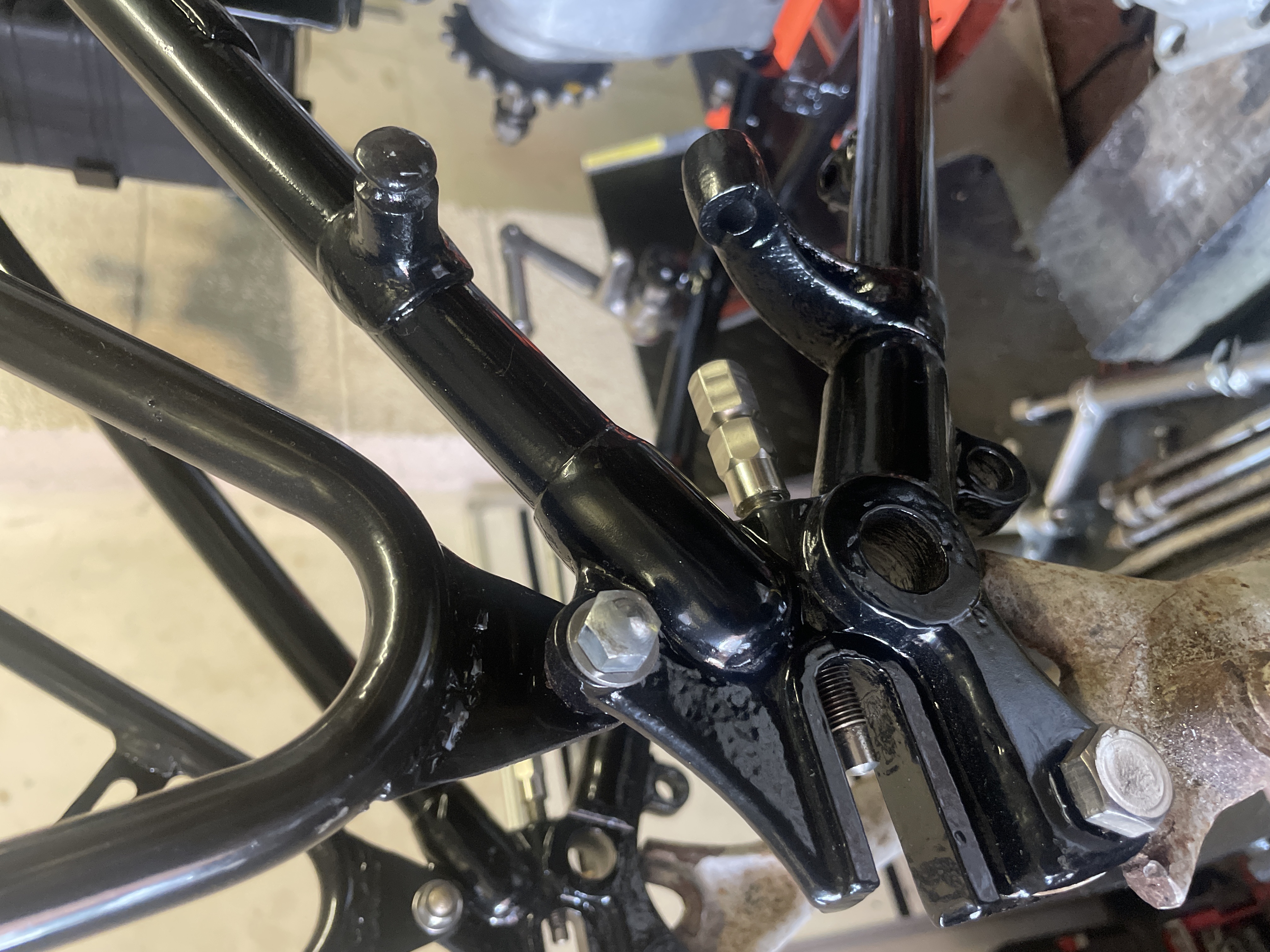

I've attach some more pictures for some clues if that helps
Frame

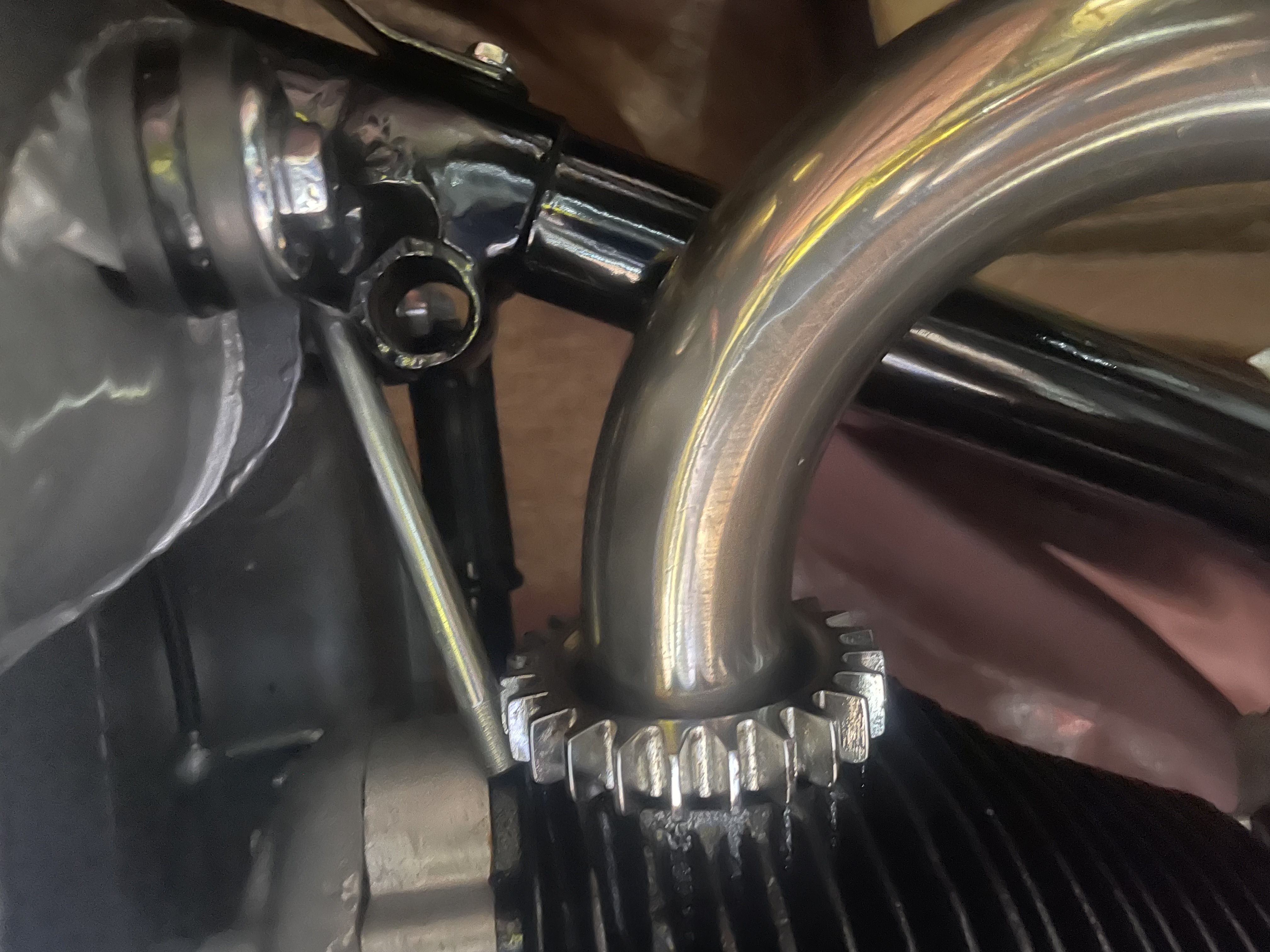

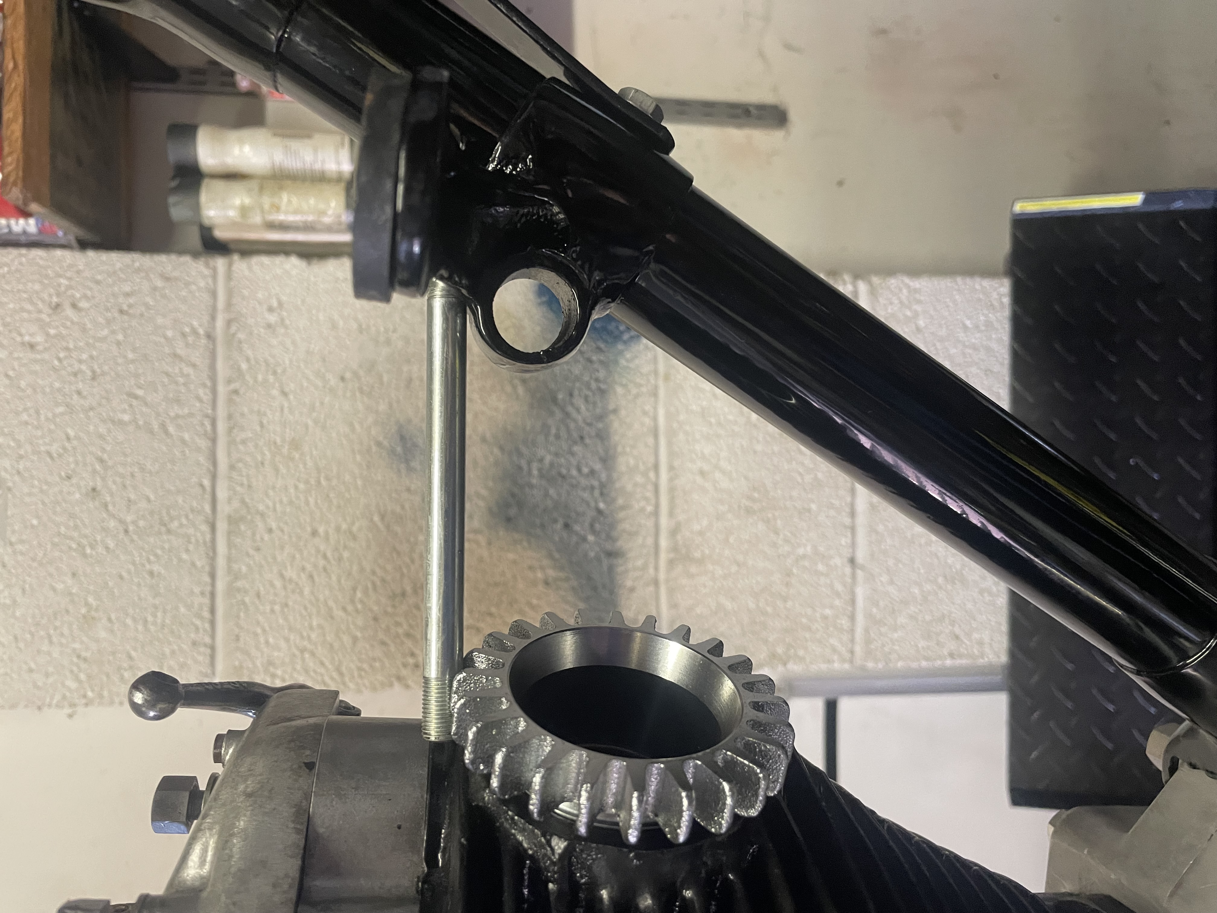

Hi Richard and team!
I just wanted to send a couple of pictures which really clarifies how far this is out.
I've rested a bolt on top of the exhaust to the side car mount and you can clearly see the difference the straight one being the project bike.
Secondary picture is my nice M 18.
This is clearly not right, It has to be a 16 H just by going on the pictures I believe.

Looking at the your first photo I think your frame might possibly be a WD16H, although not all the frame is visible to say for certain. There are at least 4 variations of the diamond pattern frame and these vary by the height of the front down as a quick reference. This is measured from the bottom of the head-stock casting to the top of the engine mounting lug. The first thing will be to check the frame number with the factory records to get a confirmation of what model it actually is.
