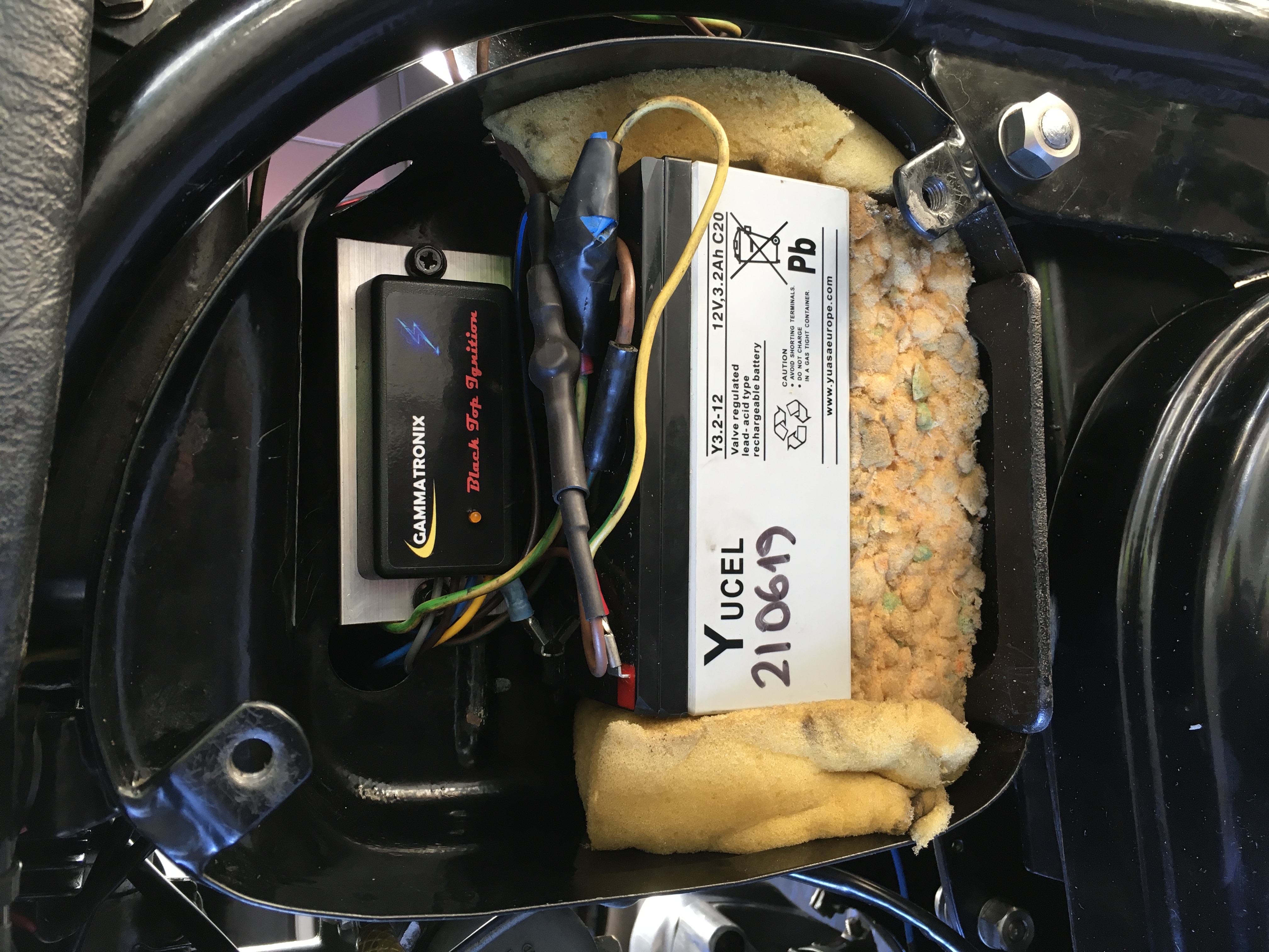

I have just fitted a Gammatronix 12V positive earth “black box” to my 1960 ES2 on the advice of an AJS owning neighbour who has had one for some 12 months now. I was unable to find an original Lucas replacement condenser and was intermittently troubled by ignition problems as a result. One hundred miles after the installation my difficulties appear to have evaporated. It is important that decent points are installed at the time of conversion and that the old condenser is removed.

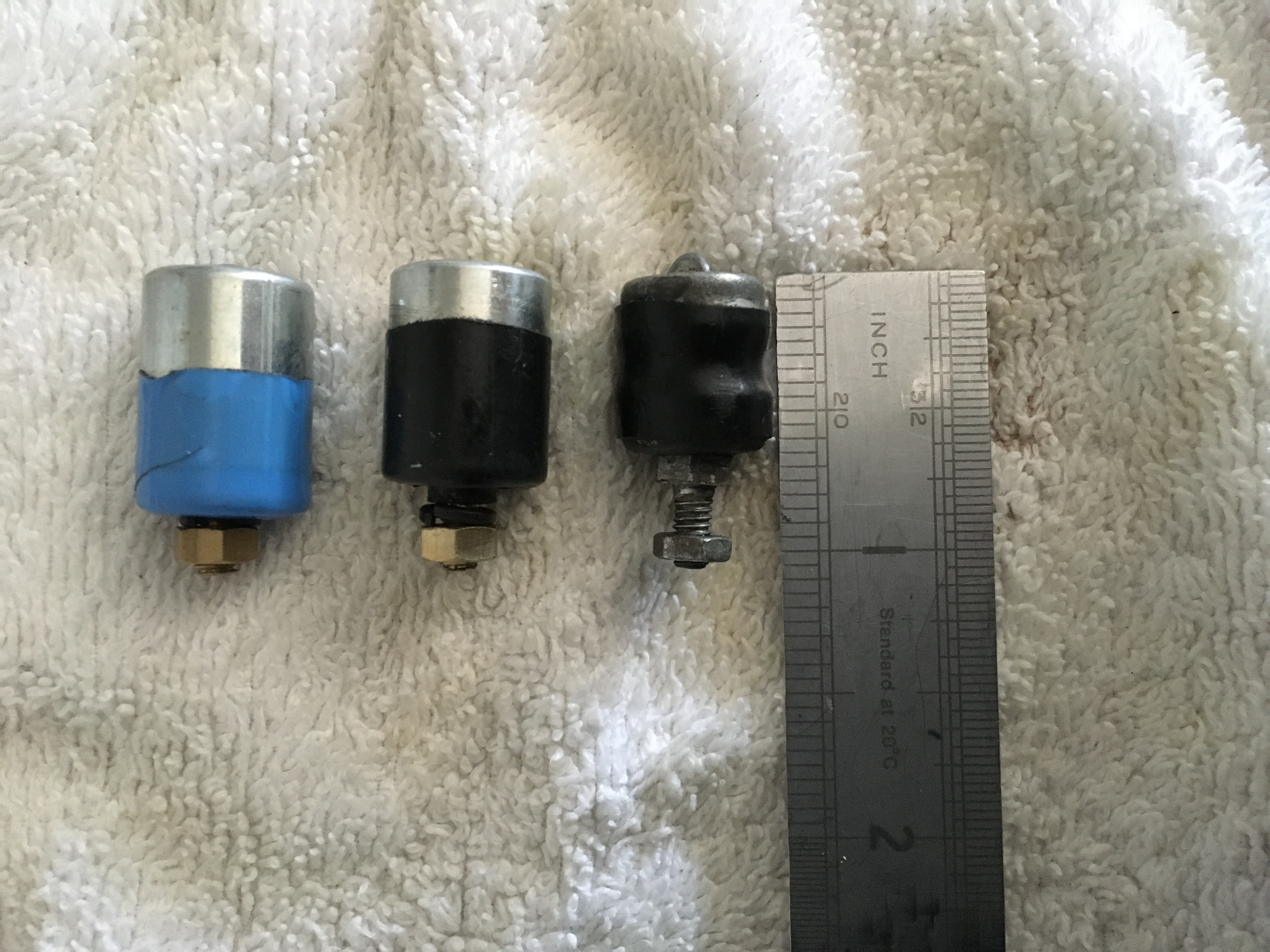

I too have dealt with Distributor Doctor and found them very helpful. In fact I ordered my replacement points from them. However with regard to condensers, on my particular machine, Lucas part number 41278, they have proved to be almost impossible to find (see attached photo), because of its particular length. The standard replacement is part number 54410823 (in middle of photo) which is difficult/impossible to fix under the copper bracket.
Hence my conversion to Gammatronix.
