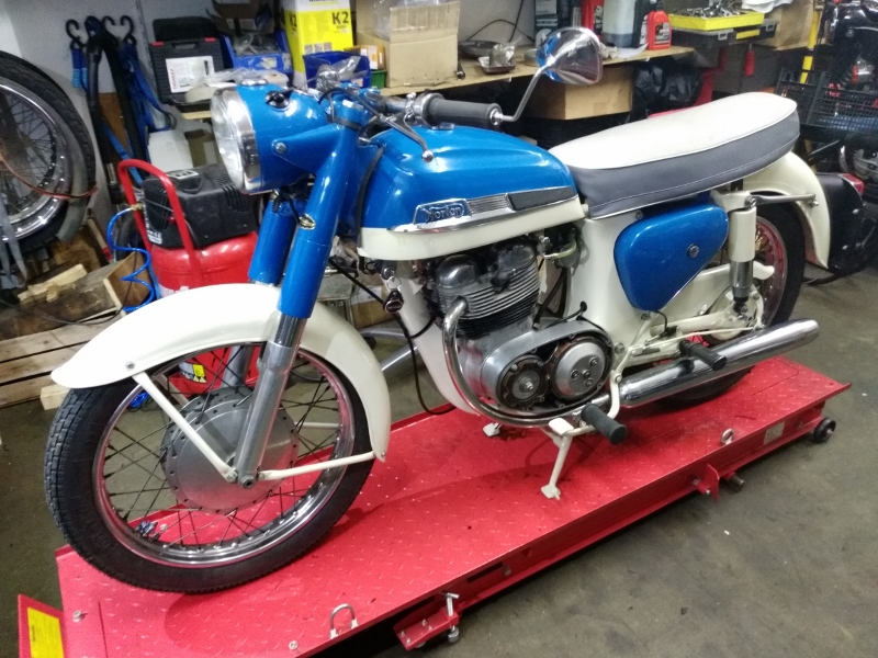

So after curing the oil loss with a new composite head gasket and some high temperature sealant the first longer ride on my Navigator was half a success! I made it to the British Bike Meeting in Salem, some 25km away from my home but not back. The engine seized and the Navigator was loaded up to the Chariot of Shame.

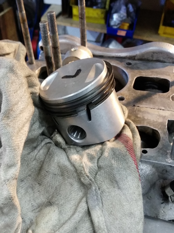

This is the result:

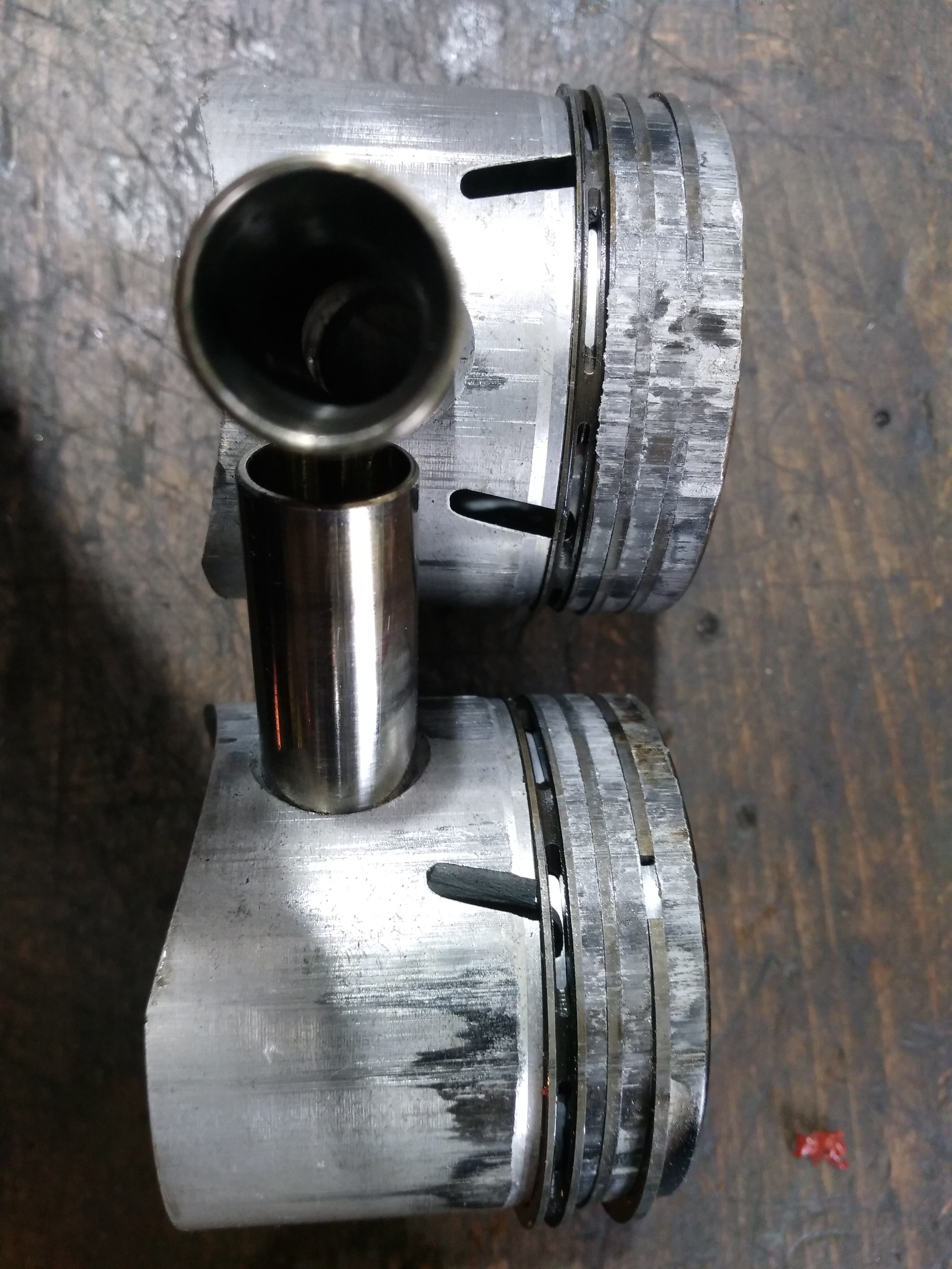

Bad marks on the pistons and some scoring in the cylinders.
Will take it to the engine shop who bored the cylinders so we can discuss how to solve the problem.

Ulrich, what a shame. I hope you can get it sorted.
Looks like the pistons 'picked up' in the cylinders
Was it a tight fit getting the pistons in the bore?
Did anyone check the ring gap with the piston in the cylinder before assembling the cylinder to the crankcase.
Did you lubricate the pistons and cylinders generously on assembly.
Is the oil pump working well, for example did you see oil returning to the oil tank at a good flow rate.
Did you run in the engine gently before you first run?
Sorry if I am stating the obvious.
Dennis

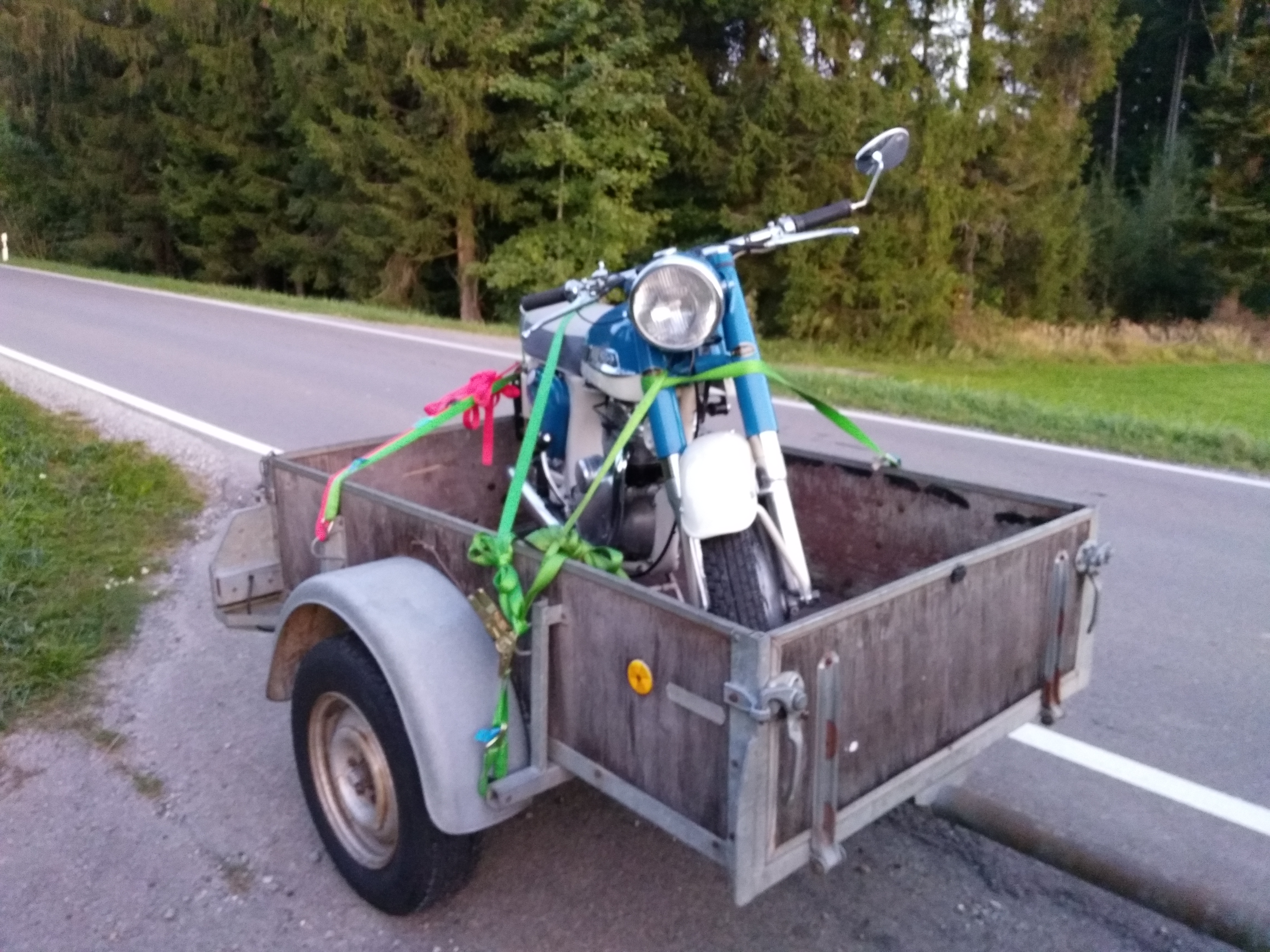

After we hauled the bike back to my workshop and checking the engine I found out the left intake
rocker had way too much clearance because I did not tighten the spindle clamping nut enough so the
rocker came loose.
Hope I can save the pistons. The cylinders need some honing.

Although it looks bad, the…
Although it looks bad, the main damage would appear to be in the ring lands which should have more clearance than the skirt . If new rings can be made to work its just possible that you could save the pistons after a good clean up. I would be looking at clearances ,timing, and carburation. Its also possible that the pistons were not made correctly.
Hi Uli That's bad news…
Hi Uli
That's bad news indeed, they look like heptolite pistons, while its unlikely with new ones they did suffer from cracking usually from the gudgeon pin up to the rings, this allowed the piston to expand more and seize, I have one in my hand that did just that in 1977!
Hopefully you can clean them up satisfactorily but it does look like like the piston clearance was too tight or they were running very hot. I doubt a wide valve clearance would could that problem.
Fingers crossed.
Dan

The pistons are NOS Hepolites in +010 from NOC spares. They have one pair left if these are no good any more.I supplied them with the cylinder to the machine shop. They are specialized in engine boring etc.They do good work usually.
The engine seized at an uphill road after a longer ride on a "autobahn" with continuous speed at about 80 kph ( speedo is not working). Thats kilometres per hour not miles!

When similar happened to my…
When similar happened to my Dommie many years ago, it was due to one carb needle being lower than the other - and one overheated on a long hill climb.
That led me to a rebore etc etc. The reason for the rebore was the state of the cylinder walls.
But in retrospect, I think most of what looked like severe damage was in fact aluminium from the piston, and I suspect it could have been removed using caustic soda with no loss to the bore size. I think I could have got away with new pistons, and saved myself a lot of trouble and time. Maybe others have similar tales to tell?
Pistons are shot
Herbert had a look at my pistons: they are not reusable in his opinion.

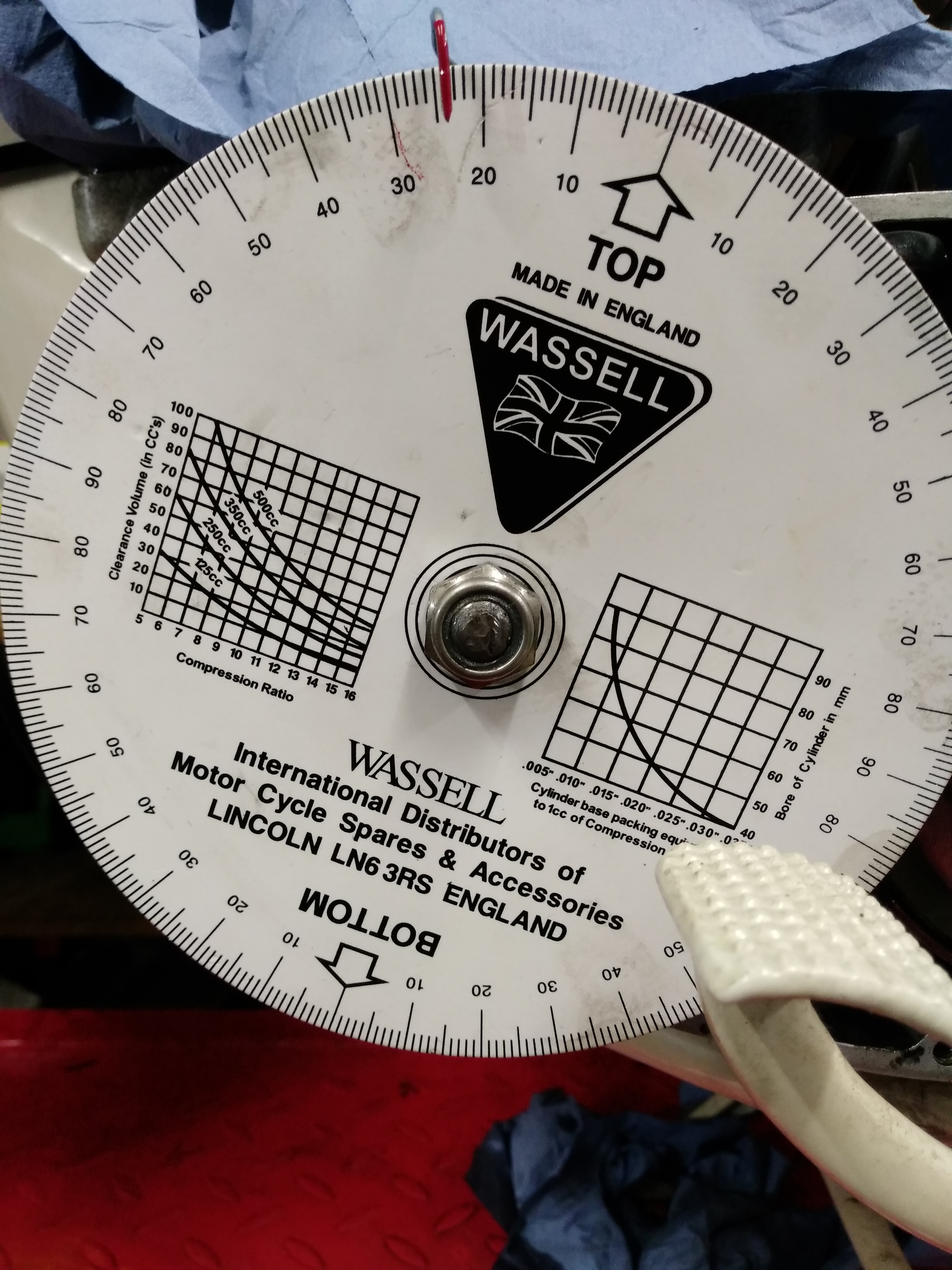

I have a Boyer ignition. The bike is converted ro 12 volts. Will check the ignition timing. I made a mark on the alternator rotor at TDC and adjusted the ignition rotor accordingly, but just read in the Boyer instruction sheet:
Set engine to the full advance timing mark on compression.
What is correct now?

Ignition timing
Just to get it right: Lookin on the left side of the engine it turns anticlockwiese when running. Right?
So I turn it clockwise from TDC to 24 degrees. Right?
Then adjust the Boyer rotor an trigger plate. Right?
I don't have the Boyer…
I don't have the Boyer system so the detail may difer Uli but yes the engine rotates anti clockwise as you look at it so once you have established TDC accurately set up a marker the way you have and then turn the engine back clockwise to the fully advanced position of 24 degrees (beware, you have the pointer at 30 deg in your photo which is for Electra timing!). Then follow the Boyer instruction manual to set up the rotor to time the engine statically. Once you have done that connect up your timing strobe, start the engine and point the strobe at your timing marker and increase the engine revs and you will see the ignition start advancing. Slowly increase the revs until the electronic ignition gets to fully advanced and make a note of how many degrees that is. Stop the engine and adjust the base plate accordingly, start the engine again, repeat the procedure until you have got the timing spot on. With my Pazon system the static timing is generally within 1 or 2 degrees so it only takes a very small adjustment to fine tune it. I have found that transforms the way the engine performs but do take care - with the engine running keep well clear of the primary drive and clutch. Good luck!

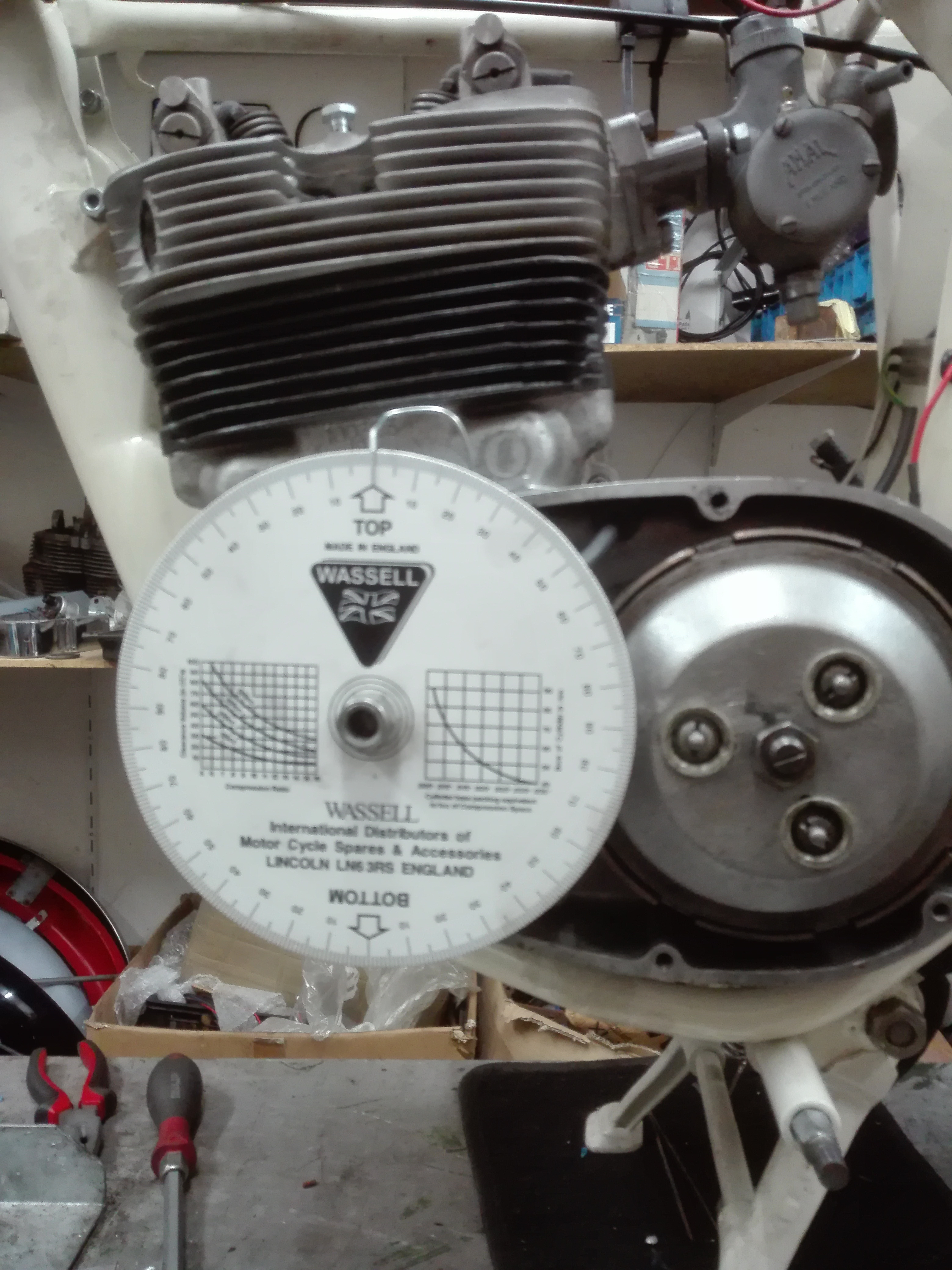

These are the pics of the…
These are the pics of the first adjustment of the timing. Don´t know why I timed it at TDC.
That’s right Uli, it’s…
That’s right Uli, it’s important to set the timing with a strobe. Note to self, must check mine!

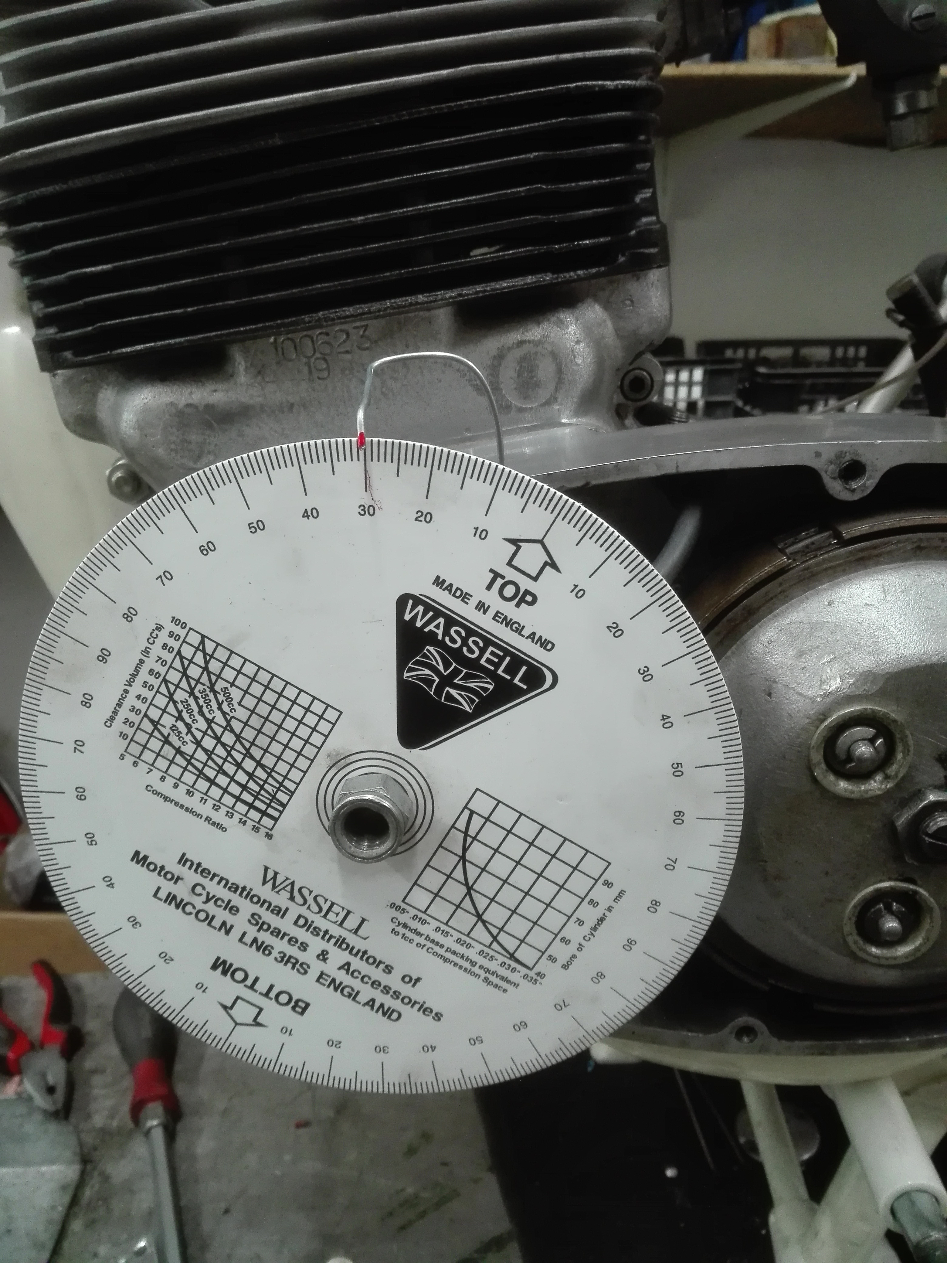

Ok, this is the actual pic…
Ok, this is the actual pic of the ignition timing setup.
I have to check it when the engine is assembled . The cylinder is not honed yet.
I will make some marks on the rotor and stator. It is not possible to use that big timing disc on
a running engine because it interferes with the cables coming from the stator.
Before TDC?
Uli,
I think I am correct in saying that the timing should be 24 degrees BEFORE TDC.
If the timing disc you show is in the correct position it looks to be AFTER TDC.
I am happy to be corrected if I am wrong.
With the Pazon you just set the 24 degree setting and the electronics take care of the rest. Not sure if that is the same with the Boyer.
Dennis

Correct Uli and your latest…
Correct Uli and your latest picture is spot on! As a suggestion so I could use the big (and therefore more easy to be accurate) timing disc I put several large washers behind it on the alternator retaining stud on the end of the crank shaft so it was clear of rotor and wiring. Good luck with getting the barrels honed, the rebuild and careful running in! Nick

When you look at he pics of the damaged pistons the damage is at the top around the rings because they got too hot due to the faulty ignition timing. There is no damage at the skirts, so the clearance should be ok.

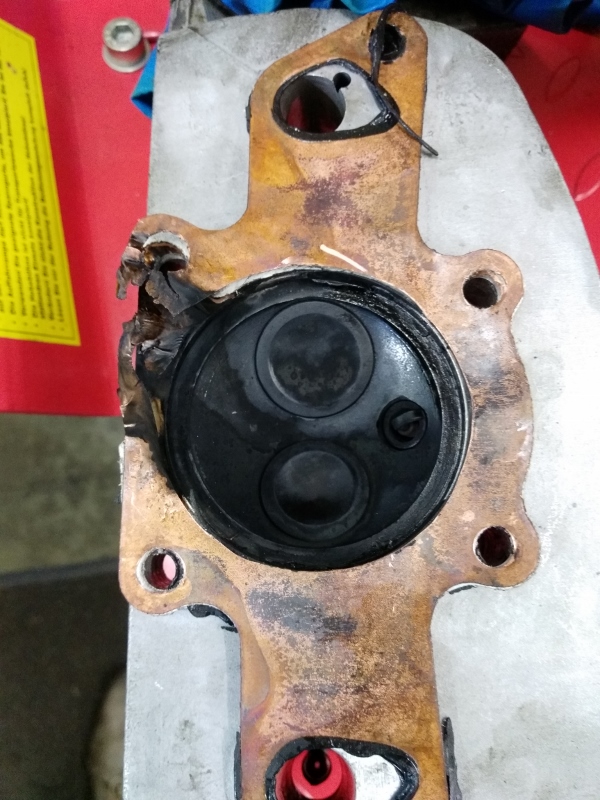

Everything is back together-almost
This is how a blown head gasket looks when you THINK you torqued down ALL the head bolts yesterday and you did not check them before letting the motor run.
Some were only handtight obviously...
Well after that minor incident I ordered a gasket set for the Navvi from NOC spares and some alternator bolts with nuts and washers because one thread was damaged and could not be tightened.
Now everything is back together, engine idles steadily, ignition is spot on ( 24 degress BTDC!!!) I checked it with a strobe light.
You see the missing primary drive cover- one of the bottom screw threads is gone, I am in need of some helicoil inserts, hopefully will get one next weekend.

I share the agony having followed your thorough rebuild. I hope the engine shop might admit they left the fit of pistons in the bore too close. Better still if they can correct things at no cost to you.
You might consider a light cleaning of the pistons with a very fine file. Just to take off the high bits. Clean the ring grooves so the rings are free again. Hone out the bores and then run in with care.
