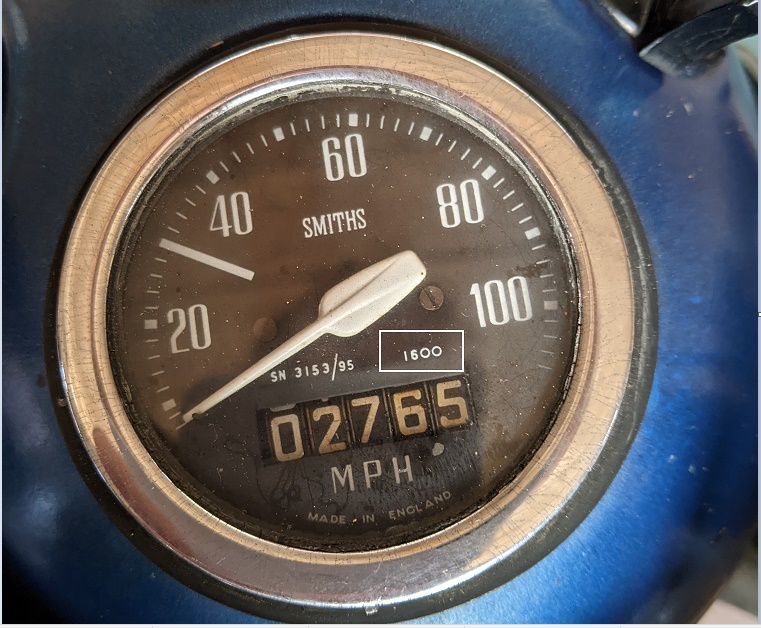

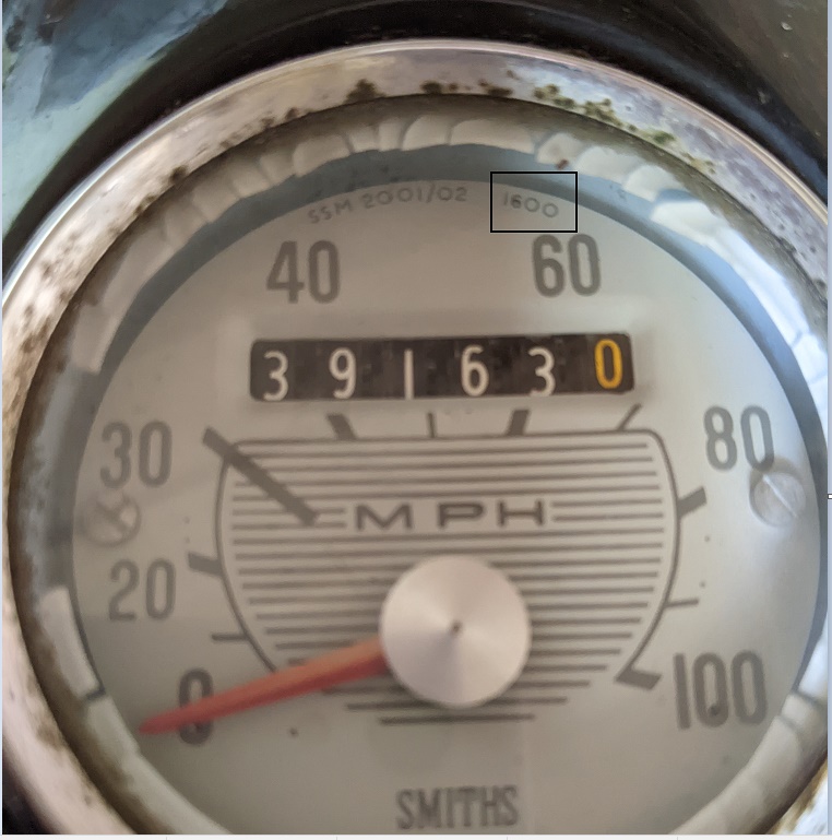

A 2:1 speedo gearbox will rotate FASTER than a 19:10 gearbox, by approx 5%.
Dommi & Commando with 19" rear wheels use a 2/1 drive.
A Navi was fitted with an 18" wheel, which means it will turn more times in a mile than does a larger wheel, so the Speedo Drive was reduced to 19/10 to slow the speedo cable down.
Hence, I repeat, the 2/1 drive, if fitted to a Navi (or any 18" wheel) will read approx 5% fast on the original speedo - if in good working order. The original speedo should show "1600" on the dial - indicating 1600 turns to a mile. Other ratios are available. Two examples shown:
PS - the blackface one is my Navi, and the White face one is on my Electra. On the Navi - the leading "1" is missing, as it now actually reads 102,765 miles.
(Its currently resting, as my clutch 'clicks' when I pull in the cable & locks. Embarrassing at T-Juctions or traffic lights.....)
