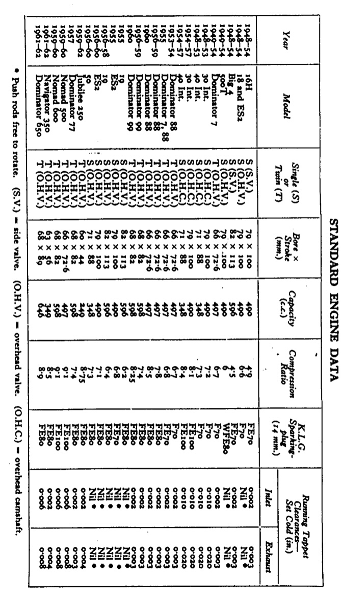

What should the psi compression be on these engines.
John
According to the engine data sheet I have, attached it’s a compression ratio of 8.75:1 which works out to be about 128psi.
once I get a chance to assemble the timing gears properly and then check my compression I’ll update the thread with the results!

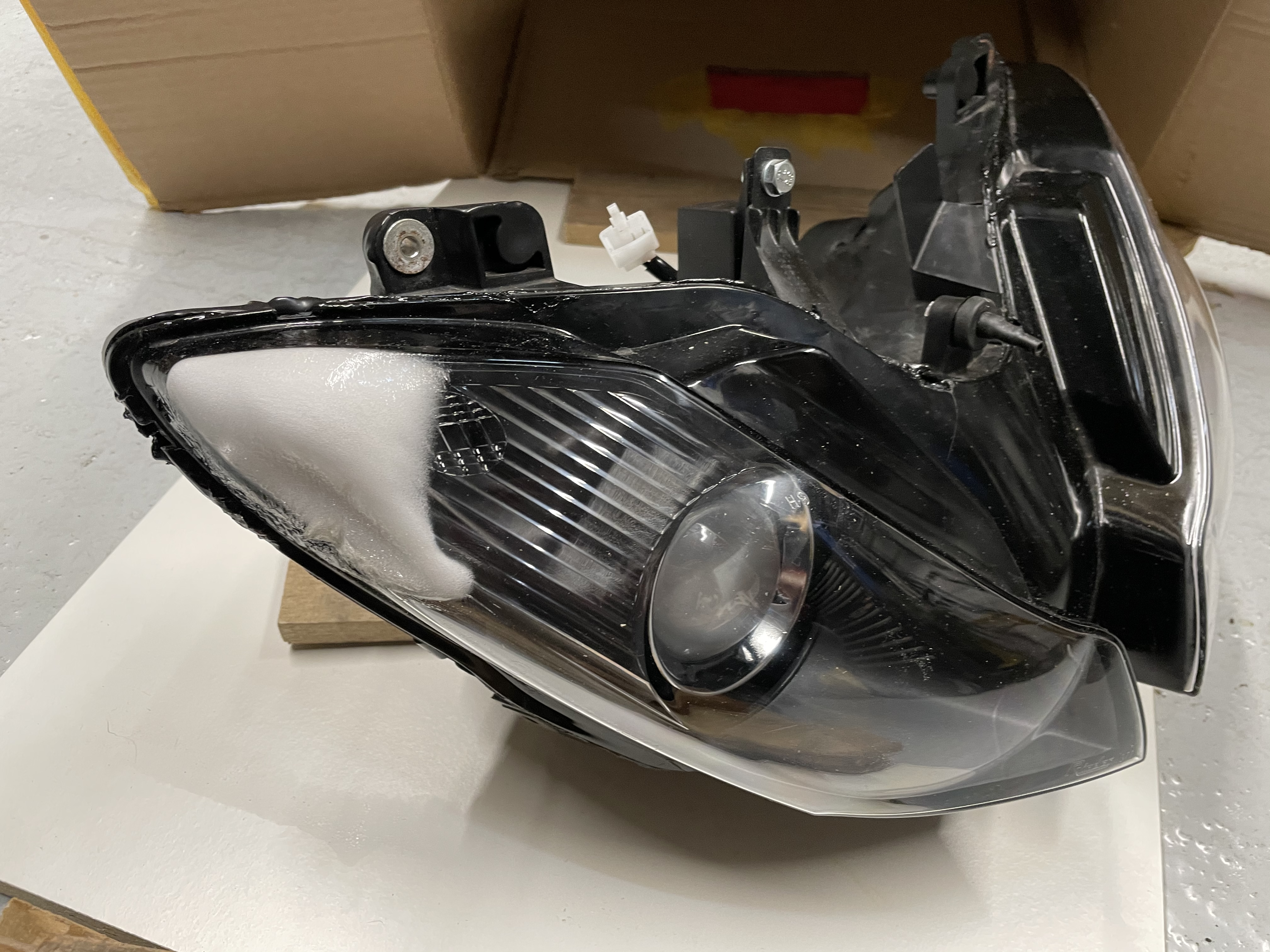

now to prep the frame & forks for painting & rebuild....plus the fact that my priority is to replace the headlight on my main ride - melted it with the heat gun trying to split it to upgrade the projectors (2011 Triumph Tiger)
whoops!
