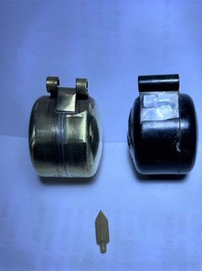

Hopefully, you can see that the flat surface on the brass float is much narrower than that on the plastic one. Also, if you look carefully, you can see a 'witness' mark on the brass float where the needle has contacted with the float; at least until now!
AMAL Monobloc brass and plastic floats
Dennis
